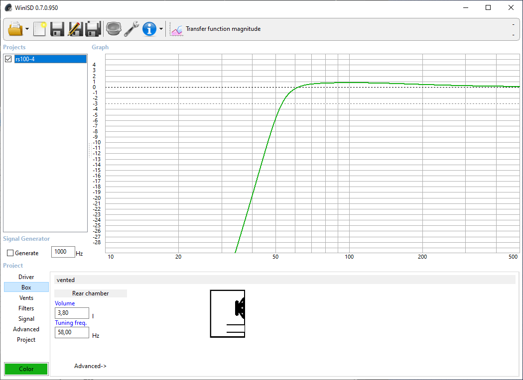

I've expanded this project quite a bit. I moved from a two way TCP115-4 to a one-way design using the Dayton RS100-4. It will be in a 3.8L box tuned to 58Hz. I will put a small amplifier with DSP in it (the WONDOM JAB 3-50), which will allow me to make an assisted bass reflex enclosure and I will also use it as a way to apply corrections to the frequency response, mainly to counteract baffle step and the slight loss in sensitivity in the last octave.
This is using a 60Hz HP filter with a Q of 1.1
