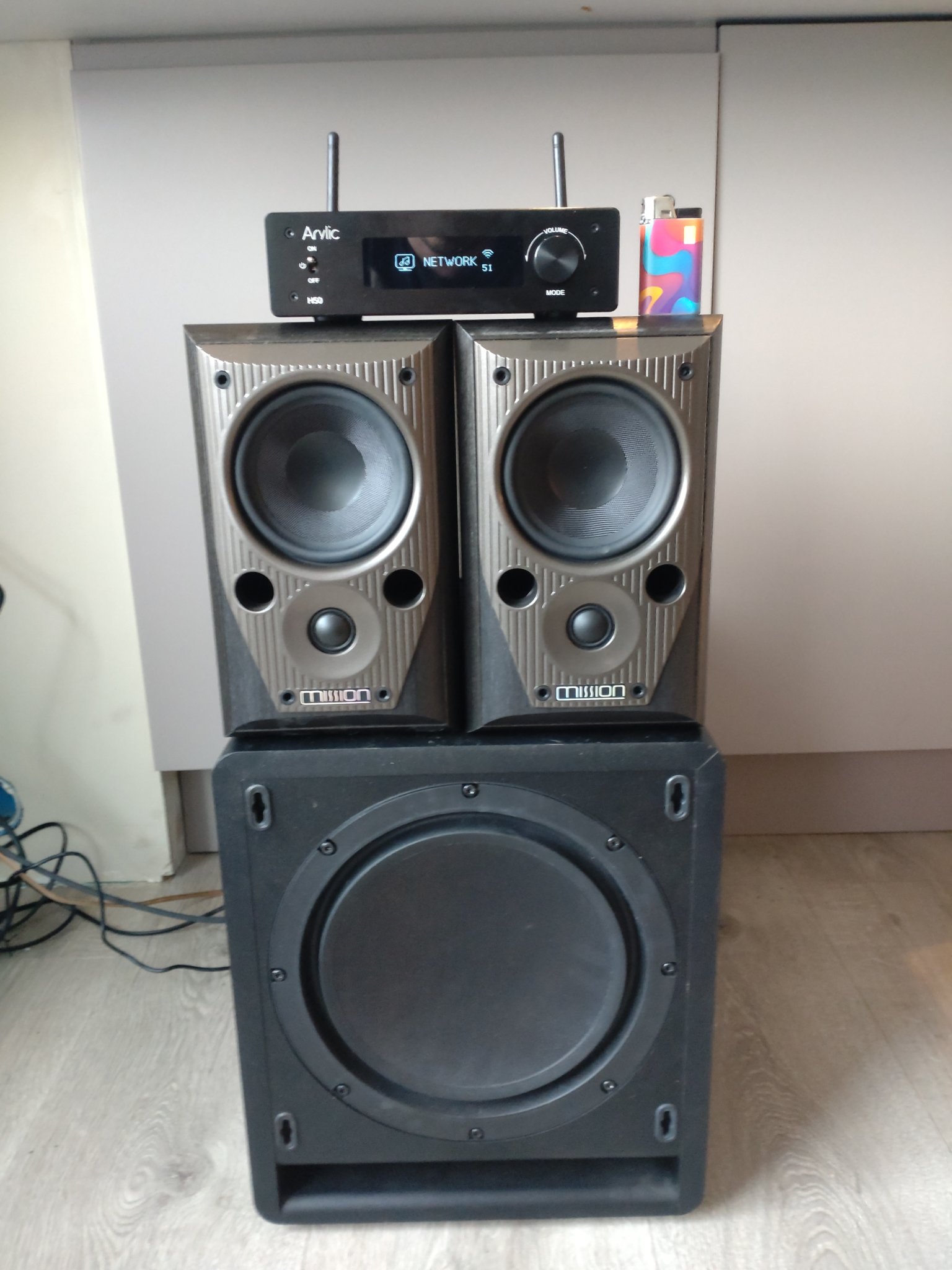

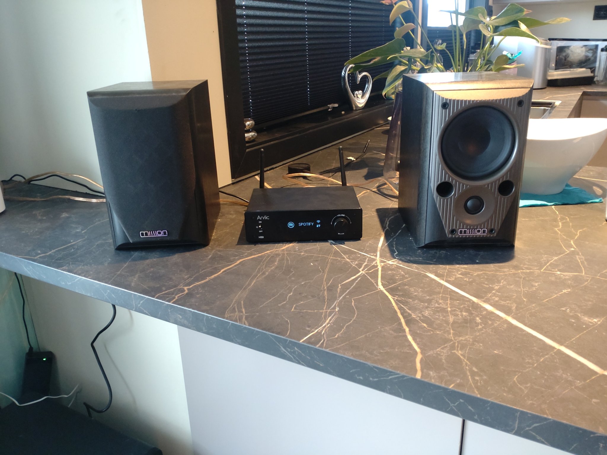

The H50 (32V) has been in the house for almost 4 weeks, needs to be tested a bit before one can draw a conclusion.
have tried various speakers and subwoofers.
everything from 10" speakers and up to 15" sub.
but..... I landed on a setup, as the amplifier is sold as a "bookshelf"
Some old classics Mission M70.
Klipsch SW-110.
And the combo played out of the office (the office was too small), and into the kitchen/living room.

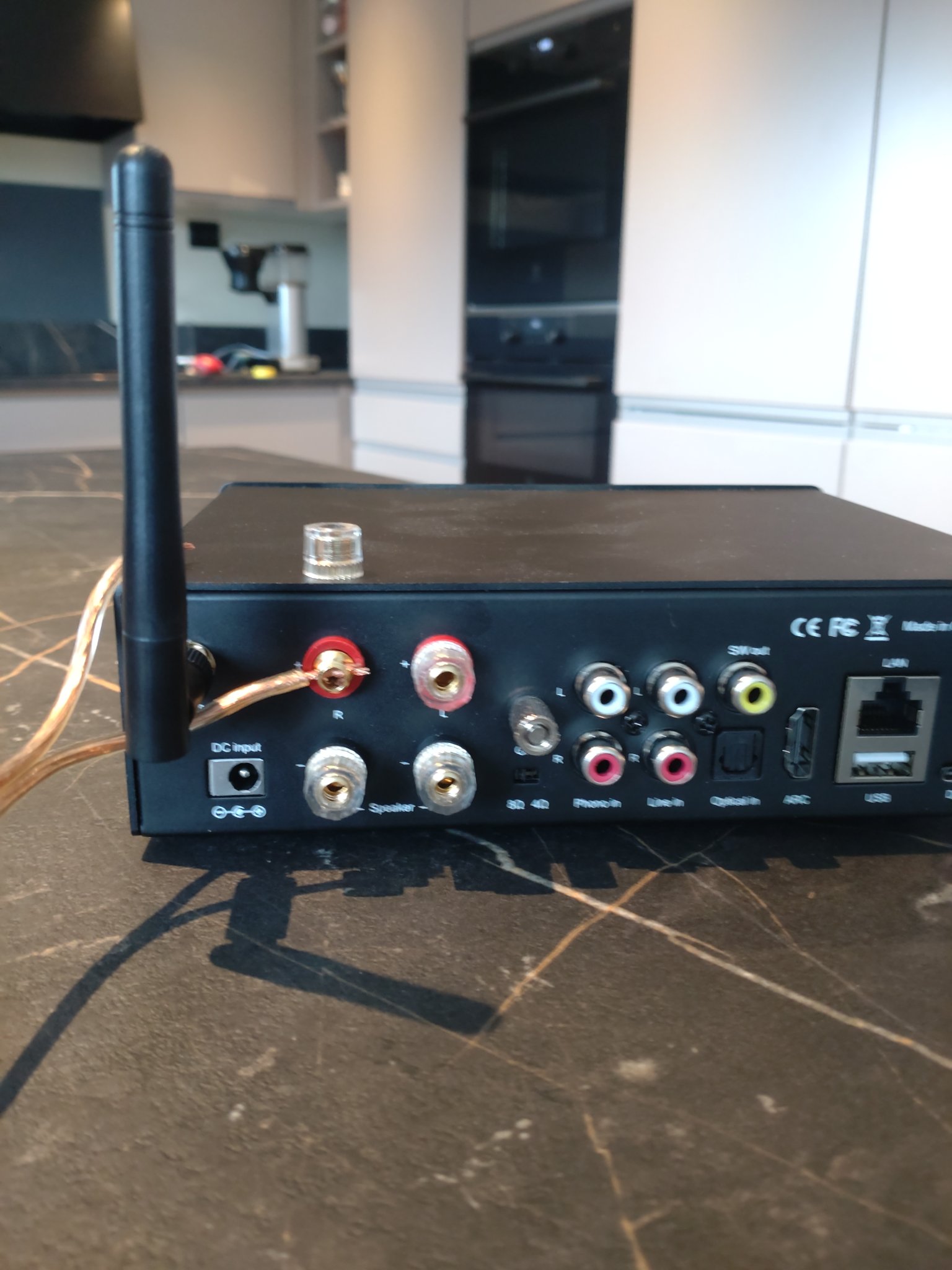

I also liked that you could remove the terminal screws, so you could more easily install the speaker cables👍

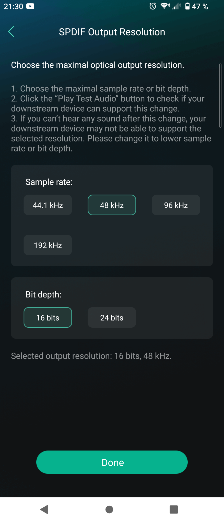

The 4stream app is very easy to use, but feels a little unfamiliar.
and I have one complaint about the app, the EQ in the app.
it has a little too few notches and adjusts the sound.
