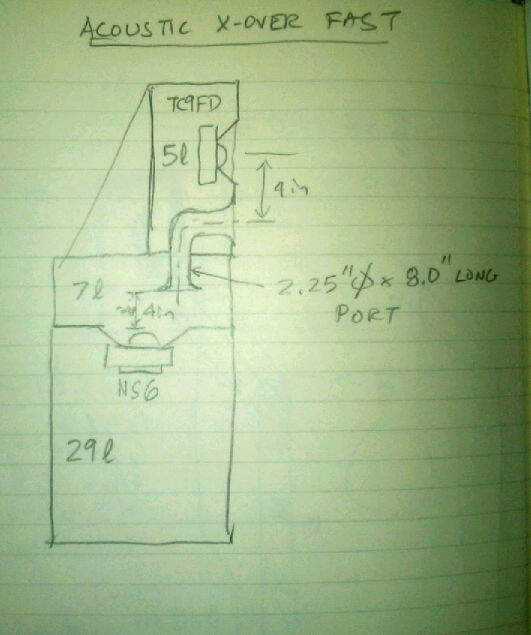

Basically, I am running the fullrange in a sealed cabinet to get a nice tight and flat response. Here, the Vifa TC9FD will be used in a 5 liter cabinet.
This is coupled with a sub-woofer using a Aura NS6 driver in a 4th order double-chambered band-pass cabinet with 7 liter front + 24 liter rear chamber with a 2 in x 2 in x 8 in long vent.
The sub-woofer will be wired 180 deg out of phase in order to match the FR driver's phase.

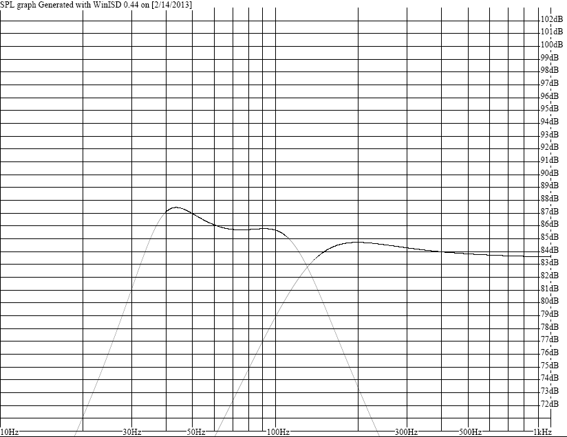

Attached is the calculated frequency response for the sub and FR driver - as you can see, I think they will add up nicely. I adjusted a bit of extra SPL for the sub to give some BSC for the system.

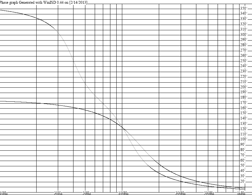

Update:

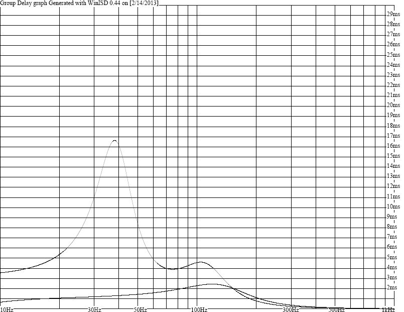

Below are the Phase and Group Delay plots from WinISD. The big phase variation is the sub-woofer and I think sliding it front to back will be key to making this work. I am concerned about the big group delay around the 40 Hz - but I guess that is what you get for trying to eek out a low freq from this 6 in driver.

Ya, what I mean is the acoustic slope of the low pass caused by the box. You said a 4th order bandpass. Does that mean the acoustic slope from 120hz or so, is 24db/oct?

Acoustic centers is what mean. The NS6 will have a longer path length to the design axis. That distace will likely dominate any phase requirements for flipping polarity.
I think this will work. I'd measure and see what happens at the cross over and slide the sub cab forward and back for max summation and you'll have a hit I think.
It's called a "4th order band pass" enclosure on WinISD, but if I look at the freq response graph (post #1), I get (87 dB - 71 dB) from 40 Hz to 20 Hz, or 16 dB/oct.
And from 100 Hz to 200 Hz it falls from 86 dB to 73 dB or about more like 12 dB/oct on high frequency side.

People have such varying views on group delay. I like to think in terms of wavelength, right or wrong. 16ms is a little over half a wavelength of delay for a 40hz signal. Buts its also 40hz. How much musical content is there. And if its movies, well who cares if an explosion doesn't track the input signal exactly. This is a budget build so I'd say it doesn't matter. If it was a high end build I'd try and tackle it because that's when the little things pay off.

I can design the sub to have the port up on top and located very close to the full range, say 8 inches away center to center. I can get clever and design a 90 deg bent port for the sub to actually pass thru the sealed full range cabinet and exit within 4 inches ctc of the full range. That would actually look very cool.
