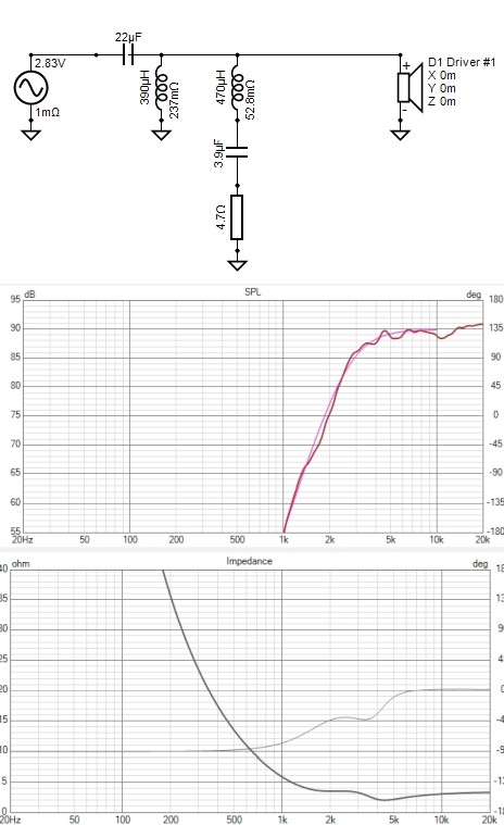

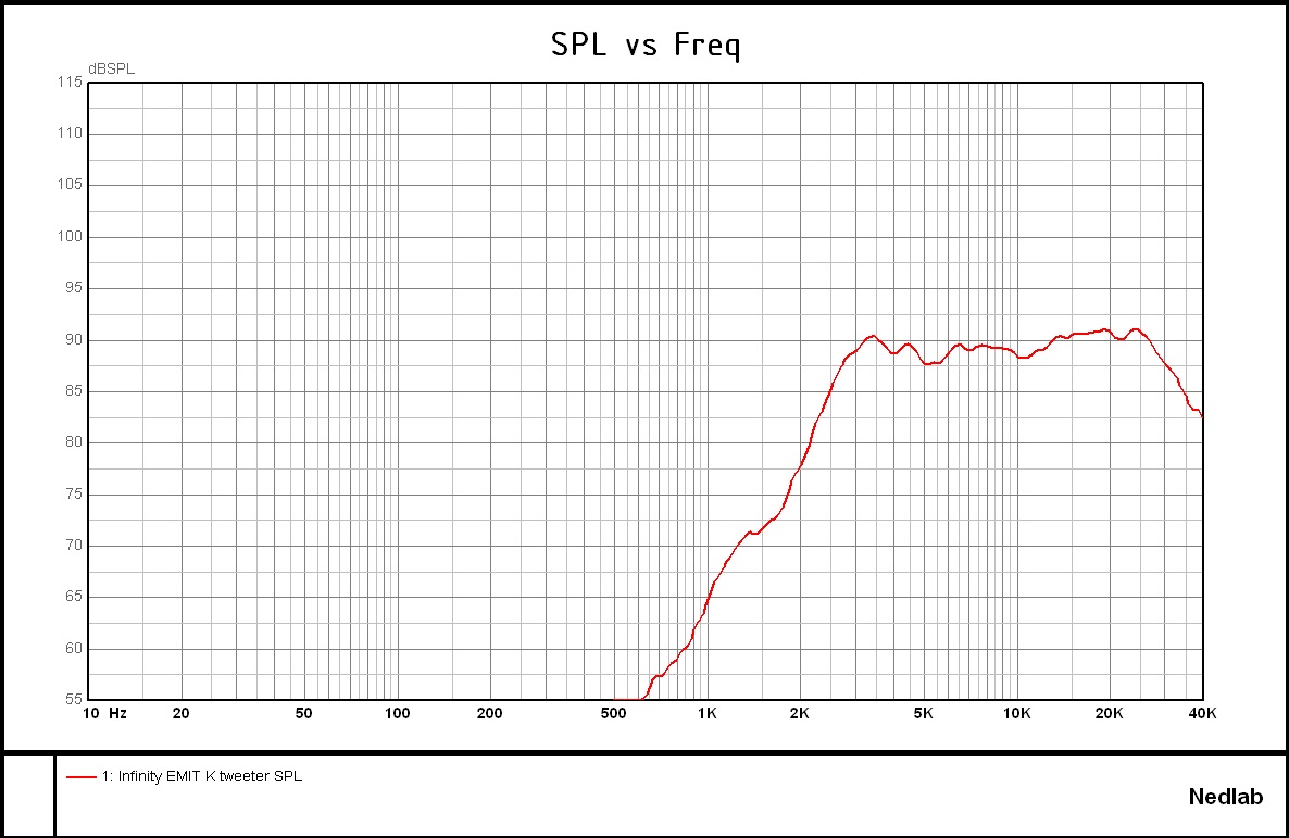

I have the following tweeter, which is about -3dB @ 2700Hz. I'd like to make a high-pass filter (electrical 2-pole or maybe 3 pole?) to work with the driver's natural roll-off to get a Fourth-Order acoustic high-pass response. The driver has a linear impedance of about 3.5 ohms, without any significant peak. I'm hoping to end up with a crossover point of around 3kHz or so.
I have seen this tweeter used with a single series 9.5uf cap, but want to use a fourth -order acoustic slope to mate with my midbass.
Thanks for any help.
-Charles

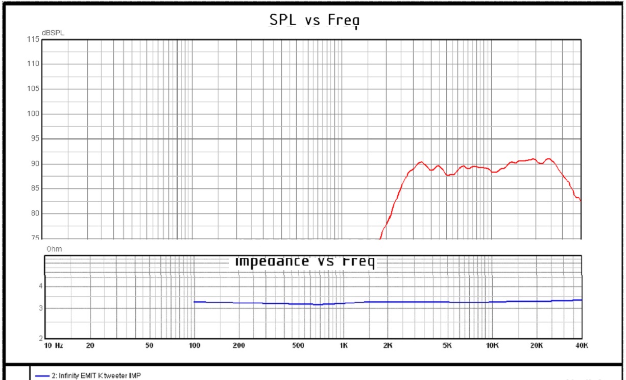

Oh, sorry (needed room for impedance graph) I'll attach the full Monte
(BTW, I'm hoping to combine this with two 3" full-ranges used in an MTM configuration with mids approximately 6.5-7" center to center, hence the low x-over point). The tweeter appears to be a challenge to work that low, but the mfr. used it down to 3kHz in at least one application(although with ample protection in the form of back-to-back Zeners and a fuse).
Thanks for your kind reply and whatever assistance you can provide!
-Charles

No problem- see the lower trace in my first post.
It's an Infinity Kappa, model 908-3082N. I really like the quality of the highs with this tweeter (I tried it with a simple series cap and it seemed to complement my 3" drivers nicely, as their highs were a weak point)

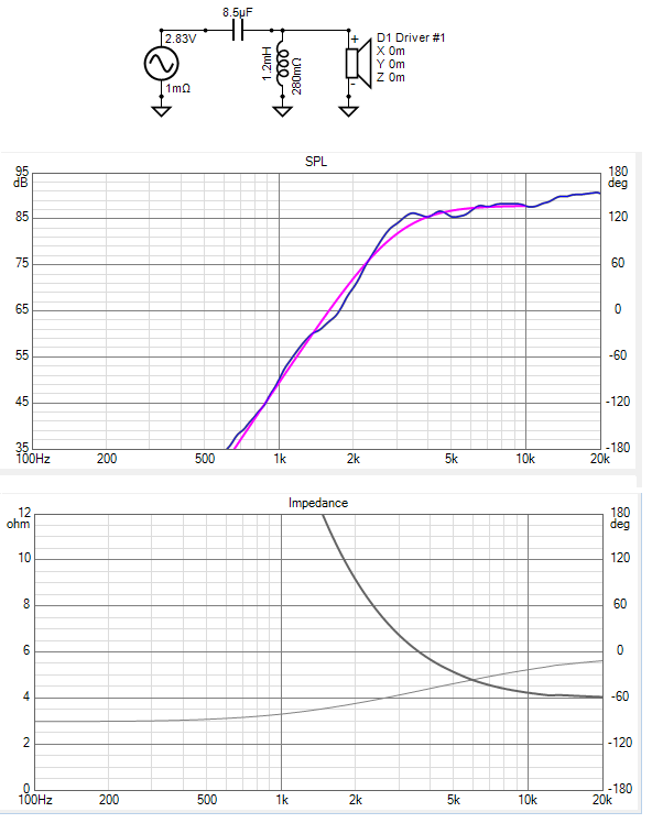

Both our offerings are fourth order, as you hoped for, so it's possible.
That's a common slope. More steep might reduce the tweeter signal slightly, maybe offer slightly more output.. however too far and you can run into other problems. Usually you want to begin around here when you're not sure.
2. Does the corresponding low-pass acoustic response need to be -3db or -6db at the crossover point
Usually somewhere between the two.

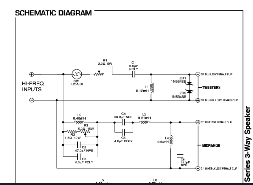

Infinity routinely used these drivers at 4kHz with only a two-pole filter (see pic).

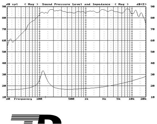

I had hoped to use it between two Tang Band 3" mid-bass, in an MTM with approx 3.5" CTC spacing between mid and tweeter. The TB off-axis response falls above about 3kHz, and allowable MTM spacing also indicate close to 3k. I'm not ready to abandon this (yet). Again, I tried simple symmetrical 1-pole and they seemed to blend, but there was some lobing I heard.
Any ideas on a usable crossover point & slope?
-Charles
