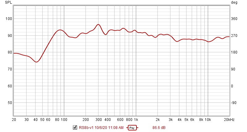

I have the 4 ohm (SB23CACS45-4) version in a 32 liter sealed enclosure. WinISD says it has an F3 around 55 hz. This is a measurement taken in my office, small room, bad acoustics. Bass sounds good to me, in spite of what the measurement looks like.
