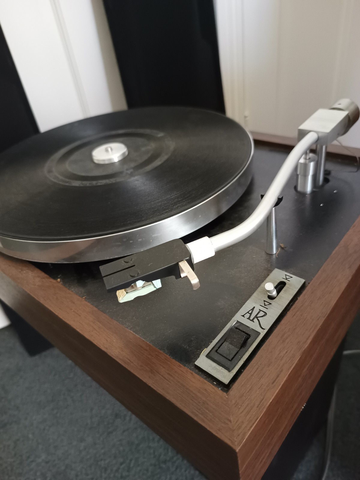

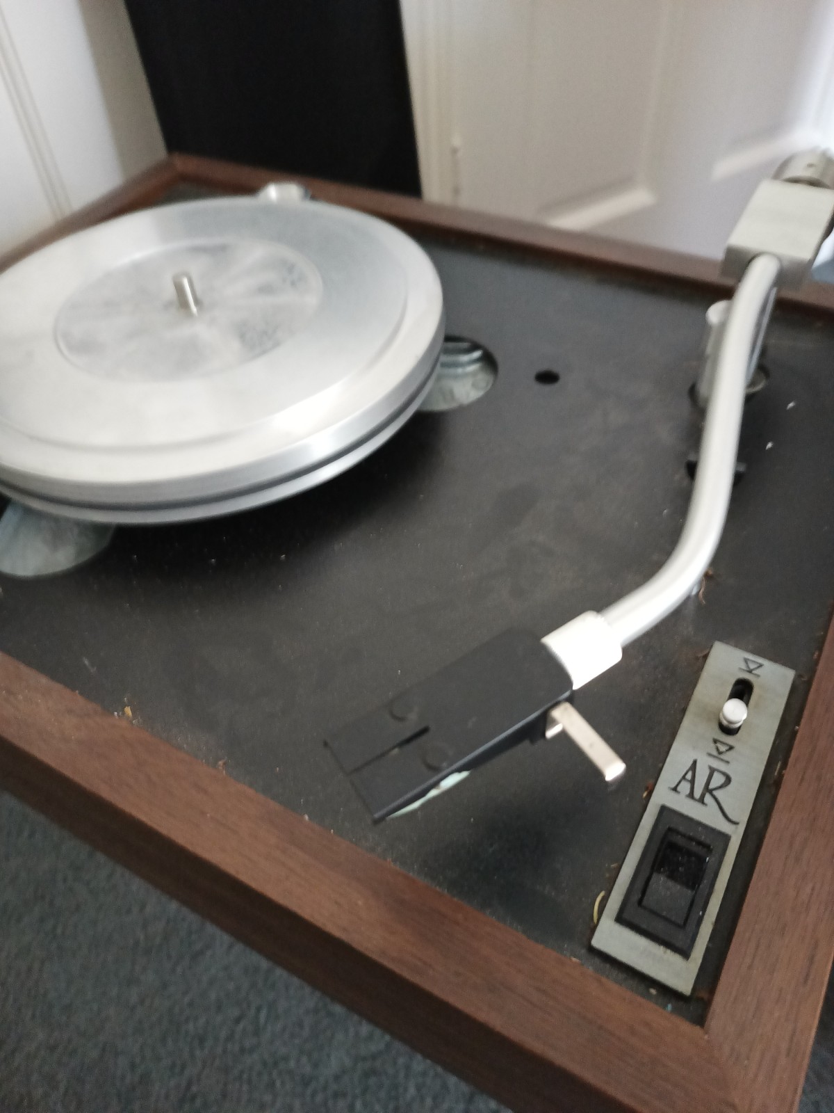

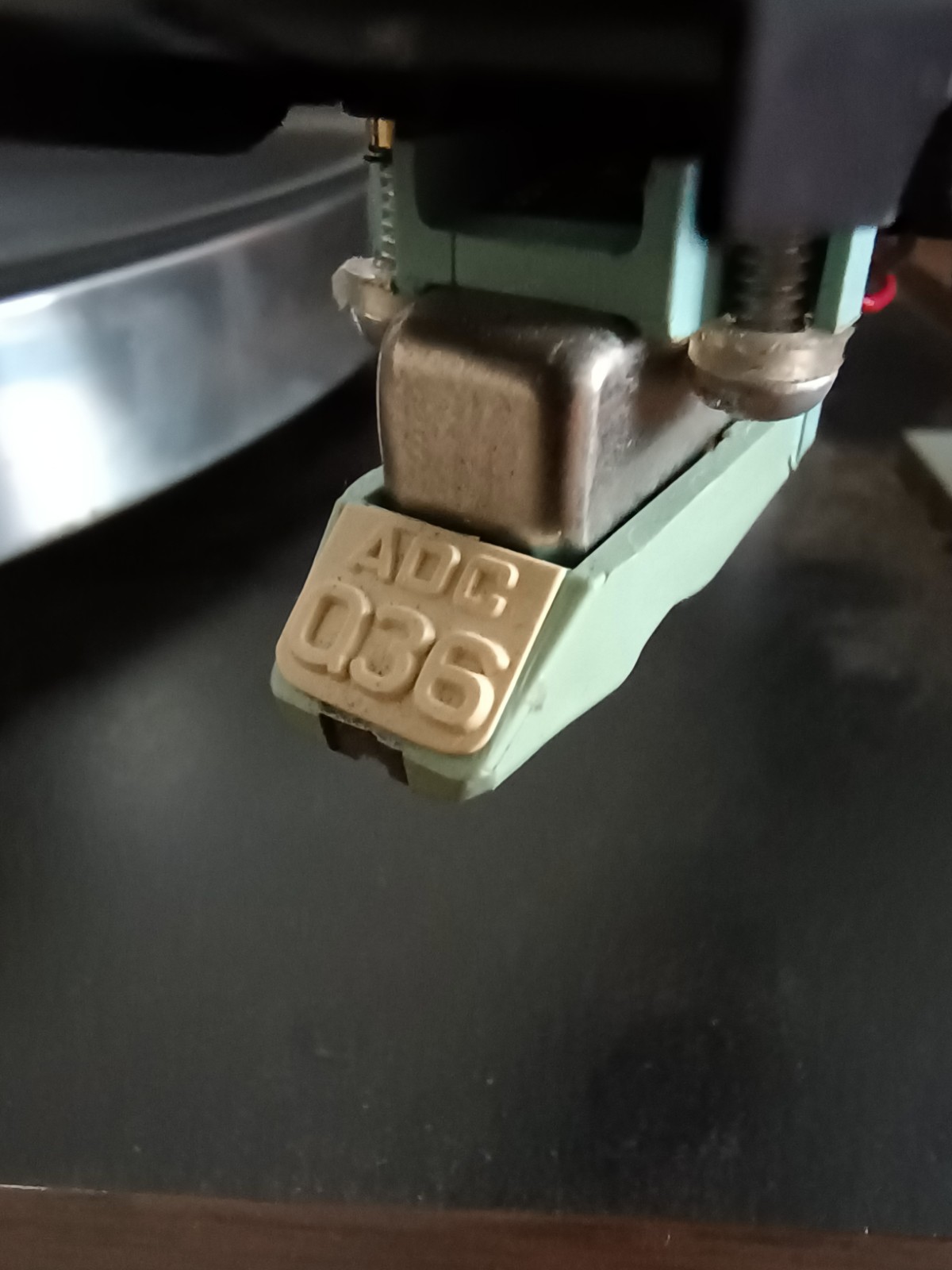

Hi All.
Just acquired an Acoustic Research AR XB1Turntable fitted with an ADC Q36 Cartridge.
My first turntable in 30 years.
Don't know much about this one and haven't had a chance to run it yet.
Hoping for technical assistance.
It's missing the transport bolt.
I'd say, pretty impossible to get NOS parts.
Can anyone help me with the thread size.
I'm looking to buy a stainless cap head bolt or something similar to do the job.
Cheers Cliff

It threads into aluminum. Best guess is 1/4-20 or 5/16-18. I've never seen anyone ship an AR with that bolt in place. They just get sent both platters off and foam between T-bar and top plate.
From memory it is 1/4-20Hoping for technical assistance.
