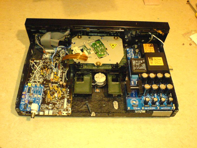

Hi hifi,
Is that a picture of the insides of an Eikos?
hifi said:Do you know anything more specific about what they did to the player?
Im currently rebuilding a PDS-904 into a transport myself.
That is an extensive rebuilding. You have taken out the analog stage completely.
Have you tried to stablise the spinning of the platter by adding small weights underneath the platter?
