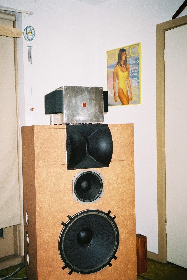

HeyTMC,
Please check out this site, there is plenty of helpful members on the Lansing Forum who I am sure will assist.
For my part I have used JBL 2307/2308 with the slant plate lense and the new bi radial devices like the 2344a.
The lense acts as a diffraction device, diffracting the sound from the mouth of the horn and bending the direction of the sound waves, the profile of the lense allows a contour of the dispersion desired.
The power response of these devices is not linear off axis but they have a flat amplitude response on axis.
The bi radial horn has however a linear power response off axis but requires some equ above 3khz for a flat on axis response by design.
The image below is my current JBL monitor using both cone and bi radial horn technology, the horn sound is not all all obvious, in fact the response is very smooth and imaging is outstanding.
If you want to chat more about this topic send me an email
cheers
Ian

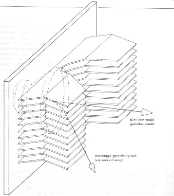

I remembered this pic in one my books.
The translated text suggests that the working is based on a delayed signal off-axis versus not delayed when on-axis response. The proposed lens should thus perform more dispersion on a narrowed soundfield at high frequencies.
A long time ago it was quite trendy ( ~1983 ?) to have them on (cheap) loudspeaker boxes like "Jamo" in The Netherlands.

thanx leo
the diagram you posted is similar to the jbl lenses roddyama and macka provided links for:

GOOD THING WE'RE NOT INC.
And they are the exact same thing I complained about,eating tweeter output and details.
Naturally,for TMCs' application it may not matter that much.
I think Isophon had a horn tweeter using something simailar as well.
Also on most JBL designs you had a level control to balance for a loss in output on a unit.
It may be more effective in far field monitoring but in room I didn't really hear the benefit of susch a lense.

To be honest, I think you are over complicating things by thinking about acoustic lenses, what you really need is a good efficient 12" and horn tweeter box. I would give you a link, but I have just upgraded my OS, and have not transferred all my links across yet, but do a google search and you should find many references.
What you really need is not cutting edge technology, but a box that will be robust, have good power handling, and is lightweight, take my word for it, at the end of the gig, sound quality comes a distant second to how easy it is to carry down the stairs and put in the van.
a good point.
And one i know well as i have carried my share of rigs,amps inst. etc, etc. up,down,around,on and under just about every immaginable enviroment over the last 20 years.
Call it self indulgent,call it excessive.... fair enough.
I've got some spare time and material and want to play around with some ideas.....
not out to slam ya pinkmouse....but I am pretty sure about what i'm after.
thanx for your input
and for watching out for my back!!!!!!!!!!!
