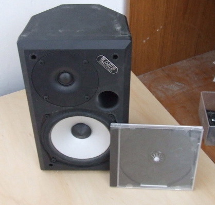

one of my AE1s has gone kaput.
The mid/bass voice coil is rubbing, well more accurate to say, almost locked solid.
It must have overheated and on cooling became distorted.
Does anyone know of a replacement driver that fits the cornered rebate and is a good substitute for the T/S parameters of the original?

the AE1s are fitted with a 130mm pressed steel basket, aluminium cone and centre cap, rubber half roll surround, 134mm PCD mountings.
They have an aluminium voice coil former (it may be in one piece with the centre cap) about 30mm diam and supposedly 150W power handling through the passive crossover.

This is a very old thread, but rather than starting a new one.....
I have recently bought an early pair of ae1s and original cast speaker stands from ebay that were described as "refurbished" - ie they have had new foam surrounds fitted to the woofers. (I think these were s1 that were probably upgraded to series 2 in the early 90s as they have the later tweeters fitted). This work appears to have been carried out to a high standard, and i have to say that the speakers are in lovely condition overall. I'd say they have been very well looked after.
There is a problem with the bass driver on one of the speakers.
This only becomes apparent at higher volumes (and so was not detected when I collected them). There is an obvious scratching/distorted/clicking sort of noise, particularly on more bass heavy music where there is greater cone excursion.
The obvious thing to do would be to return the speakers for a refund. However I'd rather not as the seller lives 3 hours away and to be honest, they were an absolute steal. The original stands are worth more than I paid on their own.
I've tried to make the usual diagnostics; the cone appears to move freely by hand; the spider and voice coil adhesive joints are sound; the linkage wires aren't vibrating against the cone; I've rotated the driver around into different positions. The problem still persists and to me it does sound like the vc is rubbing!
I could almost live with the fault. They sound fantastic at lower levels. But occasionally I am going to want to crank them up.
Does anybody have any ideas? Any recommended uk based speaker repairers?

The first thing I would check is the crossover for dried out electrolytic capacitors. It could be one is breaking down at higher voltages and creating the distortion. The other more unfortunate problem would be if the voicecoil wire separated from the former due to overheating. It would sound OK at low volumes until the wire starts to buzz and rattle. This could only be fixed by replacing the driver. Sorry, I a from the states and have no knowledge of repair shops in the UK.
Thanks for your reply. As far as I know, the crossovers use only film caps (polyester?), so there are no electrolytics to worry about.
If there are loose windings on the vc, why can't I hear them rubbing when I move the cone manually?
The voicecoil winding are glued to the former and to each other with a high temperature adhesive. It can fail and the wires can separate. They may not be touching the gap. When the coil accelerates, the windings can come apart like a slinky. I had a old school driver where this happened. Pressing the cone did not give scraping, but when I removed the cone and voicecoil, you could see where the winding were separated. It is unlikely the poly caps are bad, or that a resistor would fails in a manner that was intermittent with voltage. Not impossible however.
You could try to directly drive the woofer with you power amp. Remove it from the crossover first. If the driver is bad you will hear the same noise, If not, then the crossover or possibly crossover connection. Sometimes corrosion sets in on the connections. If it turns out to be the crossover, I would re-solder or re-crimp the connections before I replaced anything.
