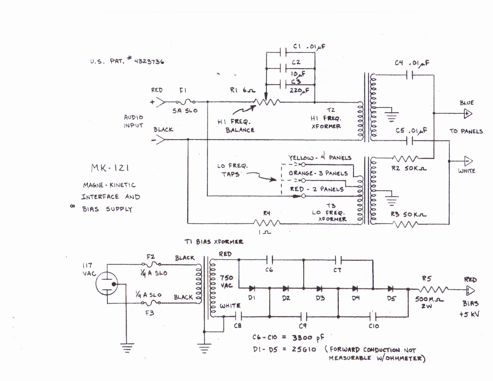

it's pretty simple.
The HV supply runs up the middle.
It is a multiplier circuit.
It boosts the original AC voltage up to 5kv.
The two other caps are caps, but high voltage.
They couple the HF part of the audio.
The resistors are probably fine.
They couple the "LF" part of the audio.

Is only the diode/cap multiplier burned up (the middle bit)
Usually what happens with them is that the caps short or get very leaky. Then they take out the diodes.
I just had the 500mohm on one channel open! Wierd.
That's probably the hardest part to replace there.
When you go to rebuild buy caps with 6kv ratings so you can forget about them forever. Replace both sides. They are .003ufd, but the value is NOT critical at all.
I have used a pair of 1000PIV 1amp diodes in series per leg with no breakdown problems so far, for replacements. Or you can buy HV diodes. Or steal big HV diodes from microwave ovens, or maybe find some in the HV supplies of junked copiers and laser printers too...

Don M, what you have sound like a pair of Acoustat 2's they are about that hight and width, here is the circuit of the power supply it may help you.
Cheers George
