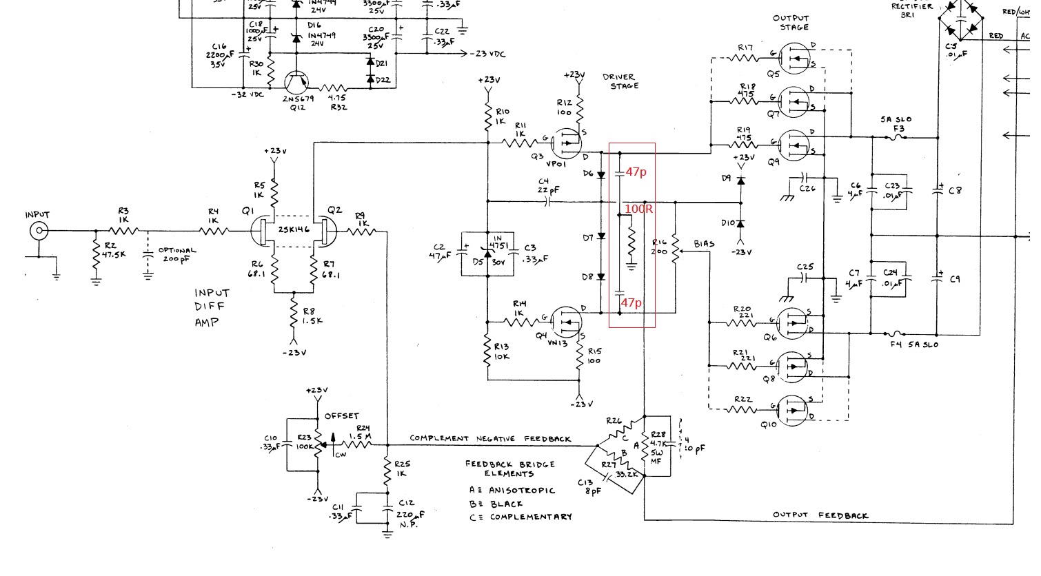

Anyone have any experience with this amp oscillating? I can see it at the input and output. A 10K load and oscillation returns.
I short the input and oscillation goes away. Hard to tell since it could be coming from feedback loop via the output. I think Q1/Q2 FET is bad since it appears these have been replaced with a single package unit and the short to ground at input makes the oscillation null at output.
Some diodes were removed as a mod(Roy Esposito's mods), not sure if these mitigate oscillation or not. Also, C6,C7 look like different parts compared to left channel but are .1uf parts, these tie mosfet drain to gnd at output.
Link to Schematic
You can try adding two caps and one resistor to the bias diodes to compensate the amp from oscillation.

The biasing scheme for VAS/drivers Q3/Q4 is rather odd(*) - any change in the supply voltage will strongly affect the biasing here - under-biasing here might cause oscillation.
(*) I could use strongly language here!

I don't mean the output stage bias, I mean the drivers/VAS bias. Check the voltage across R12 or R15 to see what the bias is for that stage. It is very sensitive to D5 and the supply voltages from the circuit topology - if the voltage rails have issues this bias may be way out.
4.5v across both R12 and R15

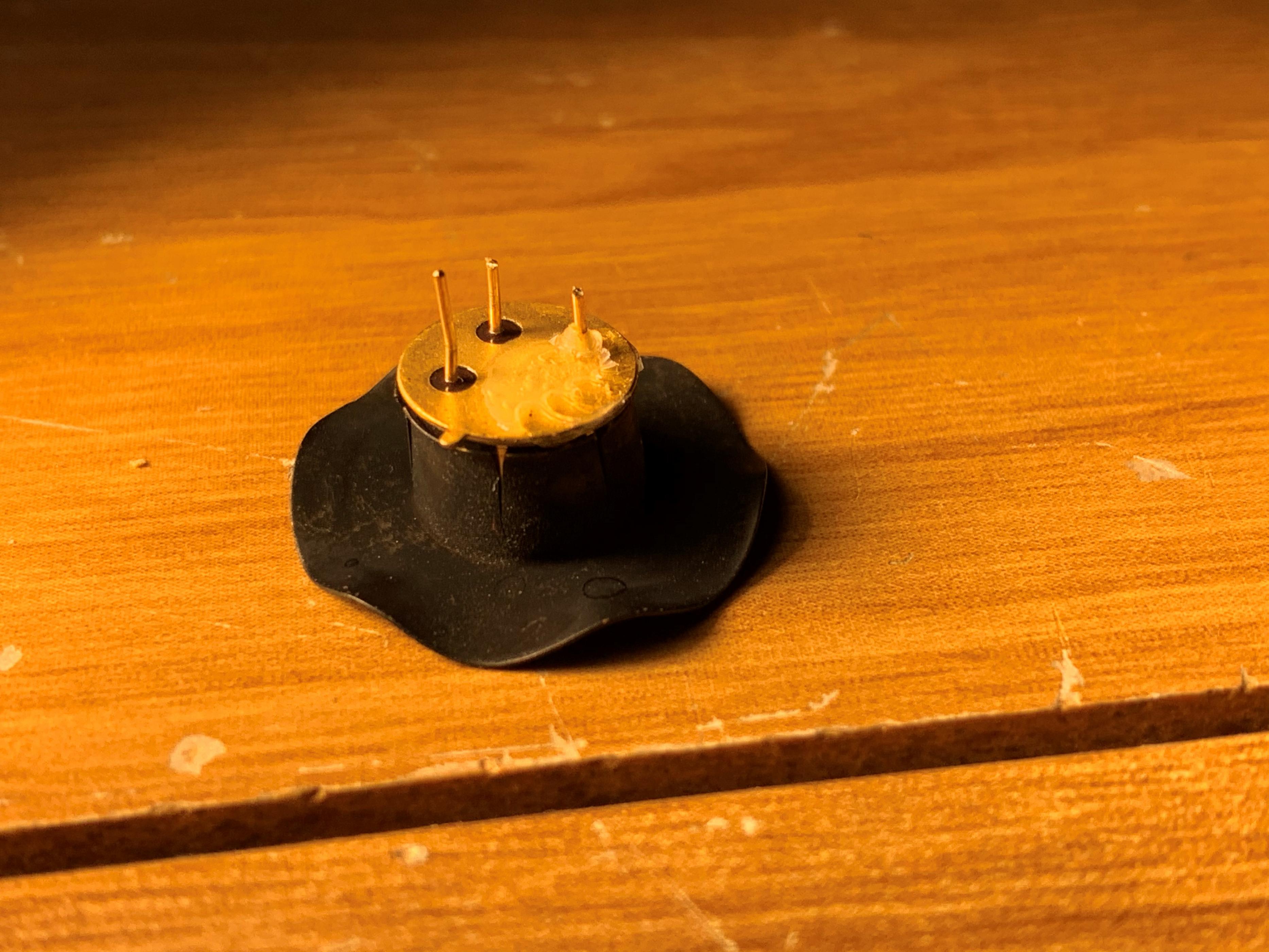

Resolved!!
Just found the problem, driver FET was loose and has excess glue on pin
I was able to wiggle it and oscillation was reduced(it also got worse and bias went up enough to blow fuse), still has a bit of a connection issue. I thought those were transistor spacers on the board, not transistor sockets!!
Have never seen those before now.
