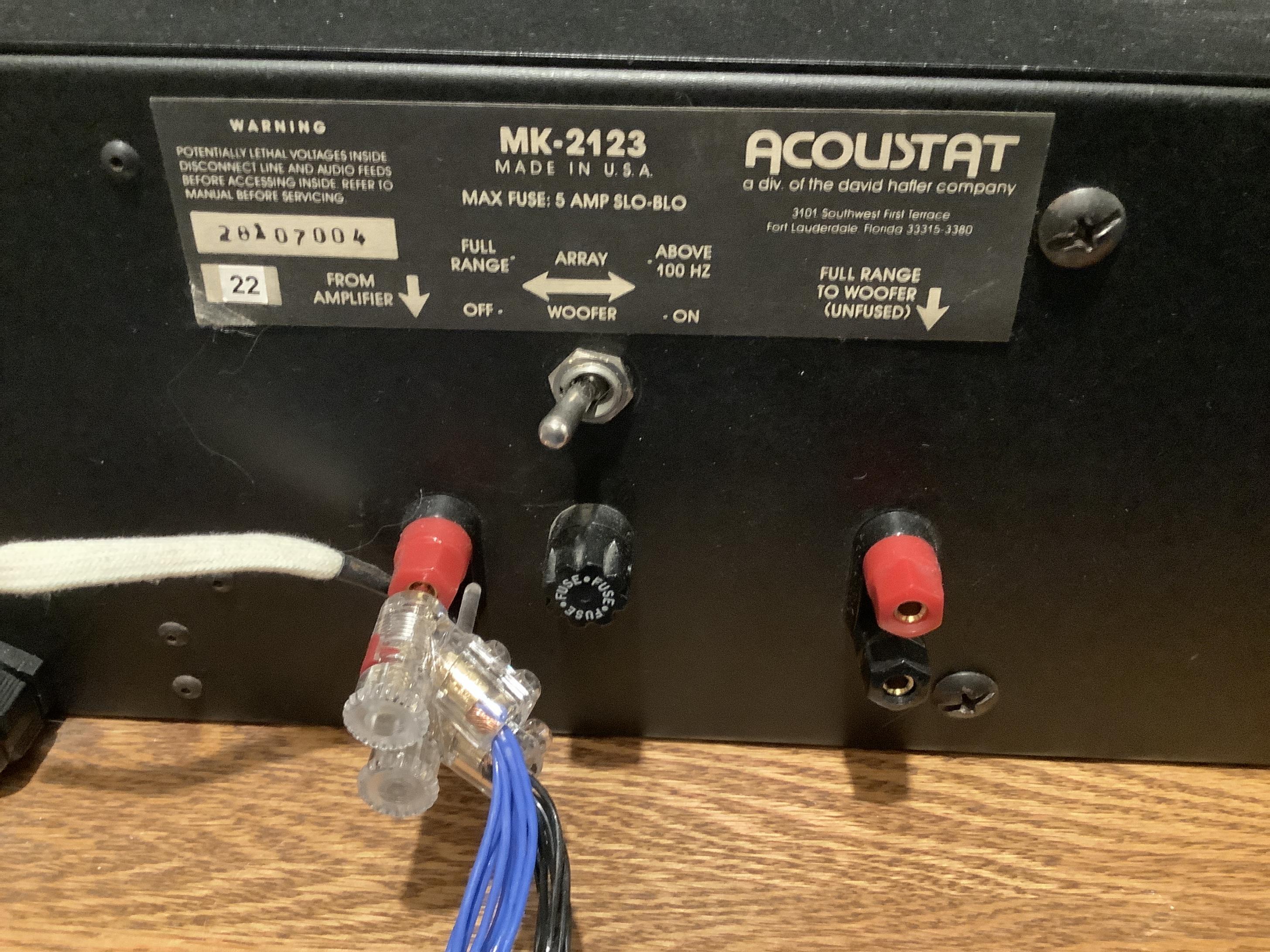

Resurrecting this thread again. I am considering a pair of Rel T/7i subwoofers (8 inch driver) for my Acoustat Spectra 22. The interface allows you (With the flick of a switch) to run the speakers full range, or to cut the response to the panels below 100hz and run an output to a sub, which I assume would have to have its low pass crossover set at around 100hz. This speaker was often sold with a single matching sub back in the day. The Rel subs allow (and favour) the use of a high level hookup which I would be using from the interfaces sub out terminals. The other alternative of course is running the speakers full range and “blending” the subwoofers in with a lower crossover frequency, say 50 or 60 hz.
The obvious advantage of the first approach is that the panels would no longer have to reproduce low bass. And this can be done without an external crossover and extra cabling. I have listened to the panels with the switch set for 100hz, and the mid and hi frequencies do sound clearer and crisp. But the music looses its foundation and sounds very thin.

Anyone have a Spectra 22 with the matching sub, or try integrating modern subs with these speakers using the 100hz cutoff? I wish it was lower, like 70hz but it is what it is. Acoustat made it this way for a reason, so it must work somewhat at least.

I don't think you need to use the high level output from the Spectra 22. If you were using a passive subwoofer, that connection would be more appropriate.
As long as moving the toggle switch to "above 100 Hz" does what you want on the Spectra 22's, the controls/crossover on the powered subwoofer should do the rest whether you use high or low level inputs.

A question for anyone who loves Acoustat. May I build a couple of 33 using 22 and two extras spectra panels? Thank you
Yes the Spectra 22 interface can work with an extra panel, you will need to build a new Spectra 33 frame. The drawings for the frame are available.
Thank you Atom. Where can I find drawings for the frame and electrical connections for new panels?
See attached for the color codes of how to wire any Spectra model.
I no longer have the frame and base drawings. However, if you have the requisite skills to build a new frame and base, copying the Spectra 22 frame, and adding one more section for the third panel should be fairly straightforward. Ditto for the base.
