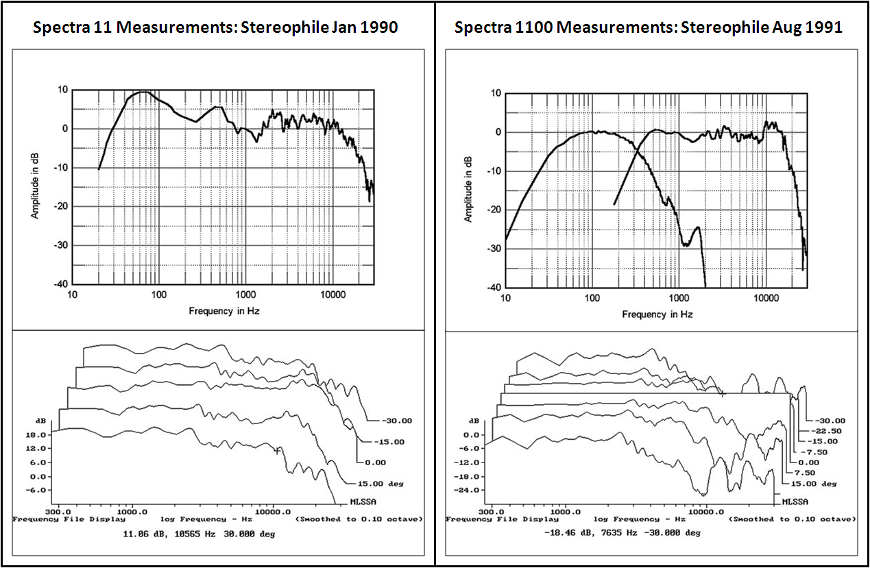

Two things that caught my eye in the measurements were the dramatically different on-axis response and horizontal polar response. It was my understanding that the Spectra 11 and Spectra 1100 shared essentially identical ESL parts, only the woofer/crossover and cosmetics were changed.
After a careful read through the text of the measurement section I determined the reason for the difference in the on-axis response. The Spectra 1100 measurement had the mic placed vertically at the center of the ESL panel. The Spectra 11 measurements had the mic placed 36” from the floor(JA’s “normal” listening height). This puts the mic well below the vertical center of the ESL panel and would account for the rolled off highs.
The disparity in horizontal response curves was puzzling as they should be near identical since both measurement sets were taken with mic placed at the center of the panel. Then I noticed that in each review, the +15/-15 curves matched each other as did the +30/-30 curves. JA obviously had measured the horizontal response in only one direction(not both) and just mirrored the data. This works fine for most speakers, but the Spectra 11/1100 has an asymmetric panel layout resulting in better dispersion to one side than other. My guess is that the Spectra 11 review shows measurements taken to the listener side, and the Spectra 1100 review shows measurements taken to the sidewall side.
It is not a subtle difference, and a good reminder to make sure you have your Spectra Left & Right speakers placed on the correct side of your setup for smoothest/broadest response.

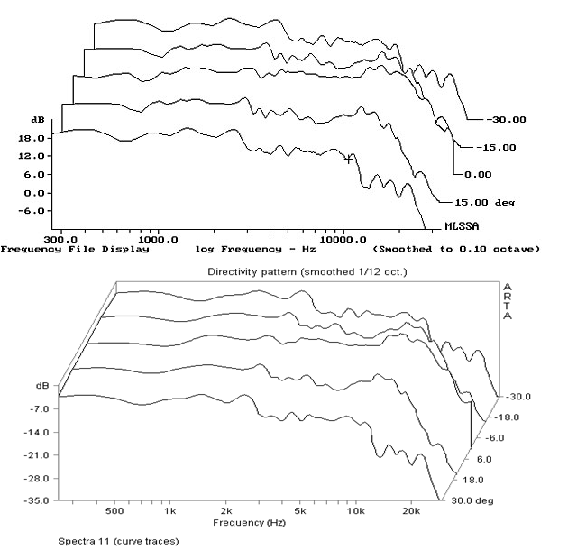

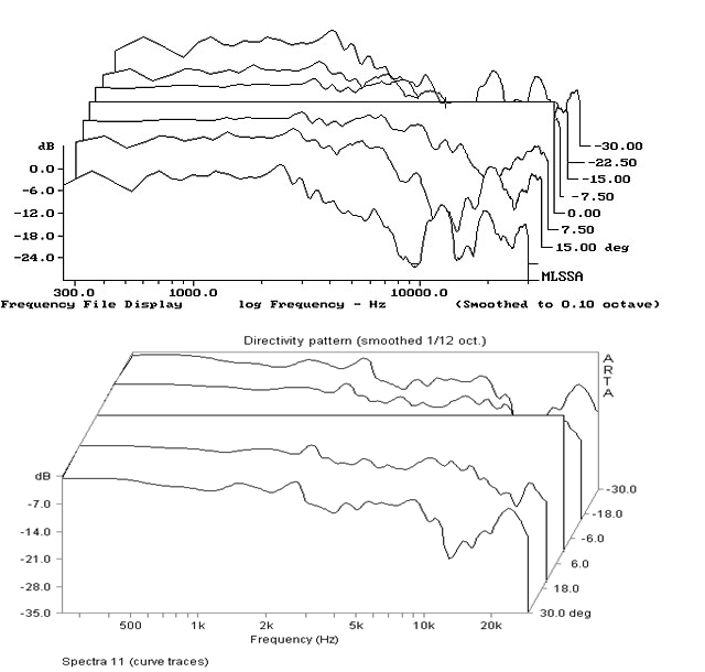

I agree, it is a bit apples-oranges trying to compare the normalized Spectra 1100 polar response with the un-normalized Spectra 11. To provide a better comparison and get a better handle on the amount of top octave “beaming” on either side of the Spectra panel, I used a curve tracer to pull the Spectra 11 responses into ARTA to re-plot them normalized.
Attachment #1: Shows comparison of the published source data vs the curve trace data. The viewing angle for the isometric is slightly different with ARTA, but it is easy to see we are dealing with the same response curves. Response is slightly smoother as ARTA added 1/12oct smoothing, but all the trends and wiggles overlay nicely.
Attachment #2: Shows comparison between normalized Spectra 1100 curves(top plot) and the normalized Spectra 11 curves I created with ARTA from the published un-normalized data shown in Attachment #1. It is now very obvious that(relative to on-axis) at 15 degrees off axis the Spectra 11 data is only slightly shelved down at 10Khz with a shallow roll-off starting above that. At 30 degrees, response still holds up nicely to 10khz, but the roll off is now rather abrupt above that. By comparison, the Spectra 1100 data shows 10khz down by 18dB or more at 15 degrees off axis. By 30 degrees, the steep roll off is starting by 3khz and lobing is starting to occur just above 10kHz.

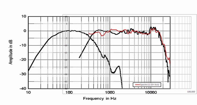

To investigate how different the on-axis response of the Spectra 11 was compared to the Spectra 1100(with switch in the middle position) I used the on-axis data from the Spectra11 polar plot I had traced into ARTA.
Attachment #3: Scaling the dB and frequency axis to match, the Spectra 11 on-axis top-octave response is nearly identical to the that published for the Spectra 1100.

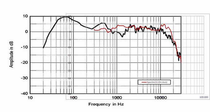

Attachment #4: Scaling the dB and frequency axis to match, the Spectra 11 on-axis response is compared to the response taken lower down on the panel(ie 36” from ground). It is easy to see why it was recommended to listen on the panel axis.
