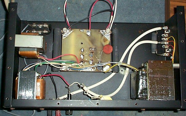

About the-glueing of the felt an....first thing I do with any ESL this old... is re-work the bias parts in any of the interfaces.....even puthing in new old stock 500meg res..
you can still find the glass stock type on the web...I paid $7.ea US...trust me that 500meg has been cooking....24/7 like all the bias parts...
But I use a QSC old pro amp to test all ESL....why they sound great...an they have (Fans)....Fans work well.... to tell us if the interfaces tranfourmers,parts,bias is working well....as with the 2+2s before re-glueing....the fans woulds come on vary eze... be for the re-glueing...now even pushed loud the fans don't even come on....I was shocket..

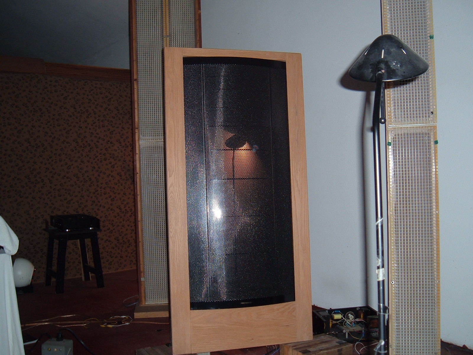

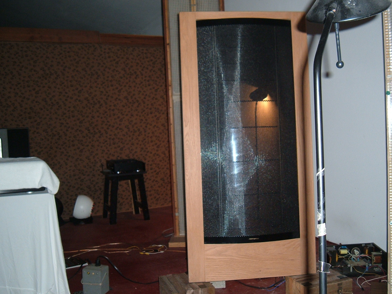

Year ago pic up a pr of the older first Martin logan CLS...89-90
Thay were owned by a smoker..could not see thought the mylar.....
So I set out to see if I could re-work these panels.
Thay are my reference now....I have diff transfourmer an 5k bias in there interfaces now with no tone shaping setup like logan uses....just one 1ohm res....
No not as much bass as the Acousatas...but well play louder an clear as life it self...can be...22x48" panel with one peace of mylar..no felt in the back....Wow ,work out better than I ever thought....but this re-gluing of the felt on the Acoustats....sound is much closer now to the CLS...gofig

Very nice MLs. Mine are the Monitor 3 with the DD OTLs. I also have Model 3 with the upgraded Medallion interfaces. They've had minimal use from the looks of them, very clean inside out. They sound great, no dullness, lots of volume. But they are a notch below the Monitor 3. I have a selection of superb amps to drive them and I've concluded that directly driven ESLs are the ultimate. They are simply closer to the source. I have a second pair of OTLs so I could build a pair of 6 but I don't have the ceiling height and I'm not interested in the 'wall of sound' 🙂

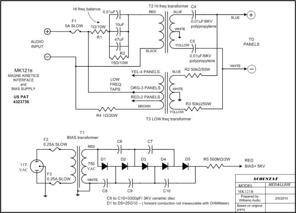

The Acoustat 3ea panels setup just sound right!....It must have to do with the bass tranfourmer orange positive input weir ....it must show a lode to the amp driving the interfaces that it likes...I gess some may say its the one 8" panels in the mix...but I have used 3 9" panels an got the same great sound...funny
The 1+1 an the 2s are the only one that use the red bass input wire...an it has a sound of its owne for sure....2 panels side by said never sounds right to me...

Look at the 121 box see the red,orange,yello wires.....on the right
look at the bass trans inputs.....in the schematic it the 3 panels setup..on the orange wire......
