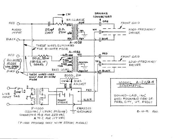

I have always wanted to remove the HF pot altogether (I always have it on min resistance anyway) and put that pot in series with the bass transformer and dial in best bass/midbass.
If anyone has ever seen the schematic to a Sound Labs (actually found it) they would understand why (they have up to 50ohm series resistance on bass tranny)
I know they have separate bass and treble panels unlike the "mixer" of the Acoustats, but wanted to try nontheless... with that kind of series DC resistance, you never have to worry about having an amp peter out on you...

The schematic you posted is for an early SL design that used separate bass and treble panels.
The 50 Ohm series resistance was not for dialing the amount bass you want, rather it defines the low-pass crossover point for the bass panel. The amount of bass was adjusted by selecting different primary taps. For lower distortion, it would be better to move the series resistance over to the secondary side like Acoustat does with their mixer resistors.
All SL designs since the 90s have used a mixer and drive the entire panel with the same signal just like Acoustat.

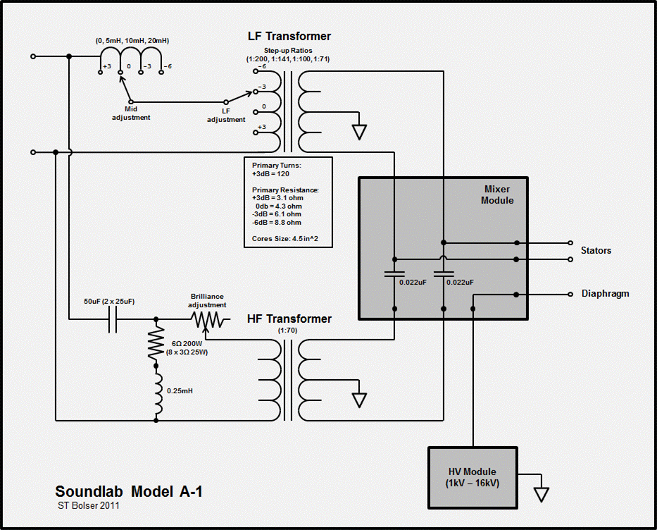

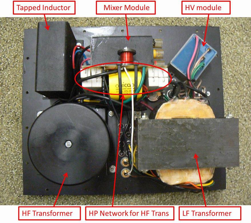

Typical Soundlab Interface Circuit
Attached is a pic and schematic of a typical SL interface.
The circuit will vary slightly depending on the vintage and model.
Note that the circuit is extremely similar to the Acoustat MK-121C
The main difference is the Acoustat mixer resistors are replaced with a high resistance primary winding on the LF transformer.
More info comparing Acoustat and SL mixer here:
http://www.diyaudio.com/forums/plan...cls-ii-stators-best-way-do-2.html#post3822064
Bass level is adjusted by selecting different taps on the LF transformer.
Mid level is adjusted by selecting different inductance in series with LF transformer.
Highs are adjusted with variable resistance in series with HF transformer.
