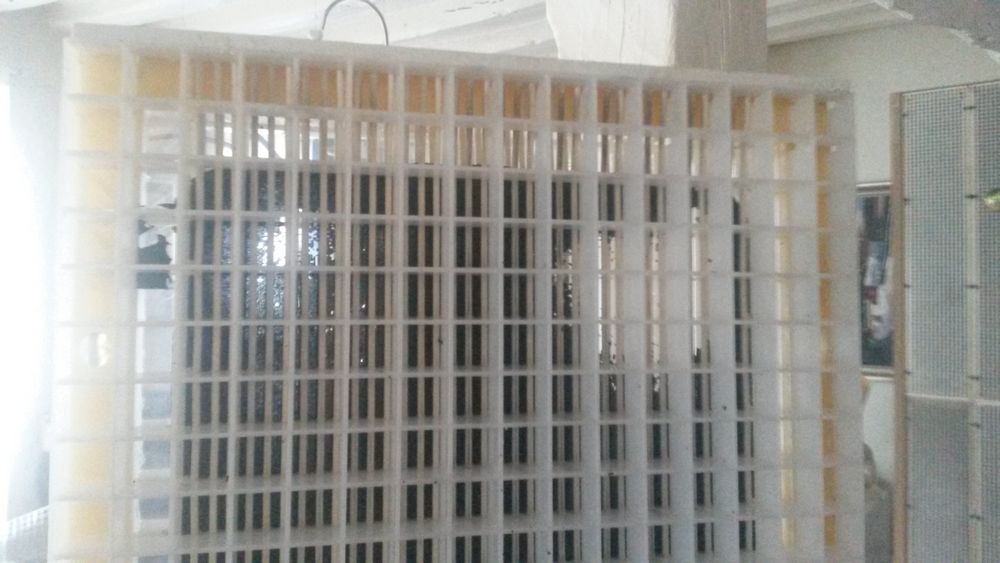

I bought 8 pannels second hand, washed them 'as usual', and discovered 'holes' in the lower area of the coating. I can see through the diaphragm, two nice windows about 1 to 4 cm in diameter. First time for me...
I checked the HV with my probe : there is no more conductivity/HV in that area...
I repaired one of them with a silver liquid made for the auto's glass heating system repair... Works -the HV comes back in the repaired area-but I've not any confidence in the robustness of my repair, and the resistivity of this product is almost zero...
By 'luck' the area is close to the side of the pannels so I can remove the wires for any surgical intervention ...
Any idea ?
PS : I'm suck at computer, and could not post any picture on the forum. Look bellow for the location of the defects. Same location for all damaged pannels.

You do NOT want to use silver there! The coating needs to be very high resistivity, which generally means carbon, and very thin. This prevents charge from migrating.
I have Acoustat panels with 1" holes....that still work great... cant hear any diff.. an thay dont get biger......

Hmmm...that's the first time that I've seen the coating come off an Acoustat panel. Based on your photo, it almost looks like some of the coating was removed by means of a solvent, rather than losing adhesion to the substrate. I wonder if someone tried to clean the panel with a solvent, or a solvent got spilled/splashed on the panel. Who knows...many years have passed since its manufacture.
In any case, any attempts at repair will likely result in a worse problem. Using any sort of metal-bearing liquid as you described is not a good idea and is very much the wrong resistivity - it could even lead to arcing in that area.
As Tyu suggested, listen to the panel first. Although certainly not perfect, the defect may be hard to detect, especially if the panel is with a larger array of panels.

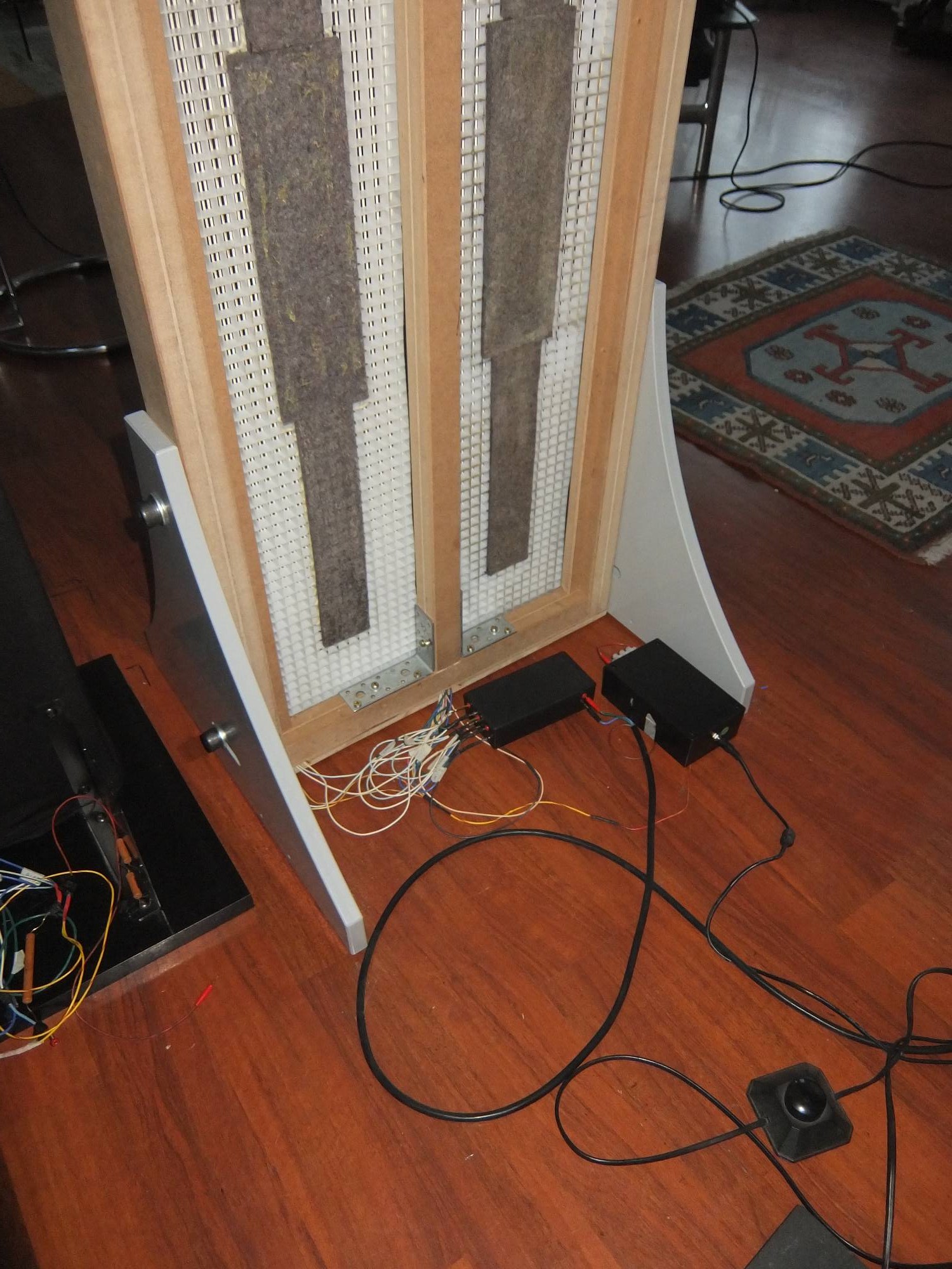

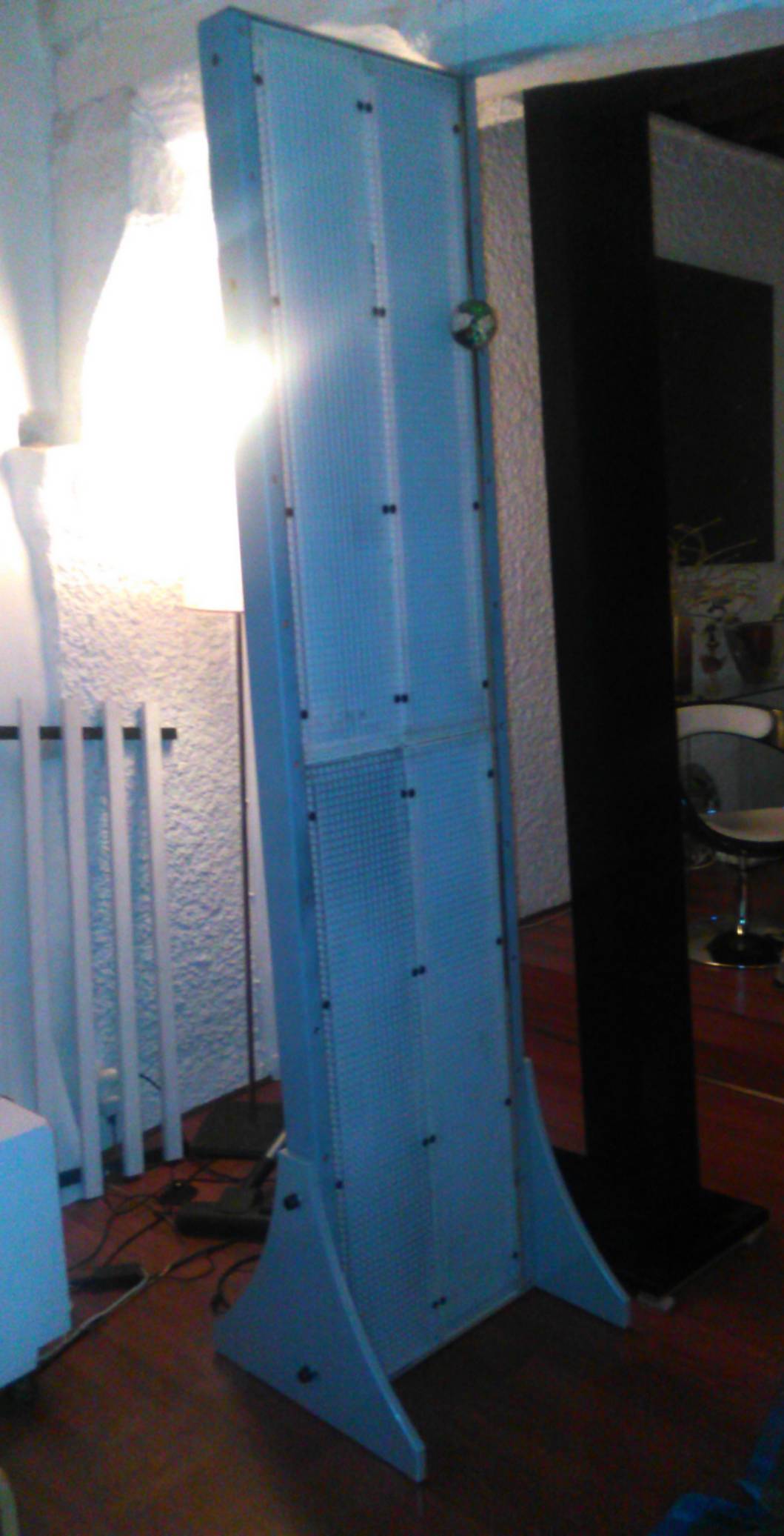

The Spectra 44 work nicely. All the mods done, -including the heavy and rigid frames- gave to them dynamics which make them sounding a little less 'ESL'. Result is good, in the 15/20 k$ range would I say. I also modified the louvre so it is less directive. Works good too.
I also damaged a pannel while trying to glue a defective HV wire.... The wire is now glued to the diaphragm. This pannel I will sacrify (!) and try to change the diaphragm with the infos given by M.James. I'll give you news ....

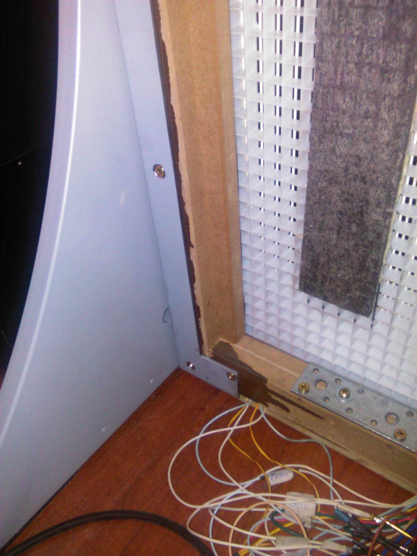

... These are the steel reinforcements which were later added to the frame.
=> 3mm thick stell plate, laser cut, CNC bent from 3D data, epoxy glued.
! Great improvement !
