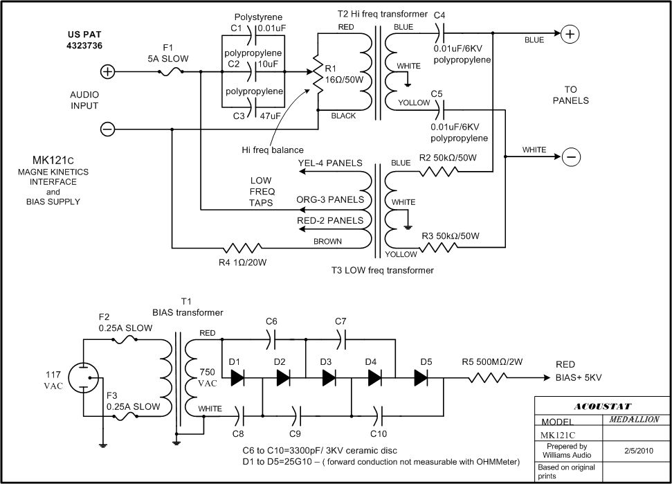

i have Acoustat 3, think that is the medalion model MK121C
i want to replace the capacitors and the voltage multiplier & if is possible to improve the xover.
this is the schematic i have, there is any thing that could be done better
thanks for your time

the caps in the multiplier? sure. NPO, high voltage type.
There is a suggested change to the level control wiring -think it has been posted, search?
The HV coupling caps are hard to beat. Also been discussed...
I got rid of the speaker fuse - you may not wish to defeat this.

Yes, I meant the big "pot" for HF level setting.
There is another way to wire it, might be better...
The HV caps, if the ufd value is about the same, sure... higher voltage yields a longer life.
But the life stock is >20yrs now...

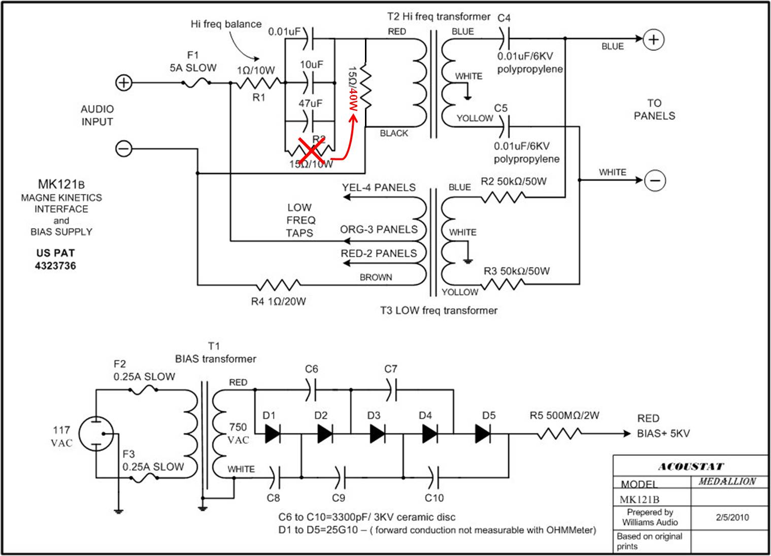

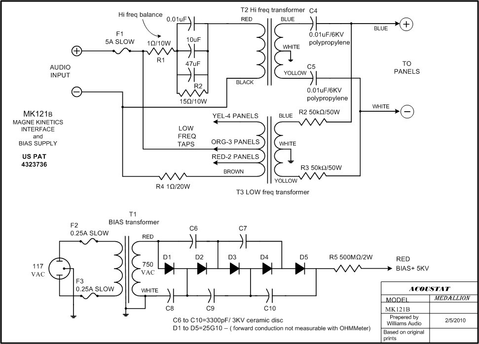

I opened the acoustat interface boxes and found
1 - Model MK-121B medallion, not MK-121C
2 - there is a change in hi freq path, it's not the original circuit, as shown in the scheme attached, two resistors replace the rheostat and one connected in parallel with the capas.
Is this a known change or mistake circuit, original scheme shows different circuit
3 - as I have no rheostat to balance, what is the best setting for flat hi freq responce, with two resistors.
Sincerely,
William

My opinion is that if your interfaces are wired as shown in your schematic it was a mistake.
I would recommend moving the 15ohm resistor as shown in the attachment below. Also, this resistor will need to be able to dissipate quite a bit of power. I would recommend using a resistor rated for 40W or more to keep it running cool.
The purpose of placing the 15ohm resistor across the primary of the high frequency transformer is to provide a constant load for the crossover capacitors so they can better filter out low frequencies from reaching the transformer.
A second function of this resistor is to keep the high voltage output from the low frequency transformer from feeding back into the secondary winding of the high frequency transformer thru the 0.01uF capacitors and saturating the core. With this resistor in place across the primary of the HF transformer you can drive the Acoustats much harder without midrange harshness setting in.

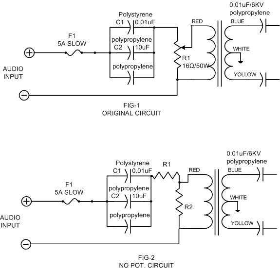

Although the 'Williams Audio' schematic is incorrect for the Acoustat "C" version, and your correction is closer, it is still not 100% correct.
The capacitors should come first (in series), and then the entire 16-ohm resistance to ground. The HF transformer is then fed off a tap somewhere along that resistance, depending on the desired HF balance. Typically the 16-ohm resistor is split 6-ohms at the top, and 10-ohms at the bottom. But these values will vary depending on your desired HF balance, as long as the total is approximately 16-ohms.
If this description is not entirely clear, I can sketch a schematic and post it. This is a definite improvement in the speaker, and considering its ease of installation and low cost, it is highly recommended. There should be some resources available on www.audiocircuit.com explaining how to do this modification on a wide variety of interface models (both rotary and slider-type HF controls). The original factory implementation of this circuit used a 47-uF NP electrolytic, but I would recommend a polypropylene.
if the 16 ohms is connected one side to GND and the other to the capas, using the tap and connect it to the trafo red wire is like having a resistor is serial and one to GND. is like the drawing i attaché.
Williams,
Correct. And with R1= 1ohm and R2=15ohm you match the parts values that you have in your interface boxes now.
Also, notice that since they are in series, it does not matter if R1 comes before or after the capacitors.
I left it before the capacitors in my earlier post(#16) since that is the way your interfaces were already wired.
Changing the 15 ohm resistor connection was all that was required to achieve the Acoustat "C" version.
It may not by 100% the same physical layout as AcoustatAnswerMan mentioned, but it is electrically 100% the same, and that is what matters.
I hope I didn't confuse matters by trying to minimize the number of parts you had to move in your interfaces.
