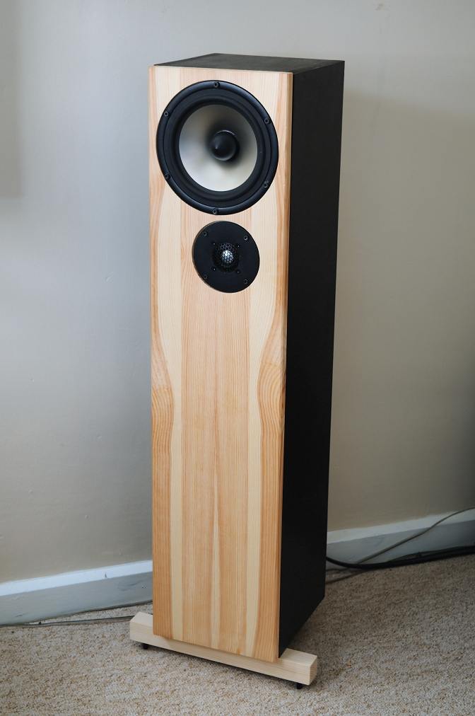

Hi guys,
Seas W18EX001
or
Accuton C158-8-085
This 2-way, closed box, active loudspeaker will use the Transducer Labs N26CS-G tweeter , and will be my Center channel in my music/HT system. It will play down to 70-80 hz, then the sub kicks in.
This is a picture of the possible digital crossover at 2 khz
Pros and cons of the 2 midwoofers? Which one could give me better details and voice rendition?
and final question.... keeping the same tweeter, and considered the power and flexibility of such x-over solution (note the steepness), would you dare a 8 inch driver? (of course at a lower x-over point) .
I thought about W22EX001, or Accuton C220-6-221 but last one has a huge distortion spike at 900hz. The motor of this driver is nothing special, and it's sure far away from the performance of the wonderful C220-6-222, which is out of budget.
Comments appreciated...

All of accutons drivers with ceramic motors are lacklustre and simply not worth using IMO. The SEAS in the other hand is a different story offering exceptionally low distortion, especially in the bass and lower midrange. With still excellent performance up higher.
Really it needs a crossover lower than 2kHz though to avoid its third order distortion peak. A 4th order acoustic target at 1.5kHz would be far more suitable.
Both drivers use rigid cones that should be purely pistonic over the range they are intended to operate over. The SEAS will have the lower distortion/better linearity so should theoretically provide you with the cleanest more detailed sound.

Thanks! According to this well-known test Midrange distortion test , the Seas it's the best in its class up to 1200hz. What do you think? May I cross my TL tweeter so low?
Please note (in the pic above) the crossover design is different from any traditional analog design.
The alternative could be a Satori, which is a gorgeous speaker, even the new bigger one 7" 1/2, but I think that rigid cones (metal. ceramic...), combined with superlative motors, if properly used, have a precision that no paper cone can match.
My only doubt about the Seas concern the Qms, pretty low. As far as I know, low Qms driver may be not ideal at low listening levels.
I'd recommend the L18 (see below); it's an excellent driver, especially at low levels...
If you use a fourth order crossover at 2k, it's distortion peak at 2.3k will be inaudible. The W18 has a distortion peak at 1.6k, however, there appear to be many successful designs using this driver at 2k+ x/o frequencies.

The rise in response is exaggerated in SEAS's graph. Distortion is very low up to 6k.

Hello guys,
I update my old thread and share some impressions.... I bought a pair of Accuton 158 used. So the bargain that appeared online decided for me in December...
I'm really satisfied!!! I'm using them temporarily in a cheap cabinet, but sealed, 12 litres, and carefully stuffed in order to absorb the backwave. The tweeter is also cheap, but I'm upgrading right now to the very high value Seas 27 TBC or TDC (soft or hard dome). (I don't trust much in cheap hard domes, I think that hard domes require state of the art motor and dome material in order to not "hiss", so I will probably go for the soft).
Biamped, crossed at 2800hz, EQd and room corrected via FIR filters. The results are incredible, given the limited Sd of 113 cm2. Of course true lifelike drums requires more serious woofer, but properly EQd, they go incredibly low, very satisfying for bass guitar for example.
Below a pic of the FR in room:
They are in a HT system, and thanks to the DSP, I made a lot of test and comparison. The actual Center channel (also temporarily) is a Yamaha S55 (stuff that I had...). Well, even though all speakers benefit of EQ and room correction, if I swap the left and center channel, the difference in clarity of the dialog is astonishing!.
That's why I changed my plans and now I want to build immediately a definitive center channel.
The Accu 158 is an obvious choice, but I'm considering the Seas W18 now and a tweeter that can be crossed very low, such as the SS 2905 9700 or the aforementioned Transducer Labs in ceramic.
The reason is also that in future the Accuton C158 will be the midrange of a 3-way system, while I would prefer a 2-way for the center, 1 excellent and bigger midwoofer+tweeter, (no horizonatal MTM design to avoid comb filtering issues when not perfectly in front of the speaker).
The W18 is just a bit bigger, an 8" is tempting but more critical in the midrange area.. What about the Seas W22? Does it make more sense than the W18 in a Center channel? The Accuton C220-6-222 would be my first choice (the "good" Accuton with great neo motors), but way too expensive...
One last comment about the low frequencies... I also tried to cross to the sub B&W 610 at 80hz. Of course I made a perfect integration thanks to the unlimited DSP possibility of Audiolense. Furthermore I used the same target curve, so I gave the same roll-off depicted above to the 2.0 and 2.1 in order to compare apples with apples..
Well, the 2.0 wins for clarity. The B&W 610 makes a "whooump" sound when the strings of a bass guiter are pitched. Of course it guarantees much higher SPL, but there is no good sound quality.

If used correctly the SEAS magnesium excel drivers sound sublime and also have excellent bass output for their size.
I have only used the W15CY001, but really they are all the same, just with more demanding requirements the larger you go.
To make the most of them you absolutely have to cross over low enough so that the third order distortion peak, due to cone resonance distortion amplification, is put to rest. With the W15 this requires a lower than 2k xover point and a steep filter.
With the W18 it's even lower. It's breakup is at 5kHz. Really I'd want to cross it at around 1.2kHz with a steep filter. As expected this would require a very robust tweeter. I'd guess that the DXT tweeter from SEAS could do it, in fact I have done a design crossed this low, the caveat is that the design is never played particularly loud so that relaxes the demands placed on the tweeter somewhat.

Hi 5th element,
always very helpful! Is this steep enough? 😀
Decision made, Seas W18! Not sure about the tweeter... I read some conflicting comments about the DXT, which would be great about dispersion as a center channel, but the diffraction used to get it, may create some strange time domain bahaviour.

read good things about the C158-8-085 which is a step up in design to the 6 ohm version with decent motor/hybrid magnet system. You could almost call it the (relative)bargain of the Accuton range.
Yes Bill, exactly! It has a new motor and new suspension, it's not in the class of the neo-underhung motors, but it has outstanding clarity and definition in mid-bass and midrange up to 1 khz.
Also consider that in my setup the equalization implies high excursions, but the midrange doesn't seem to suffer at all.
Since I don't like the "hissing" tweeter of the Yamaha S55 temporarily paired with the Accu, I pushed the crossover as high as possible, and I must say that at 3 khz instead of 2.8, the upper midrange becomes a bit edgy, even though my digital crossover are incredibly steep!
The reason is that the x-over is actually pretty shallow in the cross region, that's why if crossed at 3 khz, you intercept some of the nasty distortion whose peak is at 4.1 khz.
My guess is that the better Accutons, the 7" neo which cost the triple, shine especially in the 1-2.5 khz band.
Anyway the 158-8-085 can go very low (of course at moderate SPL), and sealed and EQd, is a great midwoofer for a 2-way system in small to medium rooms. Lots lots of definition without edginess

And you are probably right if you are referring to models such as C173-6-191, which I never heard, but I would not be surprised if someone says that it shrills...
Rigid cones and domes require outstanding motors with extremely low HD, otherwise they shrill!

The Mundorf kit, I've never seen the c158 crossed that high and so close to where you'd need a notch filter
Bill,
If you are looking at the specs from Grant Fidelity I think they were clearly cut/pasted from something else. Those specs claim 1st order and 3,450 Hz, which doesn't match up with the pictures of the crossover or the layout. Based on my memory of seeing it person, online pictures and the Mundorf docs, I believe the actual topology of the HP filter is very common 3rd order with padding resistor.
A quick simulation via XSim using the Mundorf crossover layout pic puts the electrical high pass filter at 2 to 2.5kHz with a 4 dB bump at around 3.2 kHz.
