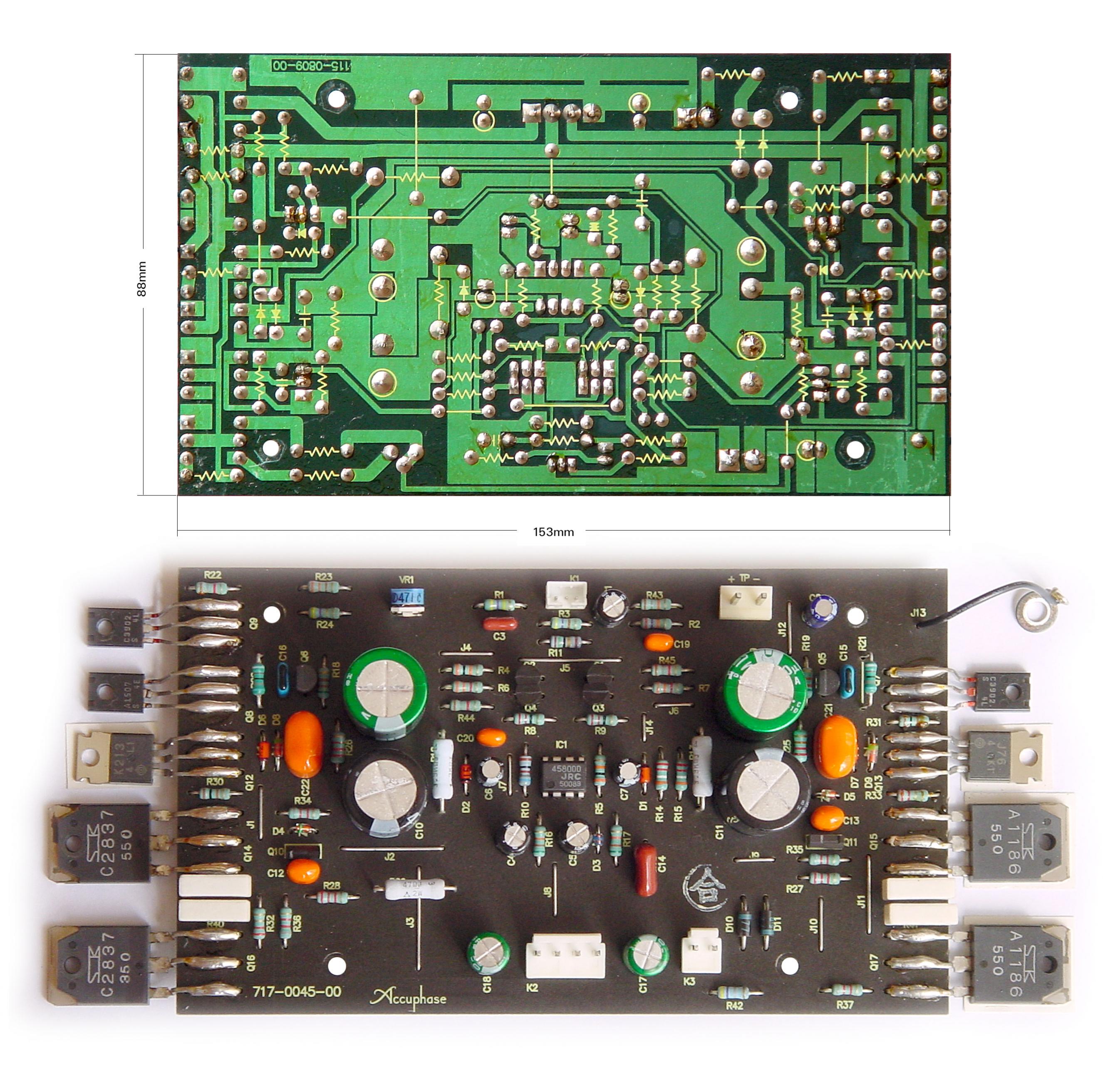

Here I start with the original version. Direct copy of the golden voice E210 PCB. I've done a lot before. They're all given away.

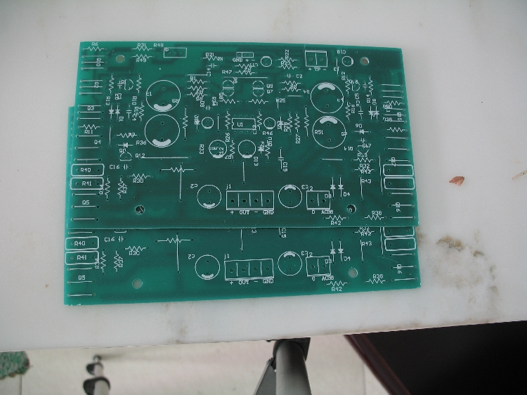

This is a circuit board improved by LJM.
Basically, the appearance doesn't show the same thing. But the selection of components and the measurement of amplifiers. That's the key to the amplifier.
Pursuing the appearance blindly is the same as the original machine. Personally, I think it is meaningless. After all, power amplifiers are used to listen to, not to see. It looks good and looks like the original machine. It's no use at all.

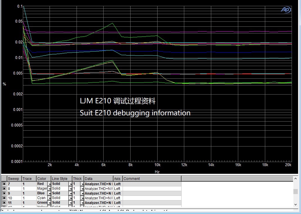

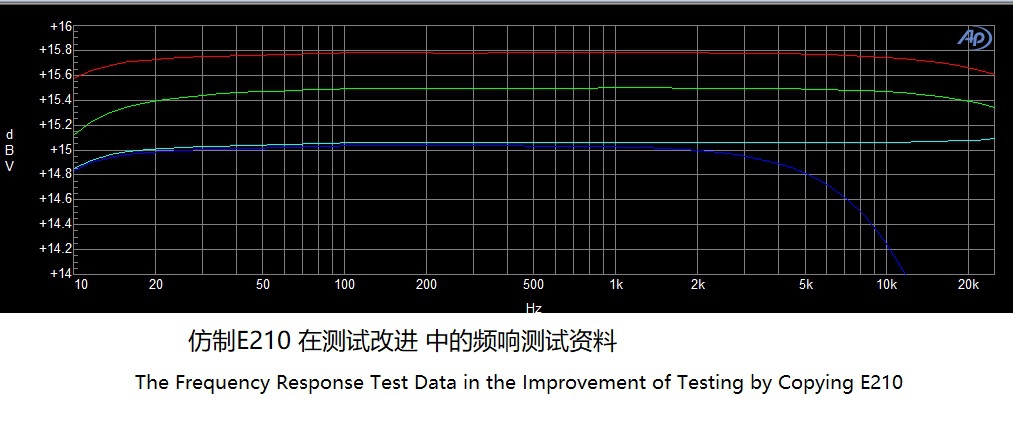

In the process of debugging, many problems will be found.
After all, this is imitation, different PCB, different components, so the same circuit structure will not be completely suitable for the best performance of the circuit.
Send some pictures of the debugging process.
Basically, each line represents a process of optimization and improvement.
Whether it is frequency response, distortion, dynamic distortion, even if the circuit is unchanged, the optimization of parameters can also improve the performance ten times, or even a hundred times.
So imagine those who download a circuit on the Internet. It can be said to be a DIY imitation of a certain machine, almost equal to substandard products.

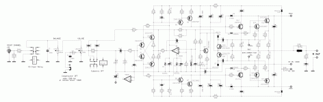

Im wondering about servo amplifier diode D1 marked RD 8.2 , are two diodes in anti paralled coupled or only one zener 8.2 on card marked.

I didn't use this 8V regulator. Take. Delete directly.
I don't think it has any practical use.

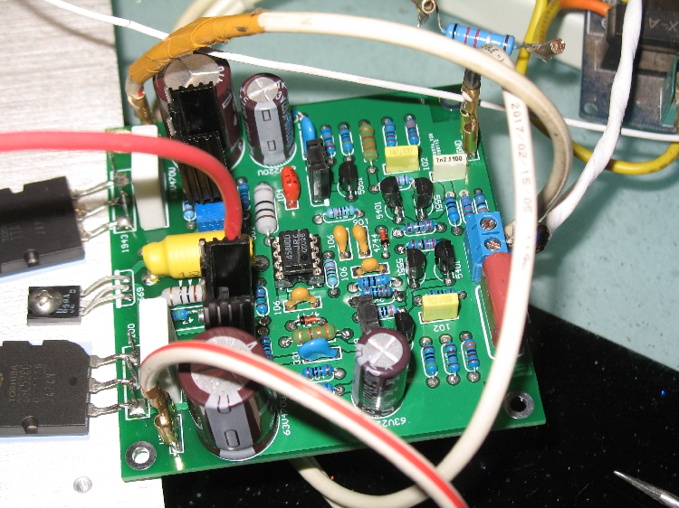

I had no problems in the test. This is my newly revised version of the photo.
External supply of AC 36 v uses in original,its different hear and not used .
regard alcroner.
Because of driving transistors. The MOSFET is not installed together with the output transistor.
So I cancelled the 4.7R resistance. Single small radiator. It can make the transistor work stably.
In the test. The static current is affected by temperature and the amplifier works for 10 minutes. Basically, it remained stable. It will not increase or decrease.
In addition, I reduced the number of input RC.

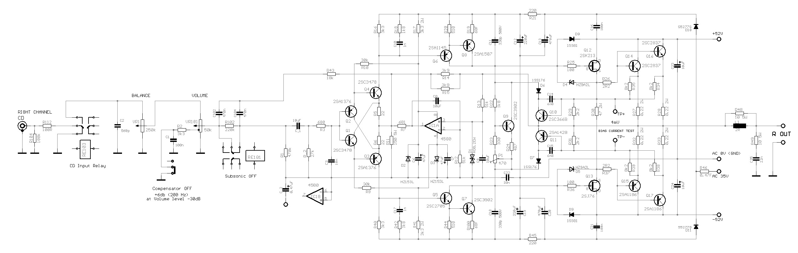

I think the circuit diagram may be wrong, although it was not drawn by me. The brochure is provided by Golden Voice.
But I think it's still wrong, maybe deliberately.
If not changed. Then you can't hear a voice greater than 10K.

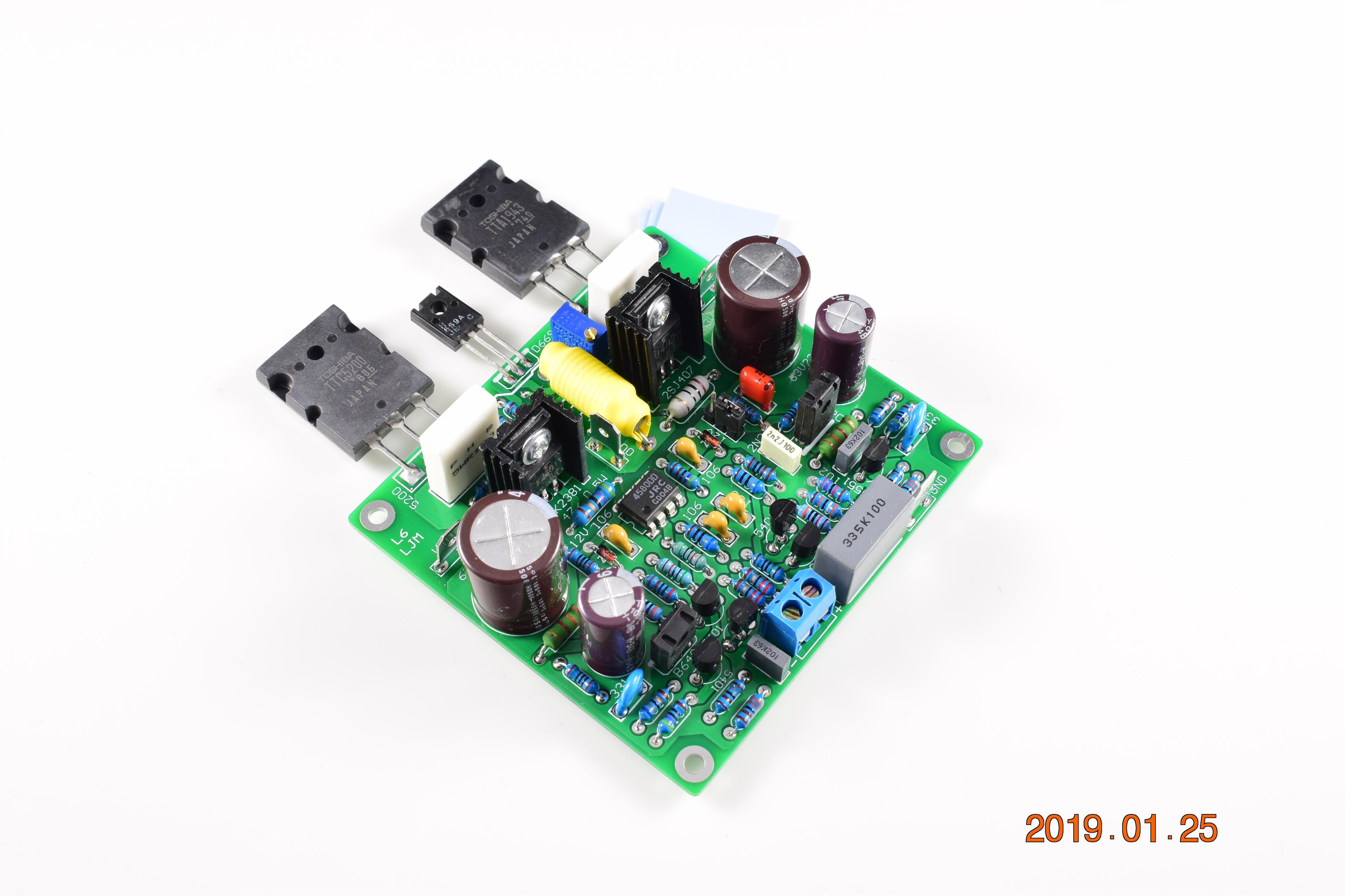

Recently bought two boards LJM E210 as in post #5.
Both are unstable and begin to overheat in 3-5 minutes after switching on (input terminals are closed).
Power supply is +-48DC.
Please advice
Yes. No mistake. E210 has a high calorific value.
Large radiators are needed.
3KG radiator is recommended.
Or turn the adjustable resistance counterclockwise.
Please advice
Compared with. L20 or L20.5, the fever is smaller. The performance is very good.😀
