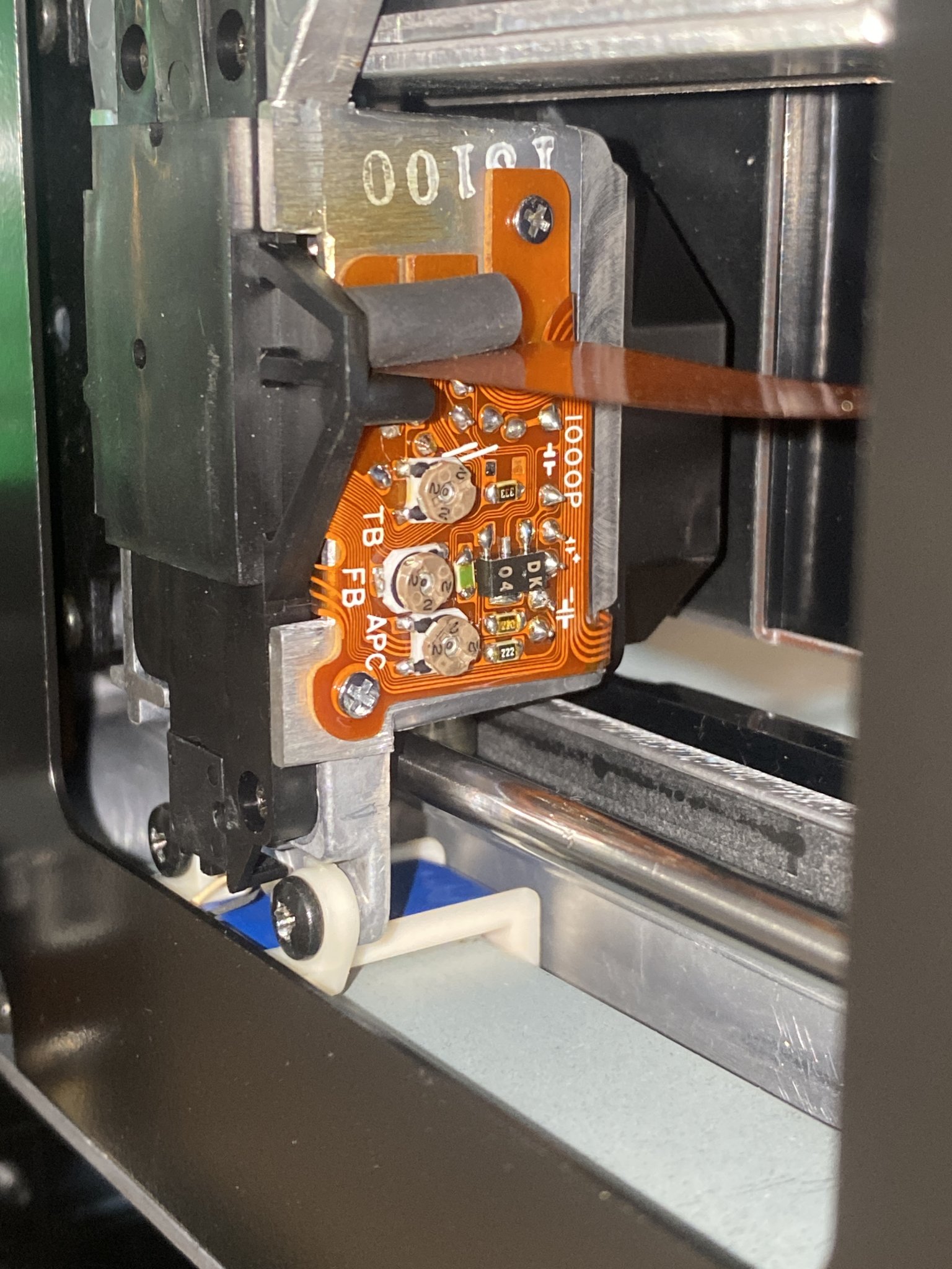

Hi Community,
I’ve recently acquired this amazing player in an almost perfect shape where the vast majority of my CD collection is read perfectly and track skip usually happening in a couple of secs.
That said there is an handful of disks that, despite their TOC is read in a glance, the first track takes forever to start.
Lens has been cleaned, linear guides have been greased but those few CDs really hurts.
I’m keen to think of the focus bias non being perfectly set but given the lack of a service manual I can’t even look for the RF pin
Any suggestions? On the pick-up I see the typical APC the TB and the FB triggers.
Thanks for any hint you’re willing to share

Hi all, I was able to spend a little time looking at the servo, taking pictures and making some measurements. This might eventually help others as well.

Pickup (KSS-281A) close-ups

Sorry, but RF signal is not clean, it is noisy top and down sides. I've seen cd laser faults, and even today I don't have clear when a laser diode is working well or not. A laser diode faulty can be caused by a lot of causes. A laser diode can provide laser power, but can be cause a lot of phase noise. A laser diode must have a good spectral and phase. Sorry for the speech...
Maybe your laser diode can be solved adjusting its potentiometers. I've seen that these tiny potentiometers are not stable in its values, it have some value drift in time, so, maybe it only needs a adjust.
Its value are 2k2.
These potentiometes are very hard, tough to move. I'd replace it for another ones more easy to adjust.
I've seen in some Sony Kss lasers that the lens must be re adjusted in its position, it occurs because plastic pieces deformed thorought time. It is not easy to adjust it.
And finishing, for to be sure about laser power, a laser power meter is imperious. Indirect measures are not trustworthly.

First of all, I'd try to adjust, but with other kind of potentiometers. This potentiometers can be suitable for it:
https://es.aliexpress.com/item/1005005310181385.html
It should be important to take note of APC potentiometer value, for to remain laser power value. I see in the pictures that to take an adjust procedure is viable with care, even with the cd player in horizontal. It is not easy, but not impossible.

Many thanks @ManoloMos for your recommendations!
I've made some progresses today by applying with a brush a deoxidising liquid on those three trimmers and by changing the FB I've been able to get those few CD not starting to be played. However the performances in terms of track jump and track start are not as good as with the other CDs. So the problem has been vastly mitigated but there is still room for improvement.

Interesting thread and a nice player 🙂
Could I just offer a few thoughts...
1/ When viewing the RF make sure you use the correct ground point. Chassis ground often doesn't cut it in terms of noise, you need the correct ground used by the RF amp. That could be IC27 on your pictures (an SMD chip under the board) and there is an 'A Ground' point next to your RF test point. Make sure you don't create a ground loop with the scope (measure for any voltage difference first before connecting) as some players use a virtual ground for the RF amp that could be floating at 2.5 volts dc. Unlikely but check.
2/ Typical RF amplitude for most players is 1.2 to 1.5v pk pk as a generalisation. Make sure your probe is correctly compensated as any error here will greatly alter the amplitude you see on screen if using a divider probe.
3/ FB has to be adjusted for max amplitude of the RF and the clearest 'diamond' in the RF pattern.
4/ TB (or E/F balance) should be checked (again a generalisation and not model specific) by looking with the scope at the tracking error waveform. Slow the timebase down and then jump tracks from an early track to one nearer the disc end. The waveform will change but should appear as notionally symmetrical above and below a 'zero line' through the middle. If it seems to be asymmetric and shifted above or below this imaginary line as the player is performing the track jumps then the balance should be adjusted. Try both AC and DC coupling on the scope to get a feel for how it looks.
Do not use any CDR or RW for any adjustments no matter how good they may appear to be.

The DP-70V was released in two versions: one with KSS-190A and one (newer) with KSS-281A with RF amp embedded on the pickup. The DP-70 is an older model using BU-1CThere is another issue, when I look information about your Accuphase DP-70V. If seems that DP-70 without V has a Sony BU-1C laser pickup, however your DP-70V has the KSS-281a. But, however, your mechanism is similar that used BU-1C and KSS-190A mechanisms.
As written in post #6 I've been able to unblock the trimmer placed on the pickup PCB and to slightly adjust the FB to ensure the CDs that were creating issues were "somehow" read.But, let's go to the problem and the most viable solution. As you can see, there is no other adjustmensts that the tiny potentiometers. These tiny potentiometers has a drift over time. If you can adjust it, I think that should be enogh. The problem is that these potentiometers are tough, I'd recomend replace. But you can try adjusting Focus and Tracking Bias.

Hi all,
I've been able to complete during this holidays the DP-70V servo board recap and to better tune TB and FB.
Despite the recap has lead to better numbers with regard to ESR and VLoss, and the TB and FB recalibration now grants the TOC to be read in less than 2secs for all CDs of my collection, I still face troubles on reading the first track of <1% them (actually 1 CDs out of more than 200).
For posterity I confirm that whilst the APC trigger change is immediately reflected in Vp-p value change (goes up to 1.8V), the FB and TB changes have very little impact on the FE and TE traces. I also confirm that since the player doesn't like at all to play CDs upside-down, making live changes to FB and TB while playing a disk and watching the scope has been impossible and I was only able to tweak these triggers my "assessing" the final on the 1st track reading capability.
After tweaking the "offending" CD's TOC is read instantly but the RF trace is more blurry than other making me thinking that either the substrate is "somehow" disliked by this player or, as described by @ManoloMos , the pickup is within a certain degree "compromised" (although the neglectable percentage on which the issue occurs over the collection makes me favour the first idea of disliked substrate).
Finally It's worthy reporting that this behaviour is random and only affect the first track: playing the 1st track could take from 2 secs (best case) to 30secs (worst case) as if the track start is not "found"; more "external" tracks are instead reach consistently under 3 secs.
Being not able to improve any further the reading of the first track, I consider this case "closed" given this old gentleman the right to dislike a CD or two after more than 30years.

The only triggers I have are those located on the pickup (TB, FB, APC), but given the very uncomfortable position, the magnetic rails opposing a very limited resistance when rotating the trimmers, the heavy weight (~30Kg) and the fact that the player doesn't love to play discs upside-down finding the right values it's ridiculously though.
The PLL adjustment is sometimes an adjustable coil rather than a trimmer which of course is where a service manual comes in.

Since you can't get enough until you get enough, I spent more hours tweaking FB (because I learned that that was a multi-turn trimmer)
in the end I've obtained the result desired! Now all CDs are correctly read with the TOC of the "worst" CD acquired in 3.5s (ref CD is 1.5s) and the first track "usually" starting after 5s (ref CD is 1s).
Thanks to anyone who has contributed to the discussion, hope this could be helpful for others in the future.
Best (ref CD, 1s to first track, Vp-p 1.4V) | Average (99% of collection, 2.5s to first track, Vp-p 1.2V) | Worst (1% of collection, 5s to first track, Vp-p 1.36V) |
