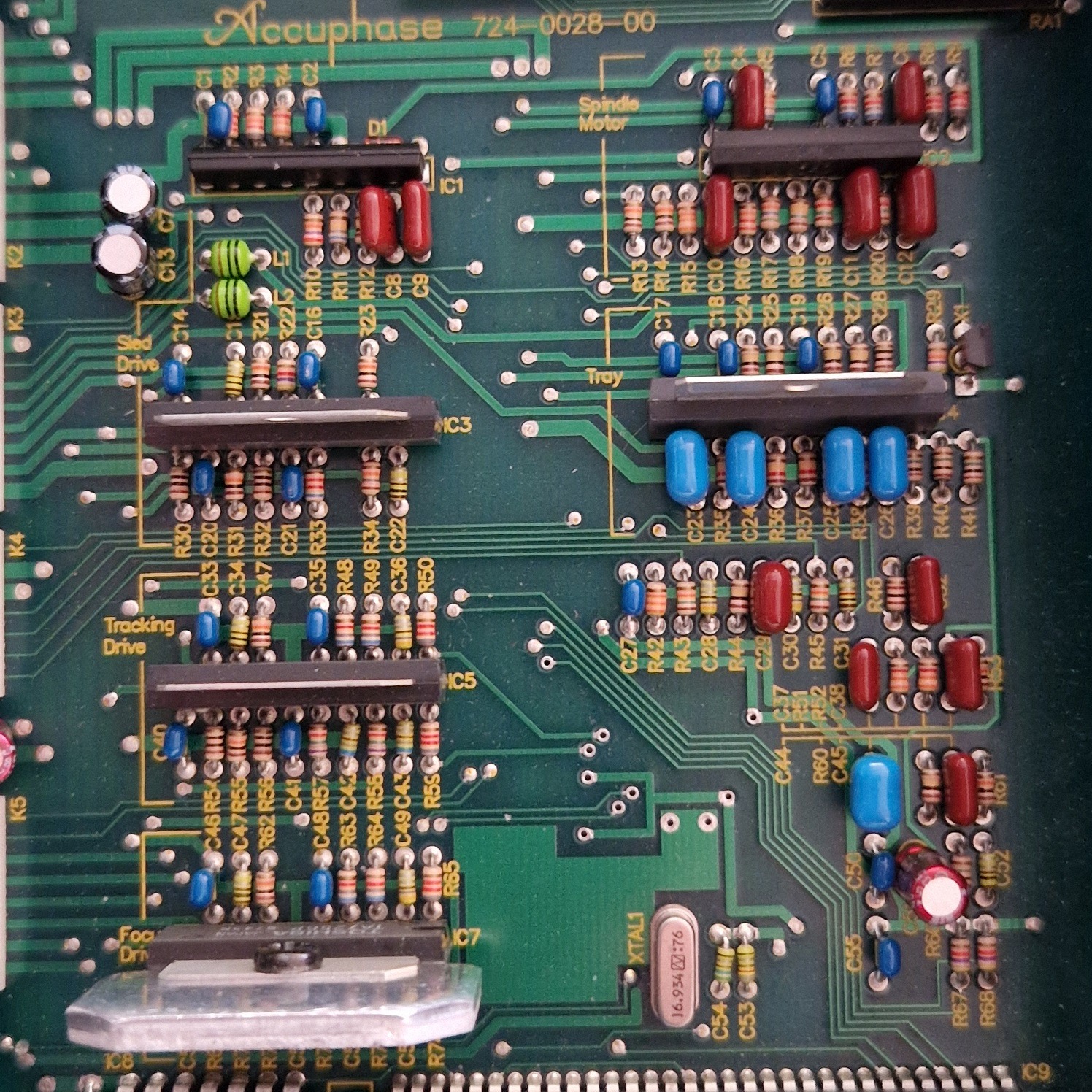

Hola Manolo, el problema es que el cabezal no hace ningun movimiento sobre el carril y se puede mover a mano,sin que se note ninguna resistencia. Cuando al gaveta entra y se coloca en el recorrido final el conjunto cabezal/motor sube por el sistema de leva que lo empuja hacia arriba no observo ningun movimiento del cabezal laser ni de la lente del laser y el motor no gira.

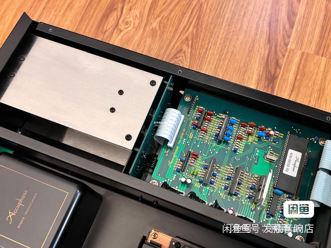

There are not much pictures in the net of this cd player.
The part suspect is this:
https://www.gzhifi.com/ls/images/202303/1679364080592600173.jpeg
As you can see the there are four integrated circuits with heat sink:
It should be one for focus coil, one for tracking coil, one for laser movement in the rail, and another for to open/close the shelf.
But as you can see, there is another printed card below this.
So, check this card and follow focus, tracking, laser ICs signals,
Check power supply of this zone, that is not visible in the google pictures.

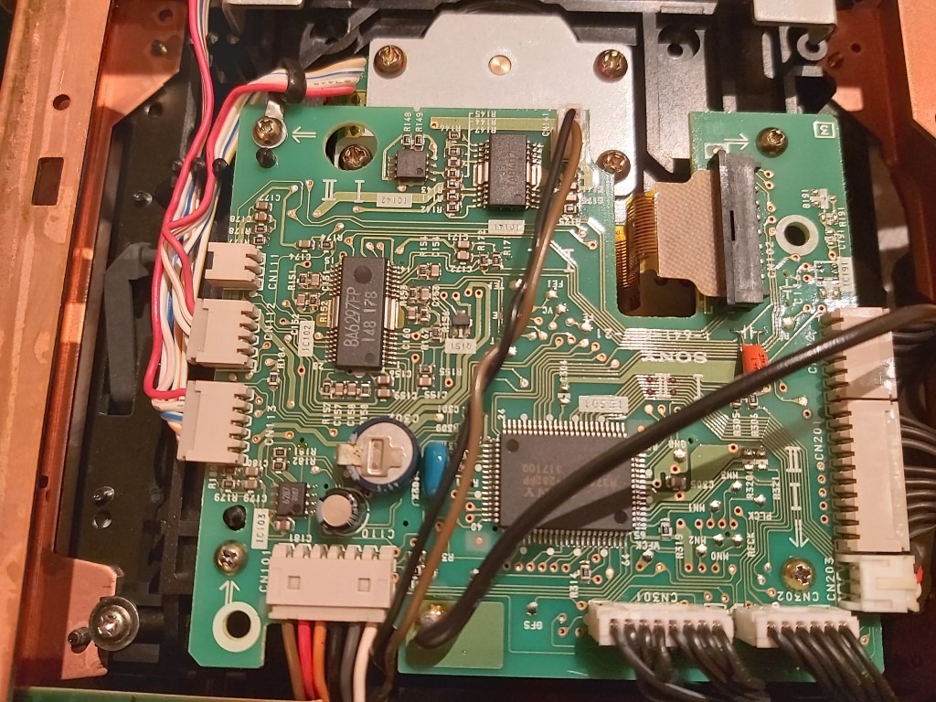

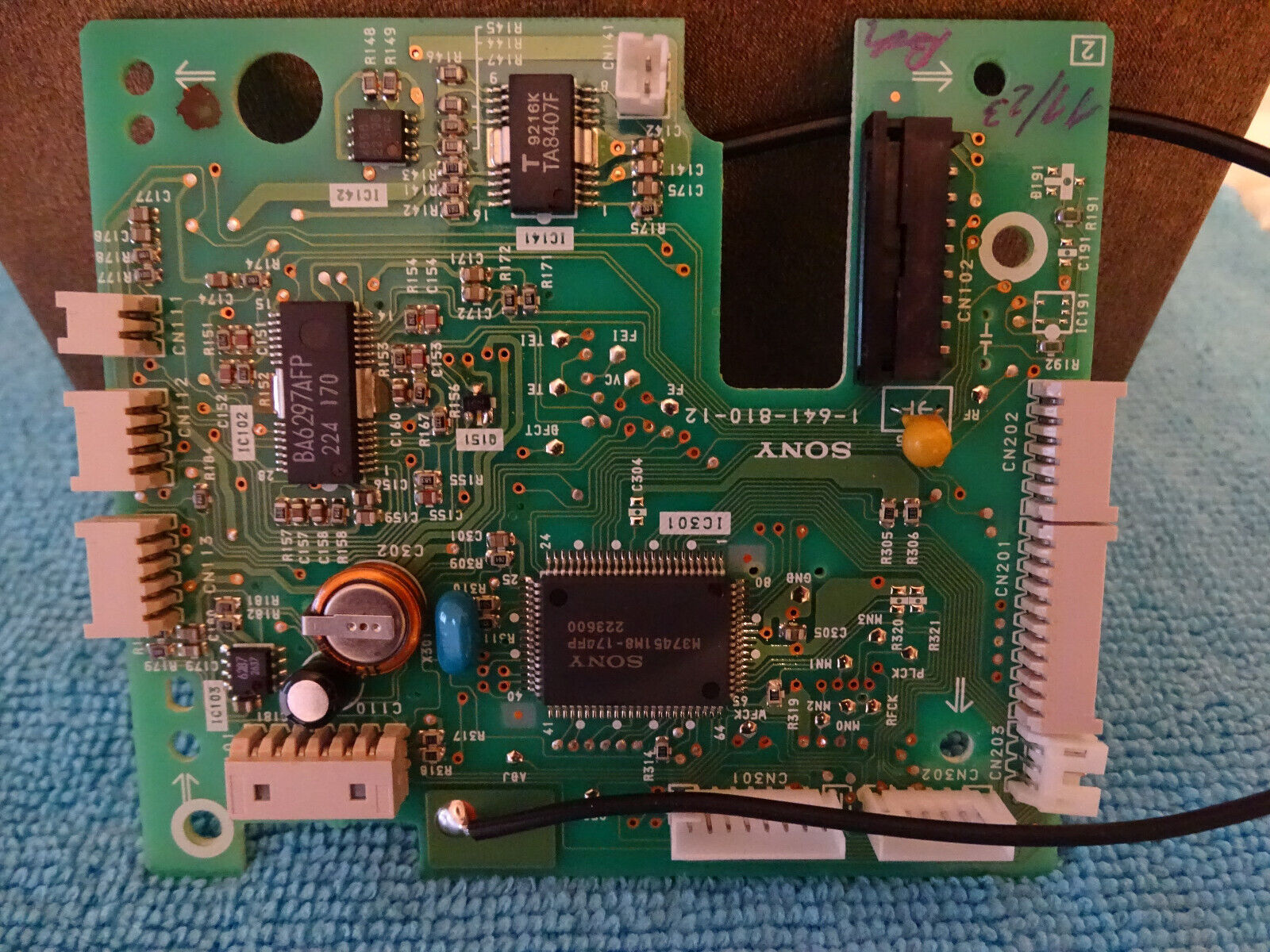

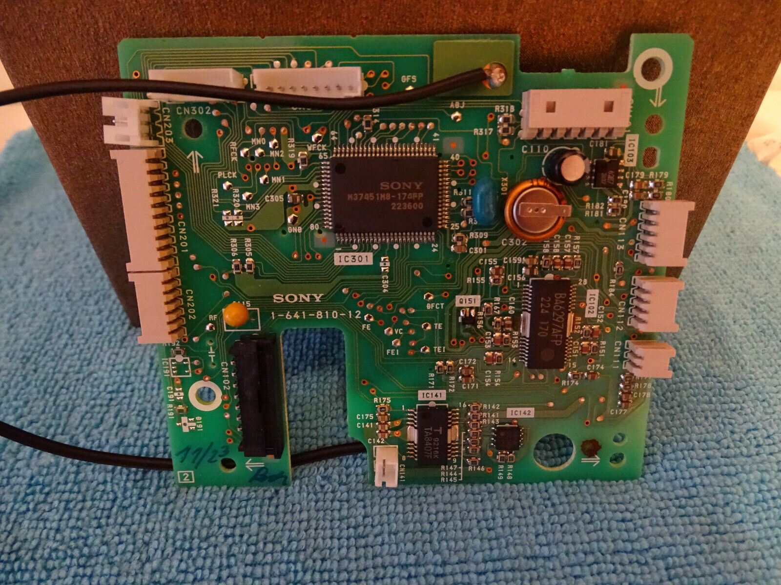

Here is a picture of the Driver board. There is no other board below, the two flat cables at the front go to the front panel and the rear one to an option board to plug in optional input and output boards, which are empty. The integrated circuits for Tracking Drive, Focus Drive and Tray are Dual Power Operational Amplifiers Toshiba TA7256P. The Sled Drive has also TA7256P and a C4570HA a ,The spindle Drive has a NJM4556LD dual operational amplifier.

Hi Eljaro,
I checked the logic board in the DP-55, it is different to the board you provided as foto.
sorry that I am not able to help

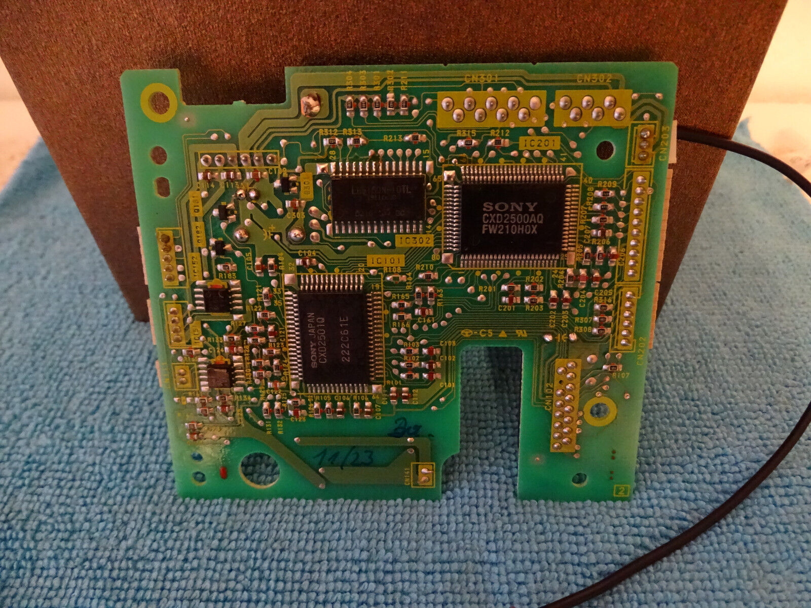

the laser head is the KSS-272A.
Sony's CDP707ES don't use the same mechanism/loader, because the laser unit is here the KSS-190A Maybe you mean the CDP-X707ES.
According vasiltech.ru the Accuphase models DP-65(V), DP-75(V) and Transport DP-90 so as the SONY models CDP-333ESJ, CDP-555ESA, CDP-555ESJ, CDP-777ESA, CDP-777ESJ, CDP-X303ES, CDP-X339ES, CDP-X505ES, CDP-X559ES, CDP-X707ES and CDP-X779ES have the laser unit "KSS-272A" in use.
Check out the diyaudio threads concerning KSS-272A and also the threads regarded the mentioned SONY cd player models.
The main deficiency in this laser unit is the used laser diode SLD-104 and the plastic suspension of the lens due to the short life expectancy.
That's the reason why this laser unit none have been available for a long time and only a remaining stock appears from time to time for a very high asking price.

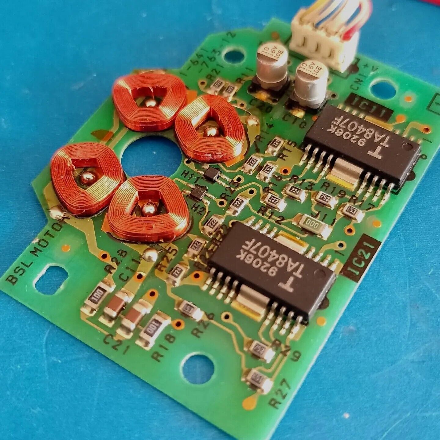

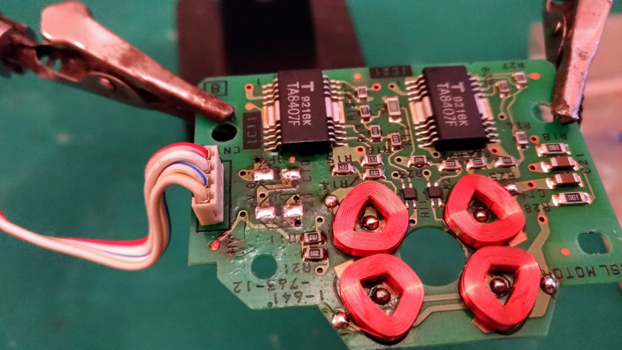

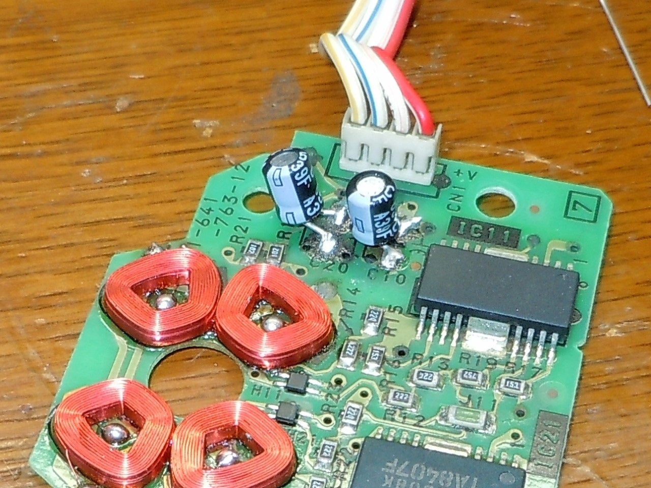

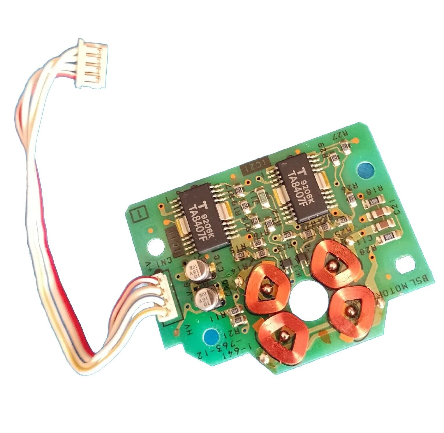

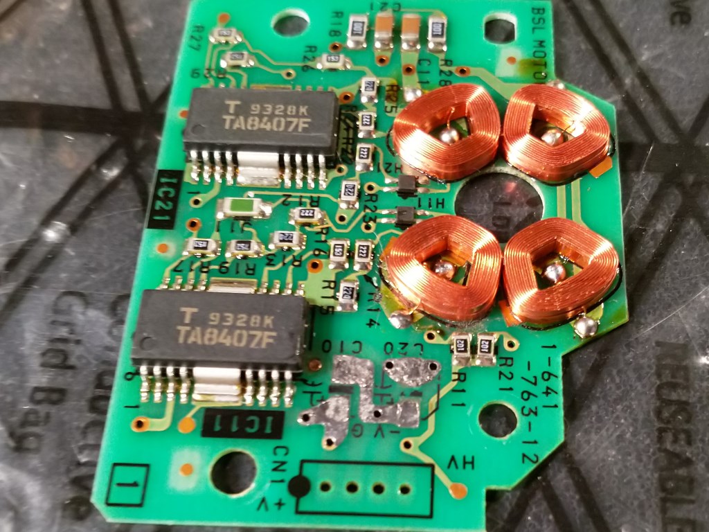

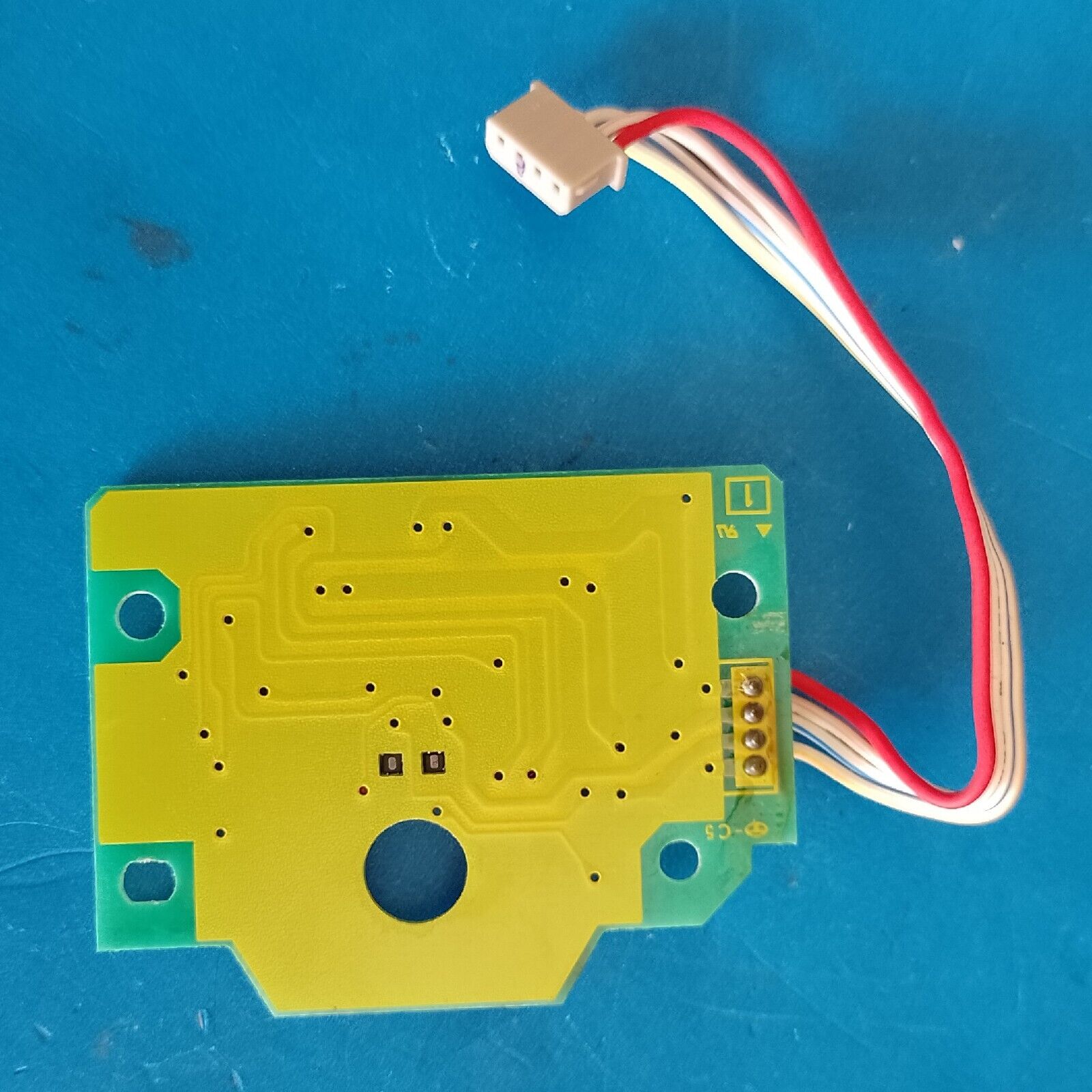

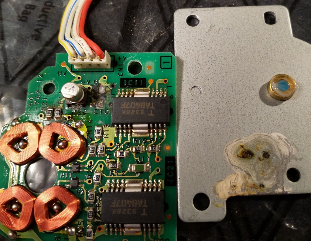

Another deficiency are leaked SMD electrolytic caps on the motor control PCB for the brushless disc resp. turntable motor (please note: this issue is widespread on SONY, including the ES series).
The motor control PCB is a part of the whole mechanism - go to the attachments.
If you buy this unit as replacement part - e. g. under
https://www.ebay.com.my/itm/225616866931
replace both SMD electrolytics against high quality versions before you replace the whole unit.
If leaked material have cause oxidation on the traces try this methody:

the CD mechanism of the DP65V is identical to the one installed in the DP90. I checked the spindle motor separating the metal plate and the two suspected Elkos are intact and measure correct capacity. All Voltages are correct, except ones marked 7 V on the logic board which are actually 8.6V. I suspect a printing error, since the power supply from Trafo to bridge rectifier and on to the Elkos has no faults in its components
Since I have no schematic for the DP665V there is not much I can do. An oscilloscope might help , but with no schematic its impossible to start measuring.
What is the sequence that occurs when a CD is inserted into the drawer and it is drawn into the reader? Should the reading head move first or the spindle motor start spinning first? On this DP65V nothing moves when the CD is drawn into the player.
maybe the service manual of SONY's CDP-X559ES helps a bit.
The SMD caps on motor control board are to be replaced, because by measuring it isn't possible without de-solder to determine the internal resistance.
Both 10uF caps goes from VCC/2 (actually U-ref) to +7V and GND. Best solution is replace by WIMA MKS 2u2 in smallest size.
Power supply version on Accuphase seems to be different but the +7VDC on logic board (servo board) must actually also come (like on SONY's CDP-X559ES) from an integrated (or maybe discrete) voltage regulator.
SONY's Servo-PCB "1-641-810-21" / "1-641-810-12"

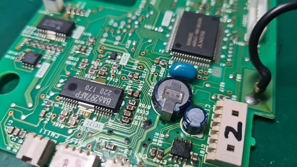

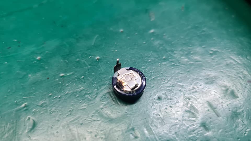

according some descriptions main issue is unwanted corrosion on traces and thus interrupts at the plated-through holes in the areas of elcaps.
E. g. in the holes for pins of C302 (100.000uF/5,5V - go to the attached files) connected on PIN28 of IC302 (S-RAM LH5160TA) and in the holes for pins of C110 (100uF/6V3) so as additional holes in the area of this elcaps.
If this parts already replaced and all interrupts remove without success, it is the best way to replace the whole servo PCB by a version with correct operation (removed from another CD player as a test).
Despite the small size of this servo board, the degree of complexity is very high because many components are soldered on both sides.
Unfortunately, I cannot say how likely the failure rate of the other SMD chip capacitors and chip resistors as well as the QFP chips is.
P.S.: C302 must actually be a memory cap.
In a FM stereo tuner with memory for various radio stations such caps often in use. If loss of memory occurs in FM tuner due empty memory battery or defective super cap a new station seek/storage procedure must be started after replace battery or super gold cap.
What actually is to do after loss the memory on this servo board ?
this video show, that several traces and bonding to other side on this servo board are destroy due oxidation caused by leaked elcaps (4:50):
The spindle motor won't have anything to do with initializing cycle. First the magnetic sled motor has to move the head and laser has to detect the disc for the spindle motor to engage. I have esoteric transport with the same problem area. The head moves half way on magnetic tray and the laser tries to focus outside the disc perimeter. When I move the head by hand under the disc clamp the player reads TOC and plays without the problem. Its a major pita to disassemble the transport to gain access to a servo board and check point and I don't have schematic as well so I'm waiting for a proper mood to dig into it.
Did you check all the micro-switches which are there?
