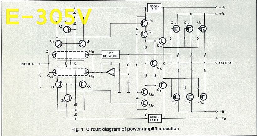

This one I would like to clone:
This circuit needs two power rails, B2 being higher voltage but much less current like 100mA or so. Those duel J-fets are much more rare today than they use to be.🙁
