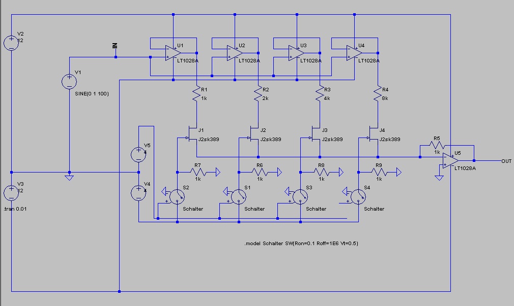

What they do is V/I-convert the signal in 16 binary weighted currents, switch those currents, add them up and I/V-convert them back.

I tought about it a while and came to this solution. It is my guess and what I would start with. I have no clue how similar my solution is to the original.
I attached 2 files: a picture and a zip file containing a simulation file for LTspice and the model fot the jfets.
The parts used and the values are not especially chosen. So it is up to you to choose optimal sounding parts and values. The trick is, that the current summing stage U5 has an input potential of zero volts. Thus the V-I-converts are simple buffers with a resistor connected to the input of U5. For example the output current of branch 1 is voltage V1/R1 and the output current of branch 2 is voltage V1/R2. Both currents flow into the current summing point at the minus input at U5 and then they all together flow into R5, giving the output voltage, which hence is the I-V-converter. The JFETs are used as the signal switches. If their gates are 0V, they are on, if tey are negative, they are off.
Only 4 instead of 16 branches are shown but you can add the missing 12 easily.
Each branch has got it's own switch. Only switch 4 is switched on.
If you want to change the volume, change the settings of the switches.
Have fun.
Peter

Based on pr's simulation model, I would use T-switch structure to replace the single switch for better off-isolation. And preferably go for fully balanced version. In addition it would require some sort of logic to recognize zero crossing from input signal, otherwise there will be annoying noises when switches operate.
