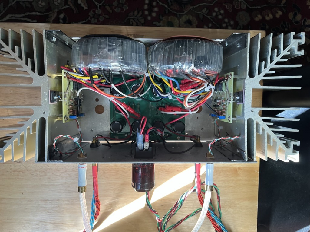

I would pick up a Antek 300va or 400va transformer. I would say grab a second one of those Hammonds and make a dual mono power supply if you had the space but they seem pretty pricey.
Post some pictures of the amp from different angles. Maybe we can give you some tips on optimizing things.
Yes, I would go dual mono instead. Buy another Hammond 182G18 (now 1182G18).
You can stack them if necessary, and you won't be sorry.

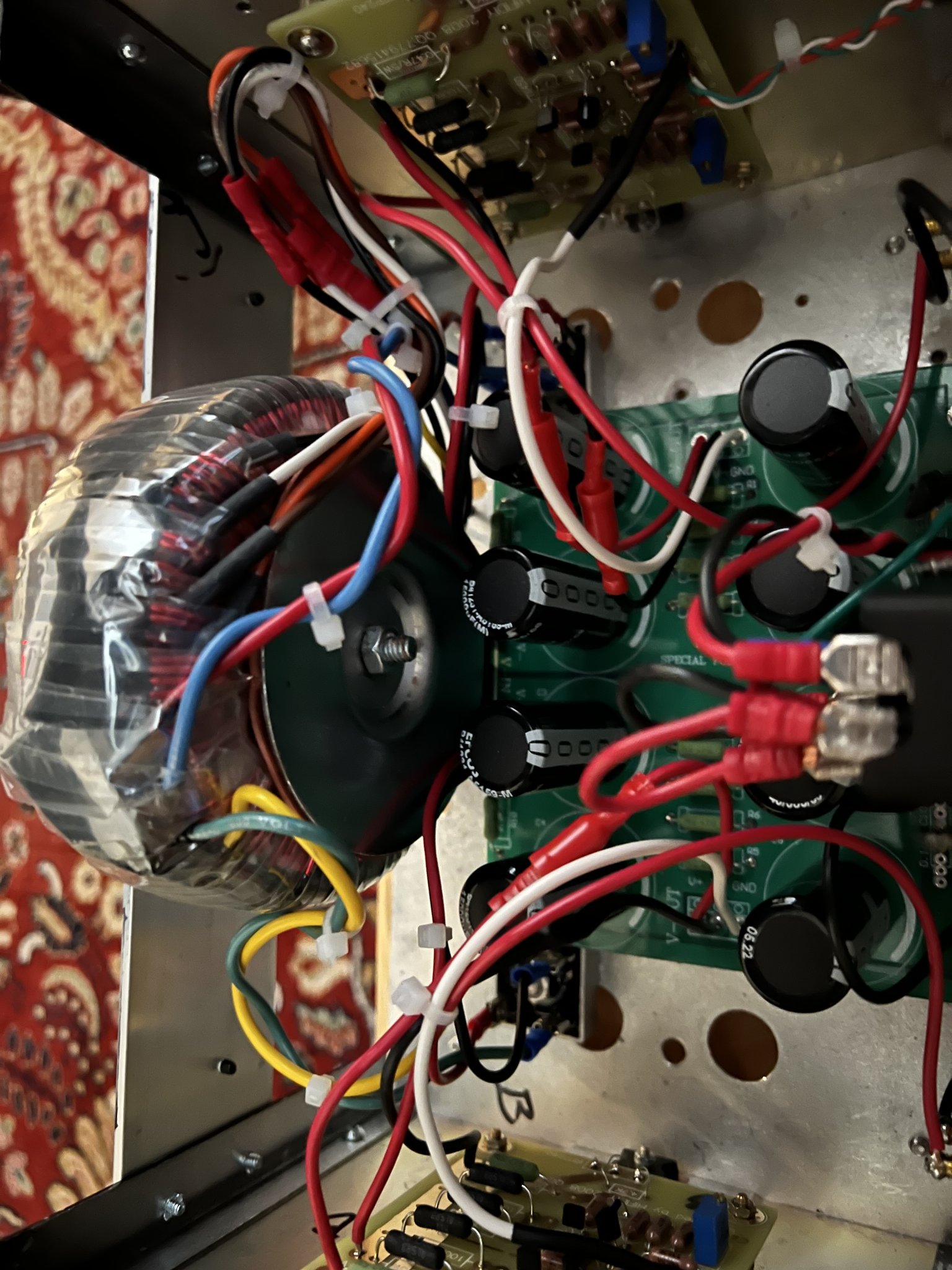

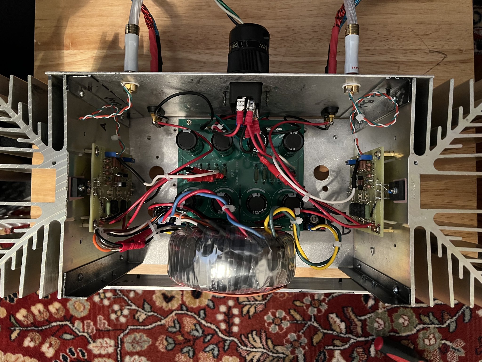

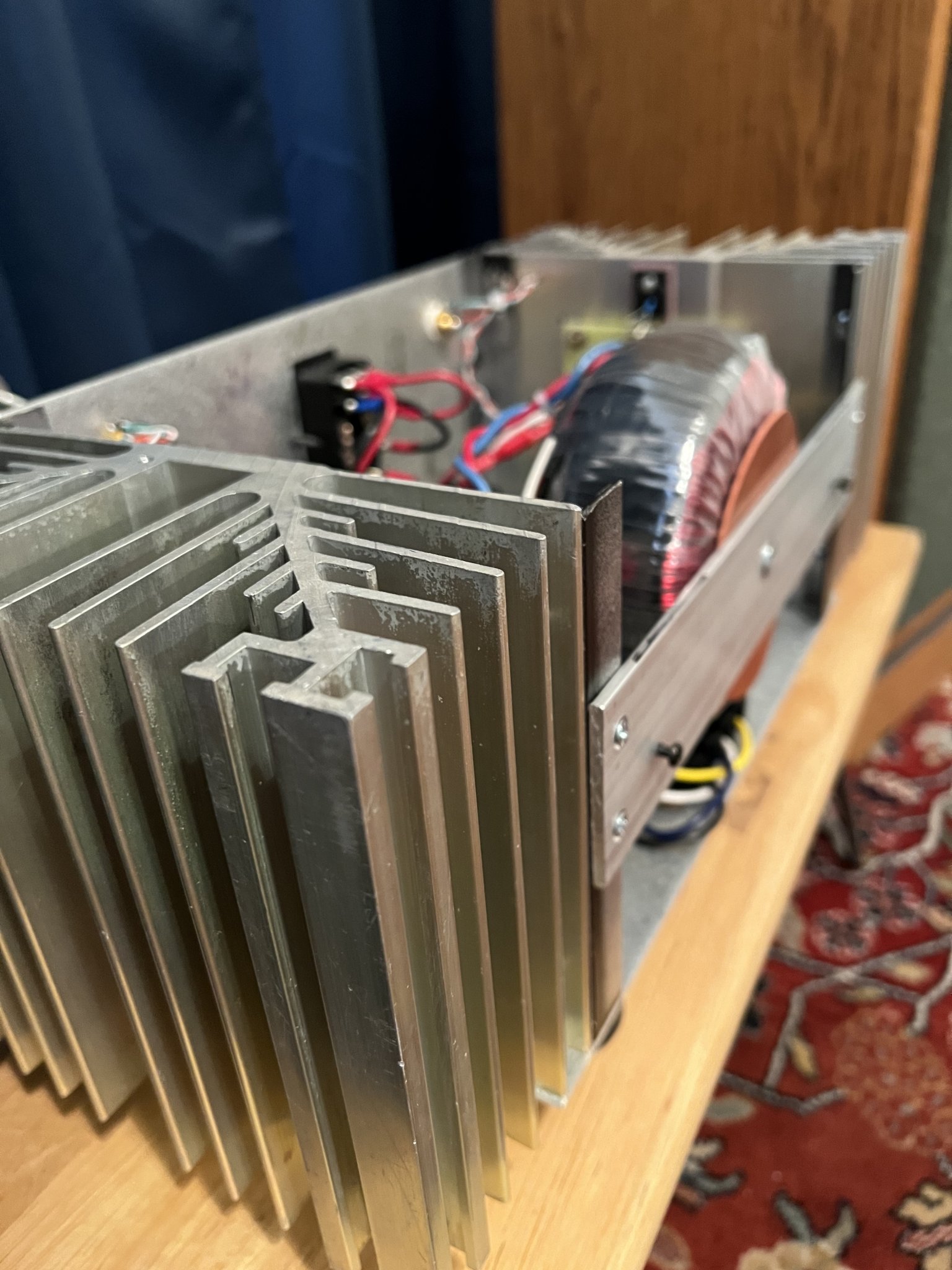

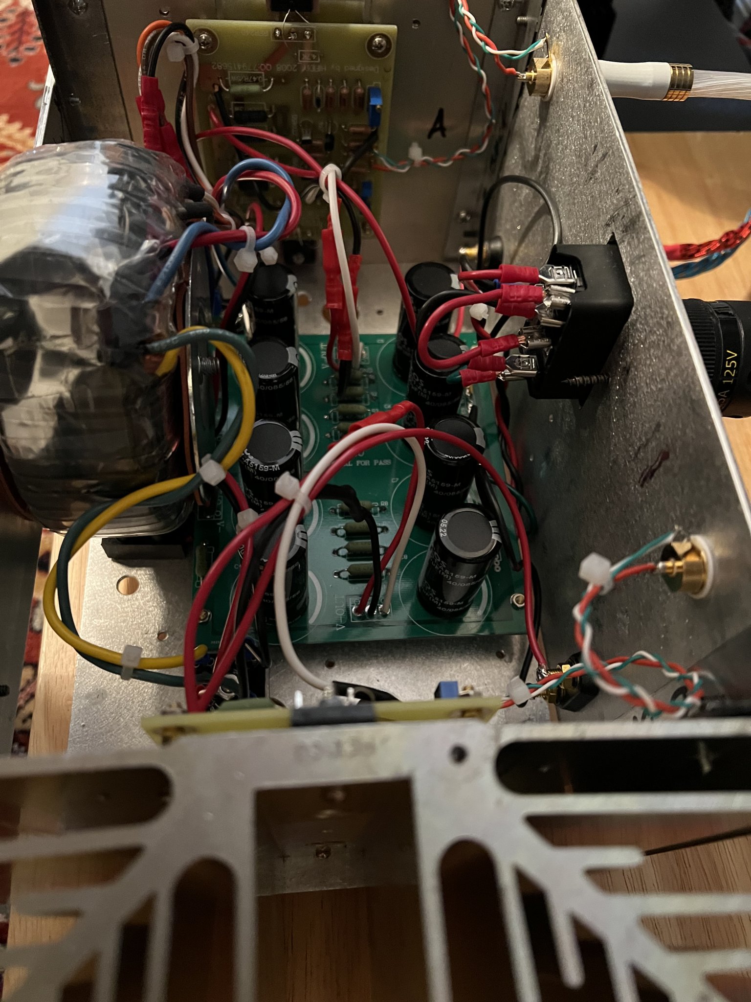

Ok you asked for it. Remember this is a junk box project. I used the framework of another guy's project which was a complete mess but the metal work wasn't too bad. I also had this transformer and the filter caps which saved a bit of money. As you can see, the transformer barely fits in there. I like the idea of stacking another one but the filter caps are in the way. Perhaps I could slide the transformer over and put another one next to it?
Any ideas or observations I'd love to hear them.
A couple quick observations, add a snubber circuit to rectifiers. Also looks like the outputs have some force being exerted on their leads by the PCB. I would hit the solder pads with the soldering gun to free them up a little bit.
Those nordost clone cables are neat. I have a couple that I made up. At the every least they look nice..
It would also be interesting to know which revision of the F5 that is. There have been a few changes.
