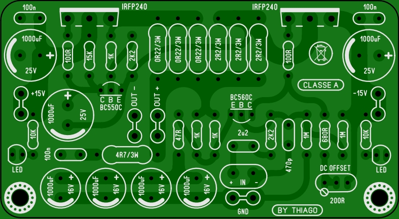

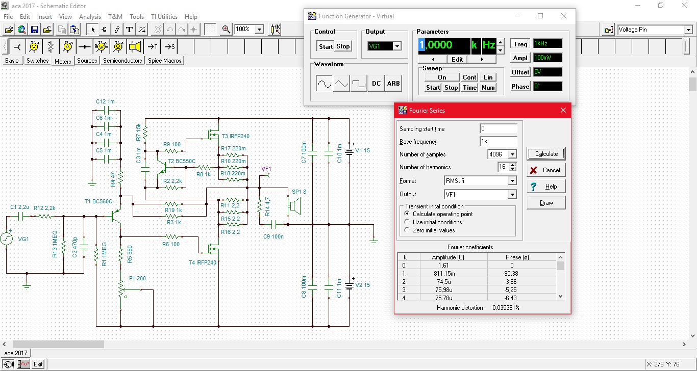

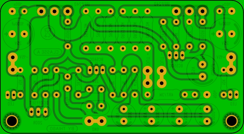

T thiagomogi Member Joined 2013 2017-05-13 4:10 pm #1 2017-05-13 4:10 pm #1 My attempt to make a modified ACA. Any criticism is welcome. Attachments aca 0.JPG 278.6 KB · Views: 279 aca.JPG 287 KB · Views: 263 aca 1.jpg 390.3 KB · Views: 268 aca 2.JPG 407.9 KB · Views: 269 Z ZacharyP Member Joined 2015 2017-05-13 9:33 pm #2 2017-05-13 9:33 pm #2 Looks interesting. Any changes in particular you would like to explain the thinking behind? Status Not open for further replies.
