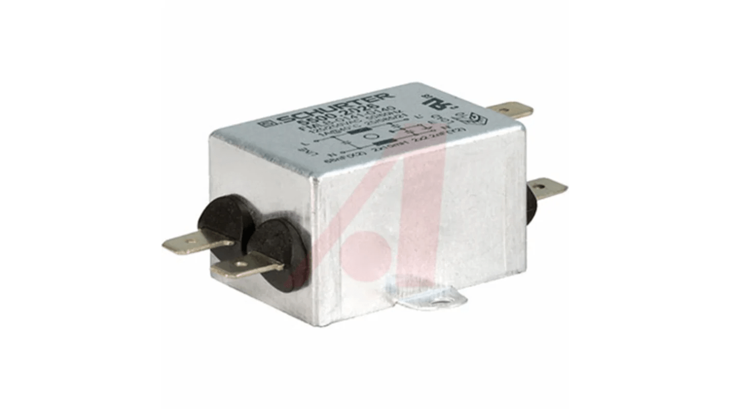

thank you Jon... i want to use a transformer (two in fact) - that is not in question... i want to try it... 🙂 Schurter is also one of my options... their FN2090... but for now, i would love to try those transformers first....
the question is what would be safe from those three options... if any....
