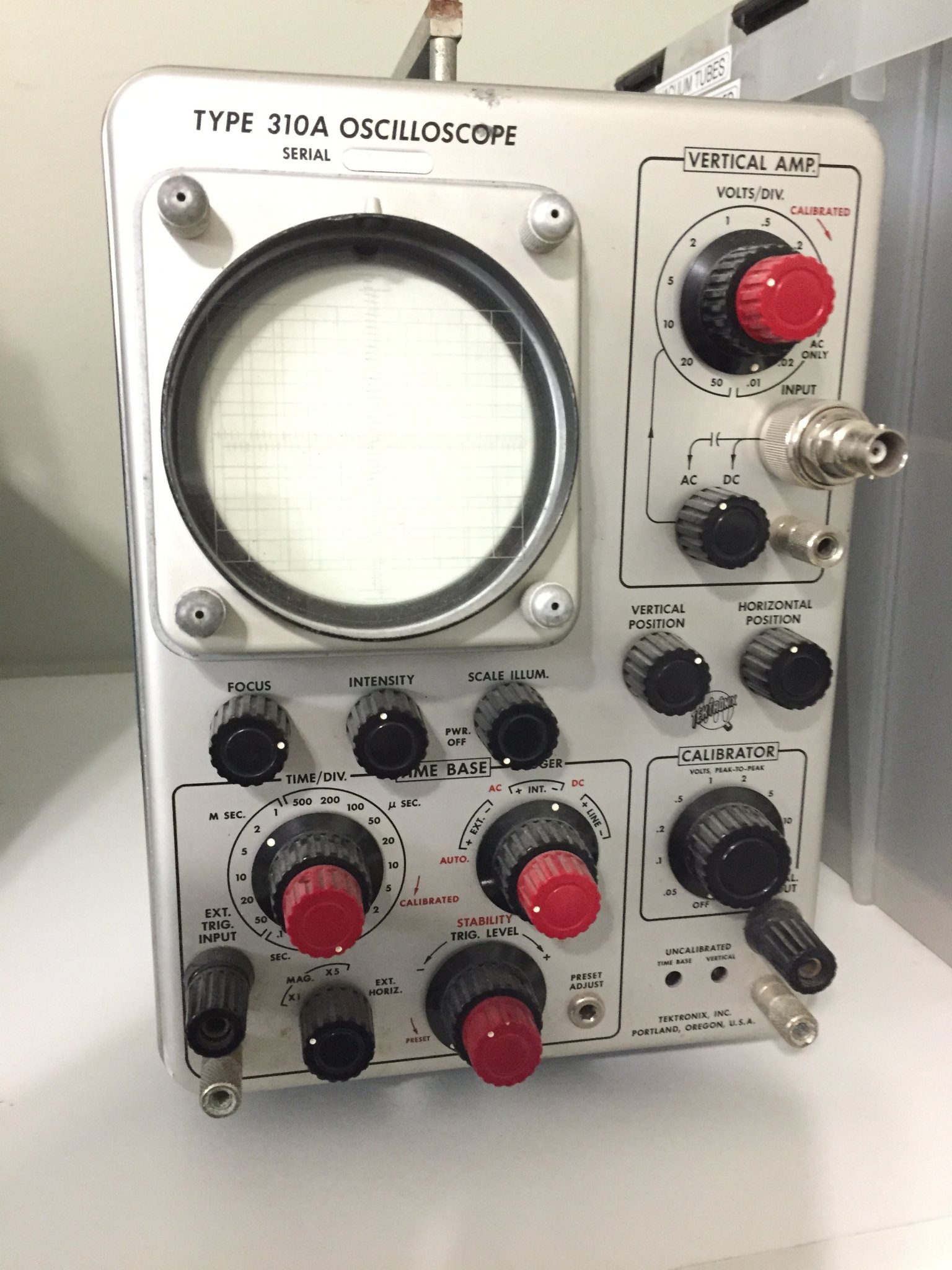

Which TEK old scope is it? I spent 10+ years in a research labScope is my old Tek cathode ray tube
in the 50s & 60s. Used 530 & 540 series as my daily drivers.🙂👍

My main one is the 475. I also have this collectible vacuum tube 310A 😛Which TEK old scope is it?
I don't use it much now to spare the tubes, but keep it if I need to work with voltages over 500V. The construction of this unit is a work of art - The case folds open like a wallet for maintenance. Despite its obsolete technology and age this thing can still produce the sharpest trace you can imagine.
From what I undertand the 530 & 540 series were much more advanced 👍
