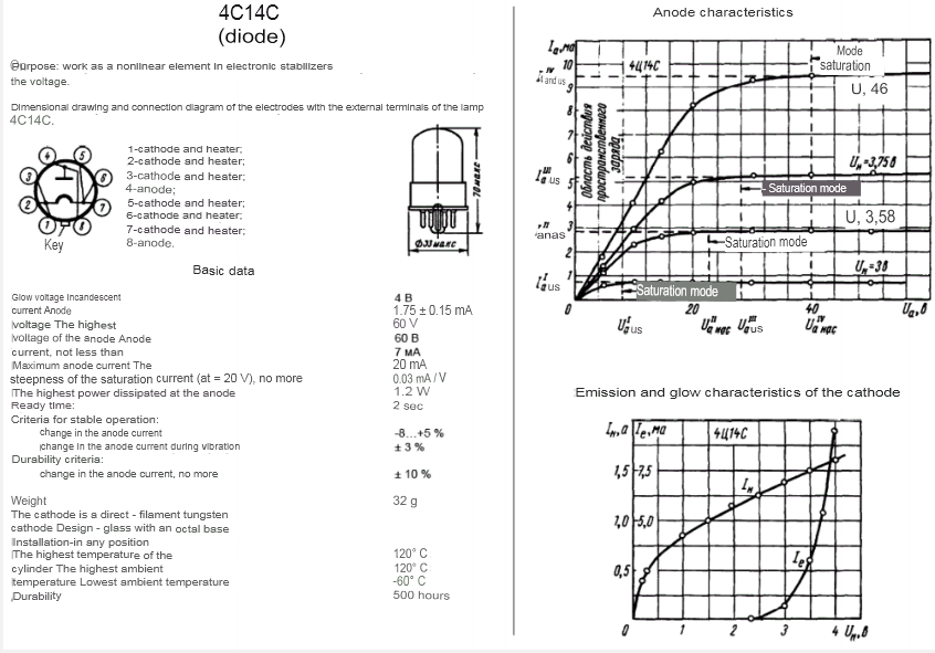

About this electronic tube: 4Ц14C
4Ц14C or 4z14s
is listed as "Noise Diode" in radiomuseum.org
4Ц14С, Tube 4Ц14С; Rohre 4Ц14С ID40042, Noise Diode
however in a link to a diy build with this tube the author writes:
" ... supplies current to the filament of the 4Ц14С which is a saturation diode used for controlling circuits (not a noise diode) and with a small change in the filament current, there is a significant change in anode current. The 4Ц14С needs more than 1A of current, at max power it uses 1.75A on average ..."
some more data from an expired ebay offer:
Name 4C14S
Type diode
Application application in voltage regulators
Cathode type tungsten,direct heating
Envelope glass
Mass,g 32
Filament voltage,V 4
Filament current,A 1,6-1,9
Anode voltage,V 60
Anode current,A 0,007
Anode power,W 1,2
Socket type rsh5
1st line in english:
Purpose: work as a non linear element in voltage stabilisers
