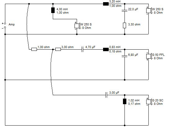

On this thread, system7 draw the crossover schematic, here it is :

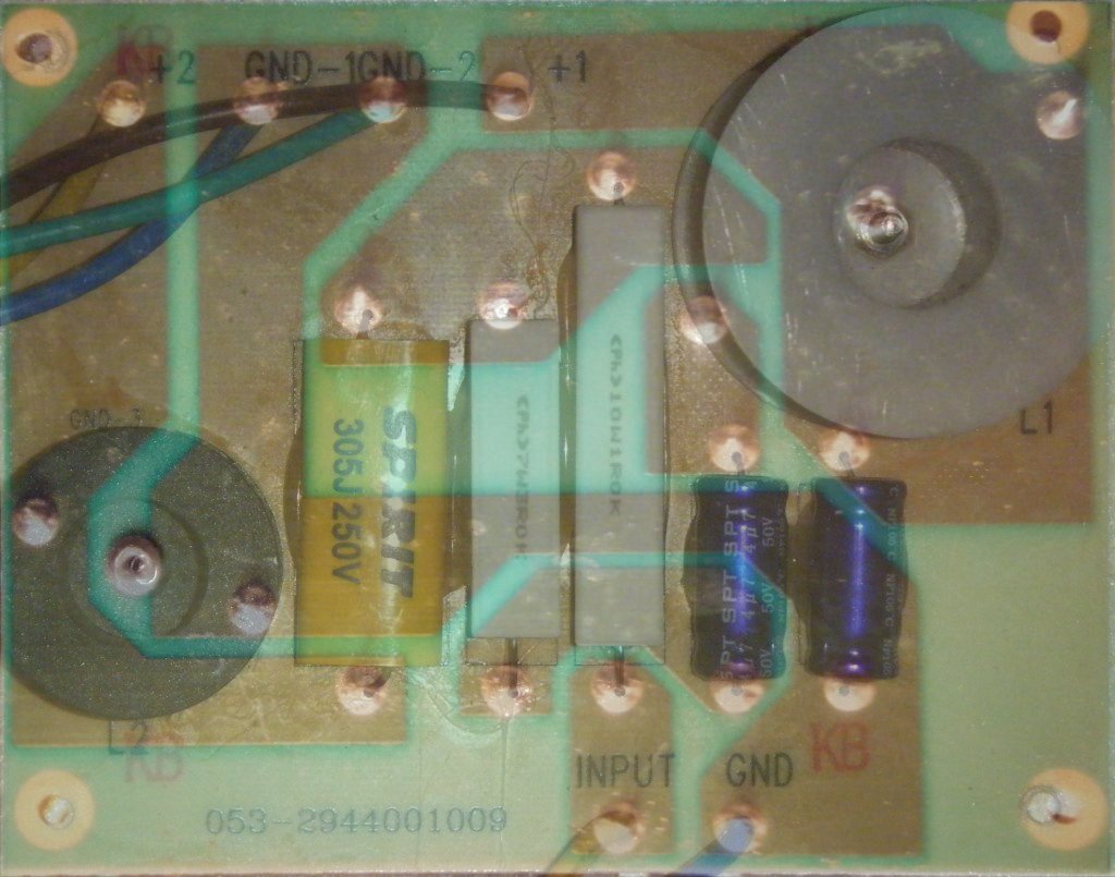

Derwhalfisch, who begun this thread, created a nice infographic for the crossover boards :

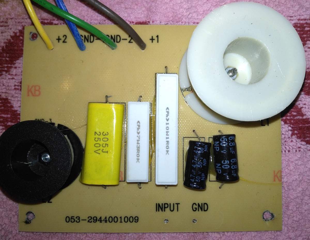

I can't remember what I was doing with this circuit, but it looks possible. 305J is 3uF polypropylene I reckon and won't blow. You can test the big dome tweeter for DC resistance in situ. The smaller dome needs unsoldering to test because the coil will short it out. A 1.5V battery should make both crackle.
I see no problem with testing for continuity on any of the components with a resistance multimeter. Possibly the 1R is a polyfuse. Can't remember.

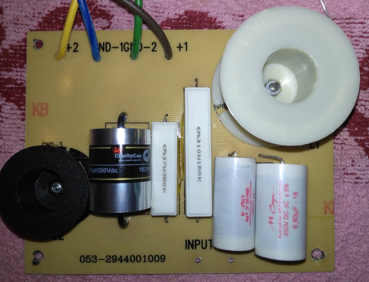

All have ended up with using good tweeter caps. Even the relatively inexpensive Mundorf MKP line has a really nice effect.

Really, Erik! How can "upgrading" the capacitors to expensive boutique types fix a broken speaker if the fauit is elsewhere? 😕
Unless the capacitors are broken anyway:
We can't discount the blue NP types on the right being open circuit, and these affect the big dome, but really the troubleshooting is the place to start.
This sort of speaker gets significant top end from the big dome. Testing, testing, testing is what you do. Otherwise you are a blind man poking about without a stick. 😀

Then the problem is solved. I took the crossovers out of the speakers (only the board for the medium-treble), I checked the resistors, they were ok, and as I haven't a meter for the capacitors I replaced them all, the three.
The crossover was the problem, not the tweeters. Now I listen real violins sounding as they have to, real cymbals, real harpsichords, and no more horrible medium, inflated and without details.
These are really others loudspeakers now. I suppose they were exposed to an overload in their life before...
Thank you for all your comments ! 🙂

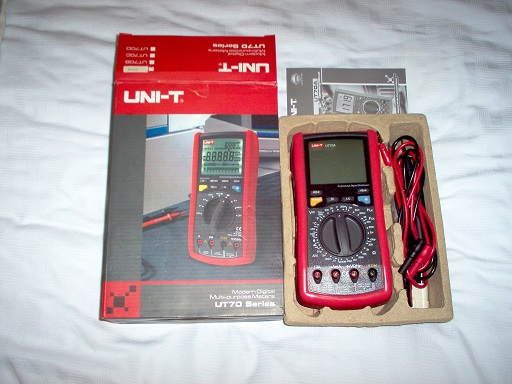

I am always a bit wary of suggesting you buy a good multimeter to test components, because it's a lot of money for a one-off.
But this £70 meter of mine is invaluable. It has inductance and capacitance scales. Most of the 3.3uF electrolytic NP types in my junk box have settled to around 3.9uF over the years. TBH, it could equally have been ferrofluid set to solid gunge or a solder dry joint.
FWIW, there was an episode of cheaply made Chinese knock-off electrolytics which lacked preservative causing havoc industry-wide with computer motherboards about 15 years back.
