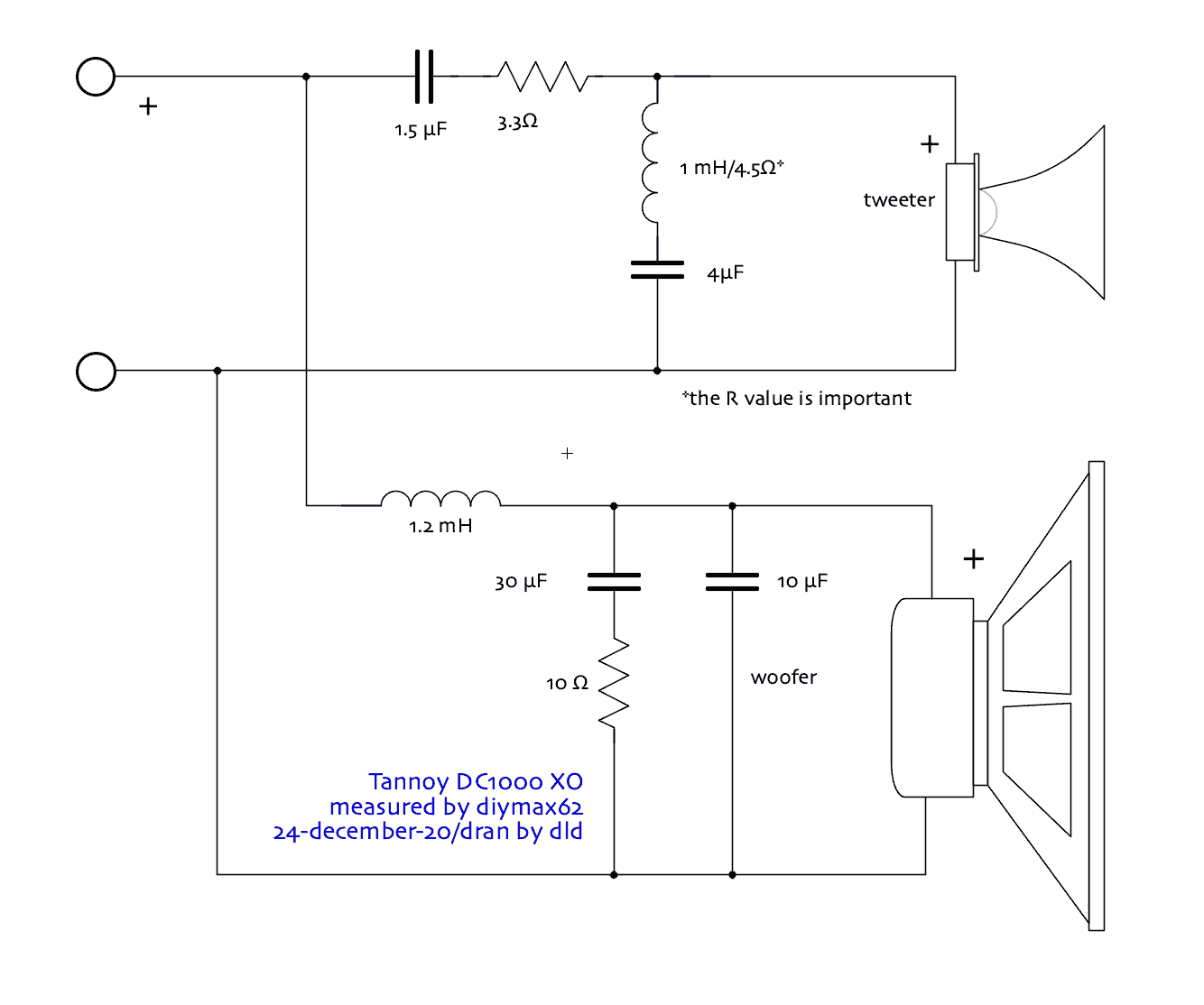

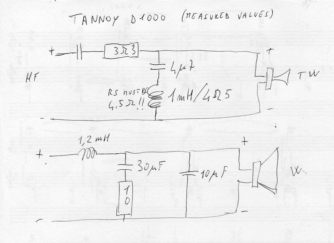

So, I opened the DC1000 to upgrade the crossover (especially substituting the electrolytc capacitors) and I have the opportunity to share the crossover schematics, with all value measured, with all the Tannoy lovers around, pointing the attention to a specification I never found in various schematics I've found on the net: the 1mH coil in series with the 4u7 capacitor that form together an anti-resonance attenuator placed in parallel with the tweeter MUST have a 4,5 Ohm RS (Resistance Series) value.
If you substitute it with a better coil you MUST reach 4,5 Ohm resistance adding the correct value to the RS of the coil itself, elsewhere che resonance cell won't work correctly.
I hope it will be a good advice for all the Tannoy aficionados!

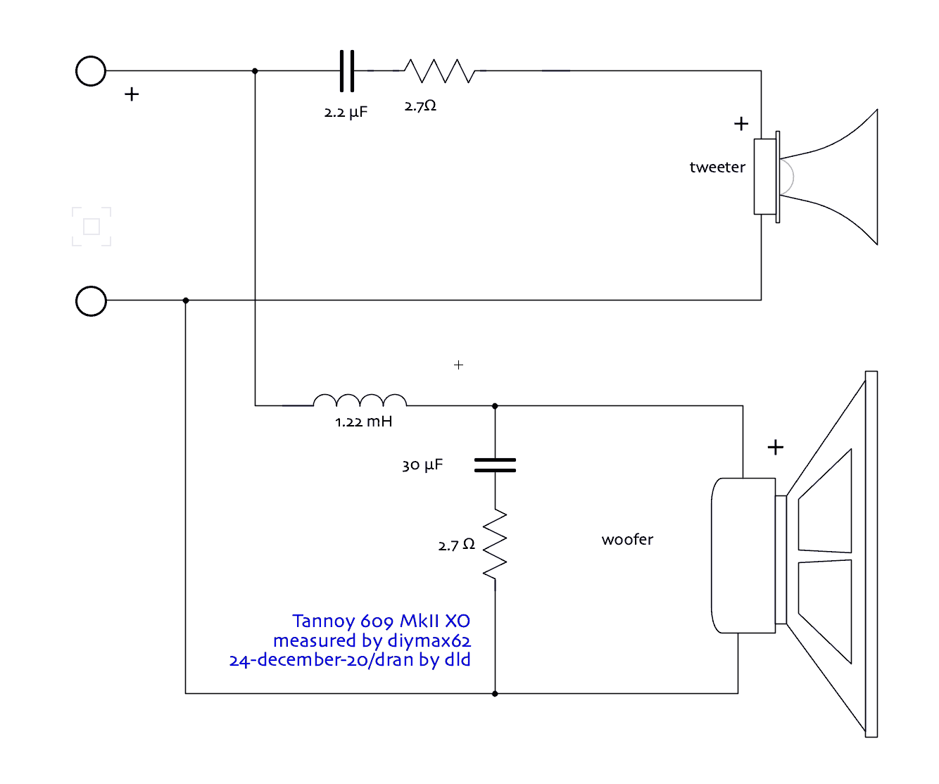

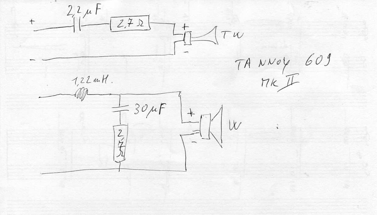

Sure, here we are: schematic in attachment.
Probably the lack of voice is dued to the lowpass filter, a 30uF, even with the 2,7 Ohm resistor in series, seems a "brute" value to follow a 1,2 mH coil. I consider more interesting the DC 1000 crossover, where the 30 uF capacitor in series with the 10 Ohm resistor act practically as a inductance compensation and the real filter cell is done with the 1,2 mH coil and 10 uF capacitor.
Also the antiresonance cell on the tweeter disappeared, I can imagine because of the new tweeter, surely not for economical reason.... does it? I'll investigate on it, too...

In the meantime I've changed the 609 low pass crossover accordigly to the DC 1000 schematics, and it seems absolutely better. The speaker recovered a lot of voice and warm presence (let's say 800-1K region, I suppose).
Now I have to calm an excessive mid-high presence in the tweeter (probably 2÷3 KHz), it looks like to take great advantage from the DC 1000 schematics, too (but surely is a different tweeter, it will be a lot of work to do...)

WOW!! Great work!! please planet10 pay attention to the resistor in series with the 30uF capacitor (both in parallel with the 609's woofer): its value is 2,7 Ohm, not 27 Ohm, exactly the same of the one in series with the tweeter.

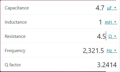

Just for curiosity I've found a rcl net calculator on internet, I've entered the value of the resonant cell in parallel with the DC1000's tweeter, its resonance frequency is centered at around 2320 Hz (...hmmm so it seems I heard right... 😀), with a q of 3,2 (about 1/2 octave), it should affect exactly the 2÷3KHz region, I absolutely have to give it a try inserting into the 609's cross, too...

thanks again Massimo for posting this information, I had a chance to do some simple calculations for the tweeter impedance compensator circuit for the DC1000, which as you guys have posted is a 1mH and 4.7uf cap with a R of 4.5 ohms, in this case the R of the inductor. As you well point out, the frequency of the LC is in the 2300 Hz area which coincides with the smaller hump on the graph, but the R at 4.5 ohms does not map into the data measured. Perhaps my equations are incorrect 😕, I am using R = Rr * Re / (Rr - Re). For the Re and Zmax measured this yields around 11 ohms, if I use the smaller hump Zmax then is even higher. Can you help me make sense of this R value? thank you all.
Hello Miguel,
sorry I'm not into mathematic so I can't help with your calculations, but just note that the rlc net is placed in parallel after the series attenuator resistor, so it should act as a variable attenuator vs frequency with the minimum value centered in the resonance area, lowering the power that goes to the tweeter. I've found an online rlc calculator, for this net it gives me 4,5 Ohm at 2,3 KHz and 8,7 Ohm at 1,8 KHz and 3 KHz. Higher value far from the resonance area (e.g. 46 Ohm at 8 KHz) shouldn't affect too much the signal that goes to the tweeter. I repeat, mathematic is not my field, but this makes sense to me, hope this helps.
Just to underline the importance of the 4,5 OHm resistor, even if a R component of the coil: without it, imagining a 0,2 Ohm value for the coil, the rlc resistance at 2,3 KHz would be lower than 0,5 Ohm. Even considering the 2,7 Ohm series resistor, the amplifier would see around 3 Ohm impedance (in parallel with the value of the woofer net at that frequency)... not very kind for the amplifier...
