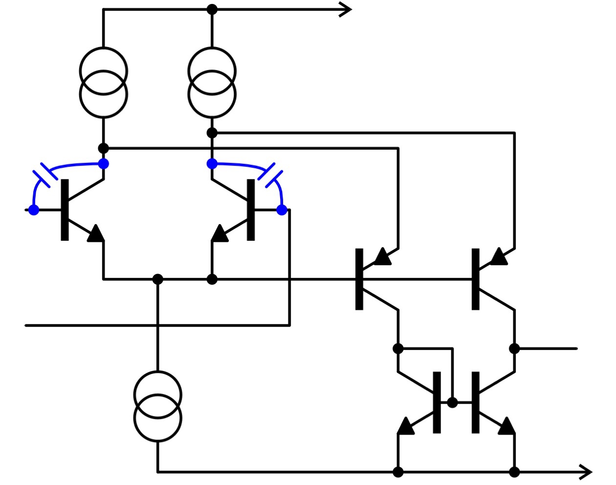

What are the pros and the con of rush cascode input amp vs ltp input amp ?

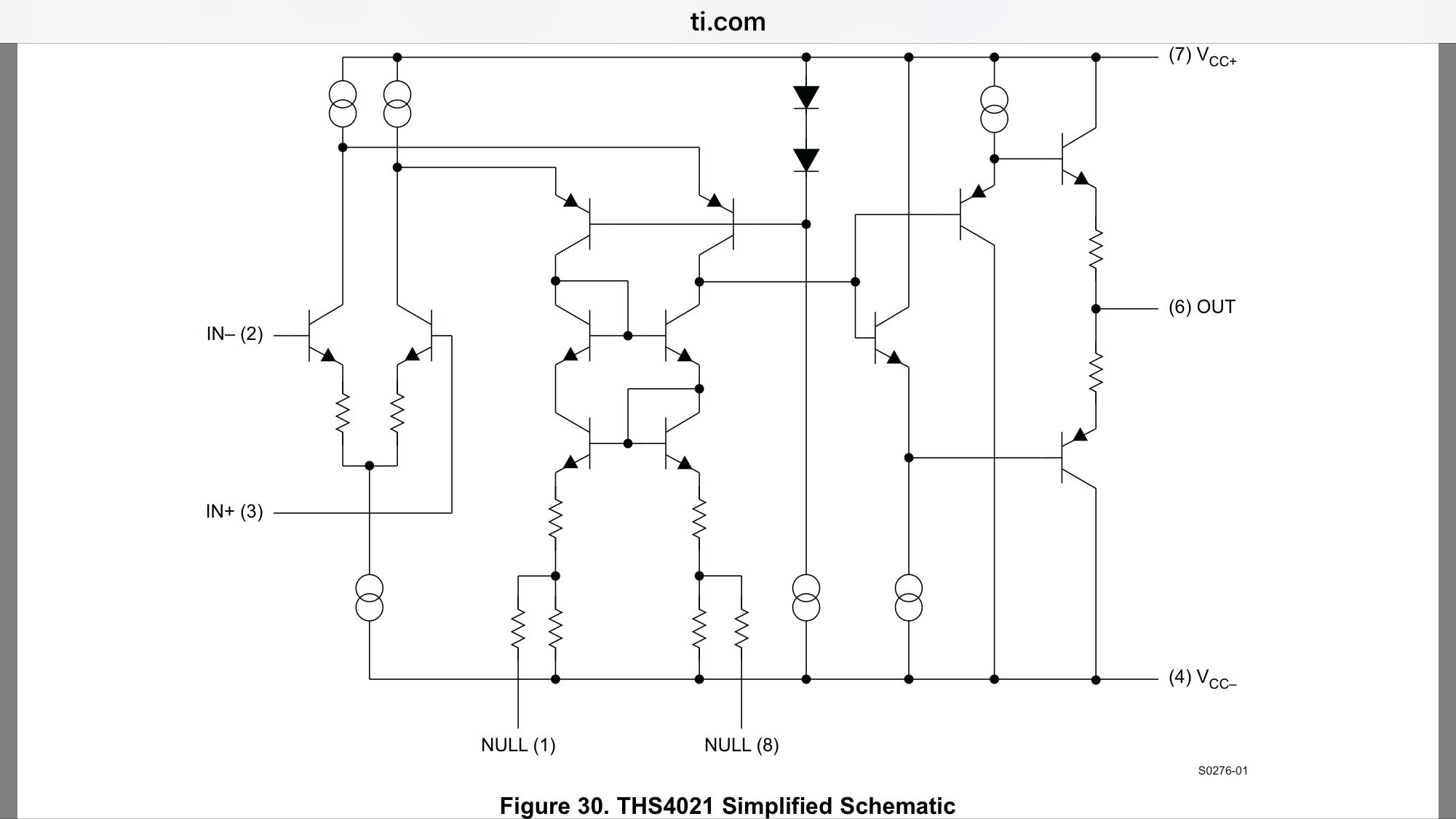

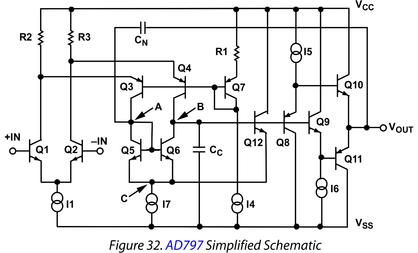

The first and the most advantage is that the rush cascode have no parasitic channel via base-collector (gate-drain) capacitance in the second stage.
Just because of this rush cascode have better HF-stability and predictive operation in dozens of MHz freq. range.
Also it have better isolation from supply ripple.
There are many opamps based on this topology, at least well known AD797 and THS4011/4021.

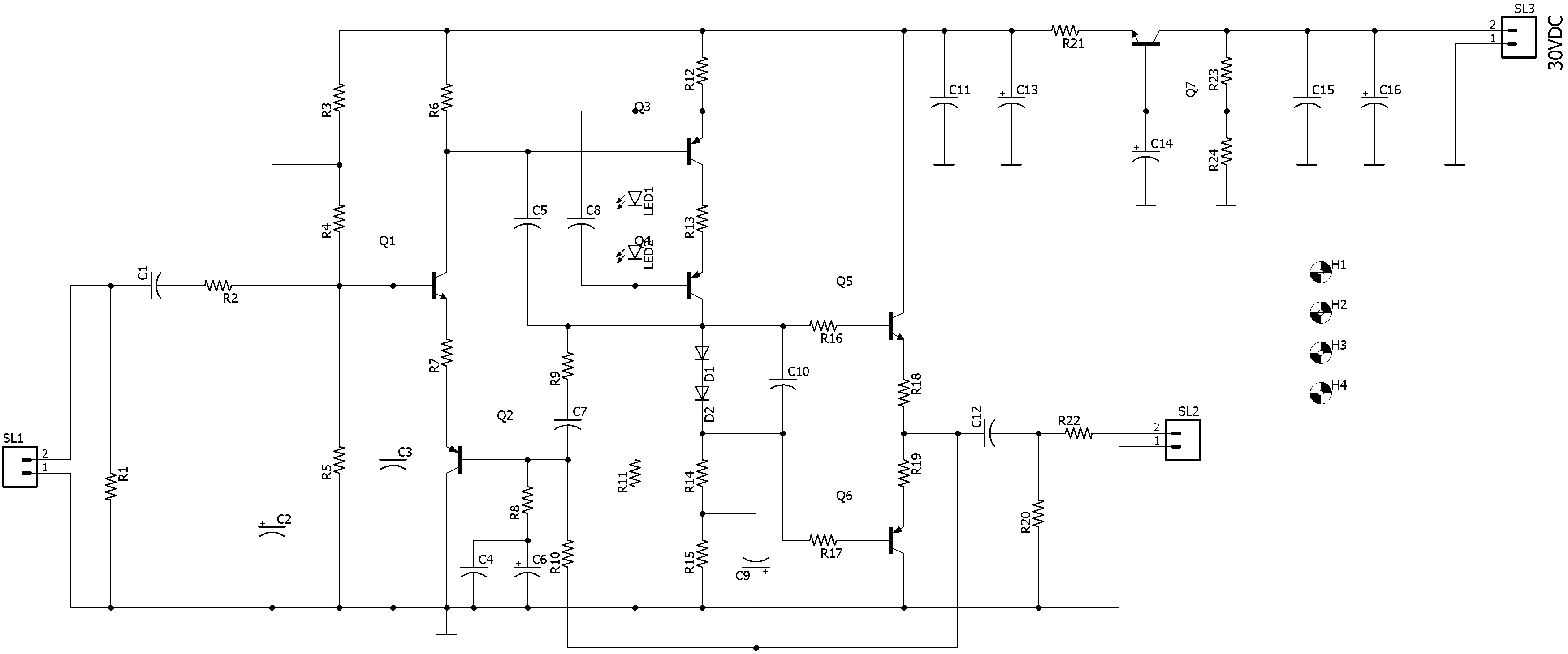

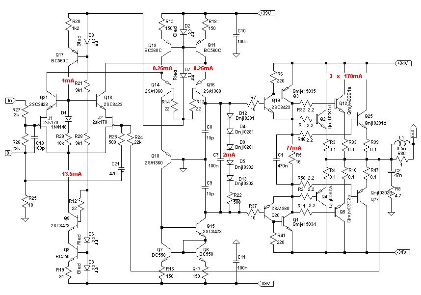

I can only see a folded cascode example in your schematics, but no rush cascode, A rush cascode is formed when both emitters from separate transistors meet each other.🙂
A rush cascade has two opposite gender devices connecting their emitters/sources and passing just one current. This variant is not the same as a conventional cascode. Effectively, you have an input emitter follower driving the emitter of a common base, with its base referenced to maintain 1.3V between the two bases. This configuration is extremely fast because the parasitics are greatly reduced, mostly because the common base configuration is very, very low impedance drive and base is at virtual ground.

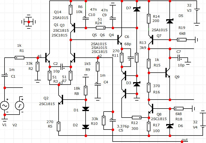

I've attached a picture of Mr. Evil's final schematic. It's basically a classic AB input amp with the Rush cascoding added. He actually does a good job of pointing out the pros and cons of the Rush cascode here:

And, I just got back from the "other" thread where forr pointed out the Rush circuit is NOT a cascode. It's another version of an emitter-coupled pair.
I hate the term "long-tailed pair," but if you're going to use it, it is appropriate to call the Rush circuit a "no-tailed pair. Recognize that these are both emitter-coupled pairs with the same small signal model.

I assume these are a comparison to an LTP. Therefore:
Given the same total quiescent current, the NTP (I am happy at least one other person called it that, even if reluctantly 🙂) has DOUBLE the Gm, because the bias current is not split between the transistors as in the LTP. So Gm is doubled because Ic is doubled. So maybe it is fair to add 54mV of degeneration to bring the Gm back to the same level, which increases BW and helps with the variable gain problem (limits it to a maximum rise of 2x).
However, if instead we keep collector current per transistor the same, the Gm comes out equal. and the quiescent current of the LTP ends up twice the current of the NTP.
Which of these scenarios is more valid depends on your reasons for comparing the LTP with the NTP.
Of course if you add NPN/PNP buffers to eliminate the offset of the NTP, then if all transistors have the same quiescent you lose the advantage of double Gm, but gain the advantage of low offset (though still not quite as low as the LTP).
Of course the NTP will always have more inherent distortion. But, that only matters if your input stage is the dominant source of distortion which in most modern amps, just isn't the case.
Noise:
Comparing it with the LTP at the same total quiescent, the NTP has less noise because both transistors have double the Ic.
So I would say both Gm and noise are advantages, or at least equal, and shouldn't be considered disadvantages.
On the other hand PSRR and CMRR are both disadvantages you didn't mention.
I see what you're getting at Keantoken. I caused confusion by being ambiguous. I was looking at 4 different circuits with complementary E-C devices: The LM741, which uses a pair of E-C pairs (2 NPN and 2 PNP) with a long-tail current source in between them. So that configuration has a gm/4 limitation.
In short, I agree with almost everything you say. Especially true is that the complementary E-C connection has 1/2 the total current of the matched diff pair. I also agree with you about the noise being 3-dB lower in the complementary E-C pair, because they have the same current, and not two uncorrelated currents. So I retract my statement there.
I didn't mention PSRR and CMRR, because I think those are more a factor of circuits external to the E-C pair. The inherent balance of the E-C diff pair surely helps with both, so I think in general, you're right, all else being equal.
