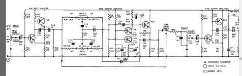

Have a look at some old amp designs such as the Radford HD250.
Two line stages and a tone stage shown here. Easy to build and great sound.

Hello and thank you very much for the suggestion.
Do you think that simple circuits have a "potential" for better sound ?
This is my true feeling lately, but i have no technical basis to explain this.
Thanks a lot and kind regards, gino
My own personal opinion is that such circuits can consistently deliver a good subjective result. This gets debated over and over and over... that the amplifier should be as a transparent and "perfect" technically as possible. Thing is, all those with such amps often don't seem happy with them when used for their primary purpose... music reproduction.
You will only know by trying such designs 🙂
