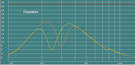

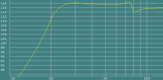

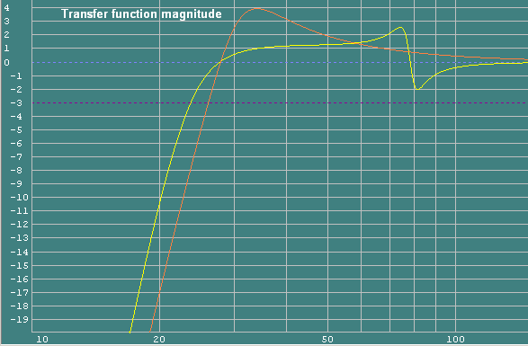

Have a look at these designs i've in done, with the software i recommended to you earlier.
The Reflex is Orange & the ABC is Yellow.
Reflex
Vol = 4.670 ft3 - fb = 30Hz
ABC
Vol = 3.178 ft3 = 1.589 ft3 = 4.767 ft3 - fb's = 15Hz + 40Hz
Both with a LR 24dB 20Hz HPF

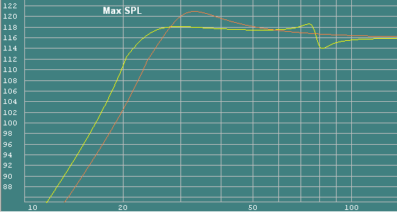

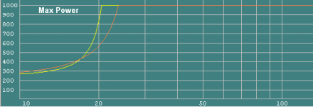

Speakers are, mainly, limited by 2 things, Power & Excursion limits. One is usually reached before the other. So even though this driver lists Xmax as 29mm, it can Only take 1000W Max. So it has more excursion than it needs, before Max Power is reached. Which means you won't be able to take advantage of all of it !

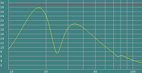

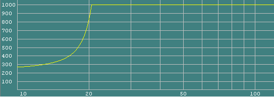

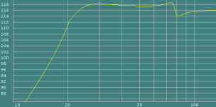

Here's the ABC @ 1000W tuned to 15Hz & a 15Hz LR 24dB HPF. It's run out of power @ 20.5Hz & Xmax is near Maximum now.

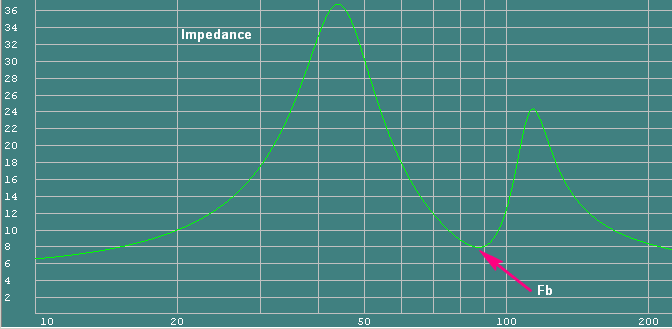

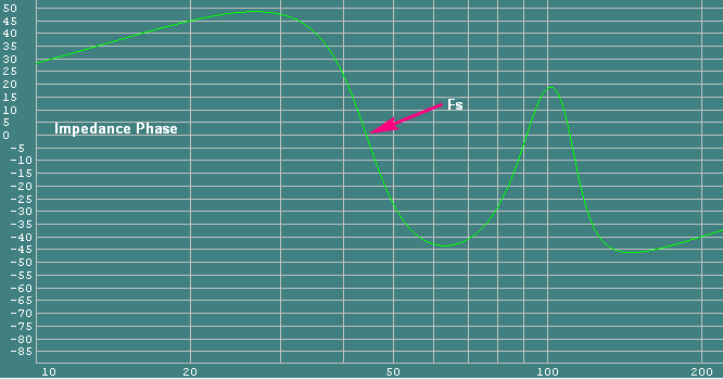

Driver Fs data sheet spec is out of a box, unloaded. Once you put it in ANY box, the Fs usually rises, sometimes quite a bit. Unless the box is Massive, but then the effeciency would be Very low. The port/s in combination with the box volume/s, tune the box to a specific Fb. See my screenies 😉
