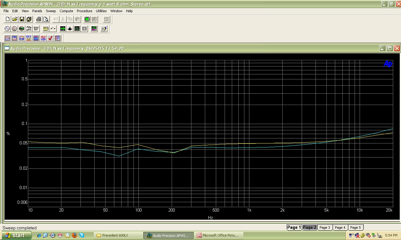

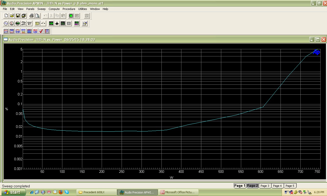

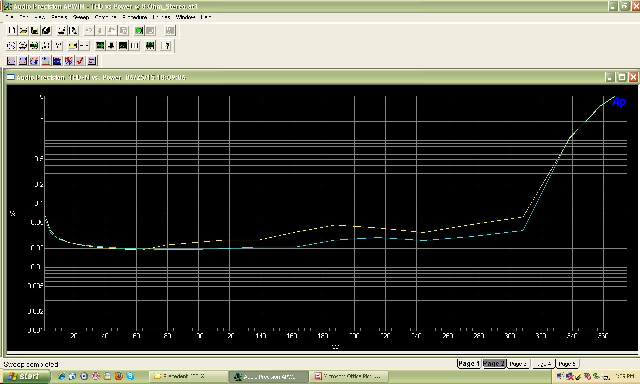

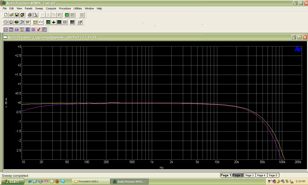

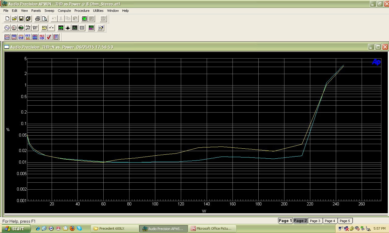

I recently acquired a 600LX for $129 shipped. I could not pass it up.
It is in fair condition cosmetically, it looks like it may have been in a stadium or such at one time.
It had one bad power supply capacitor. I happen to have a stash of misc amp parts and shoe-horned in two 20,000uF/100VDC caps just for a test... that's all it needed.
Attached are some AP graphs of its performance. A little shy of the published specs, but it has plenty of power for my needs.

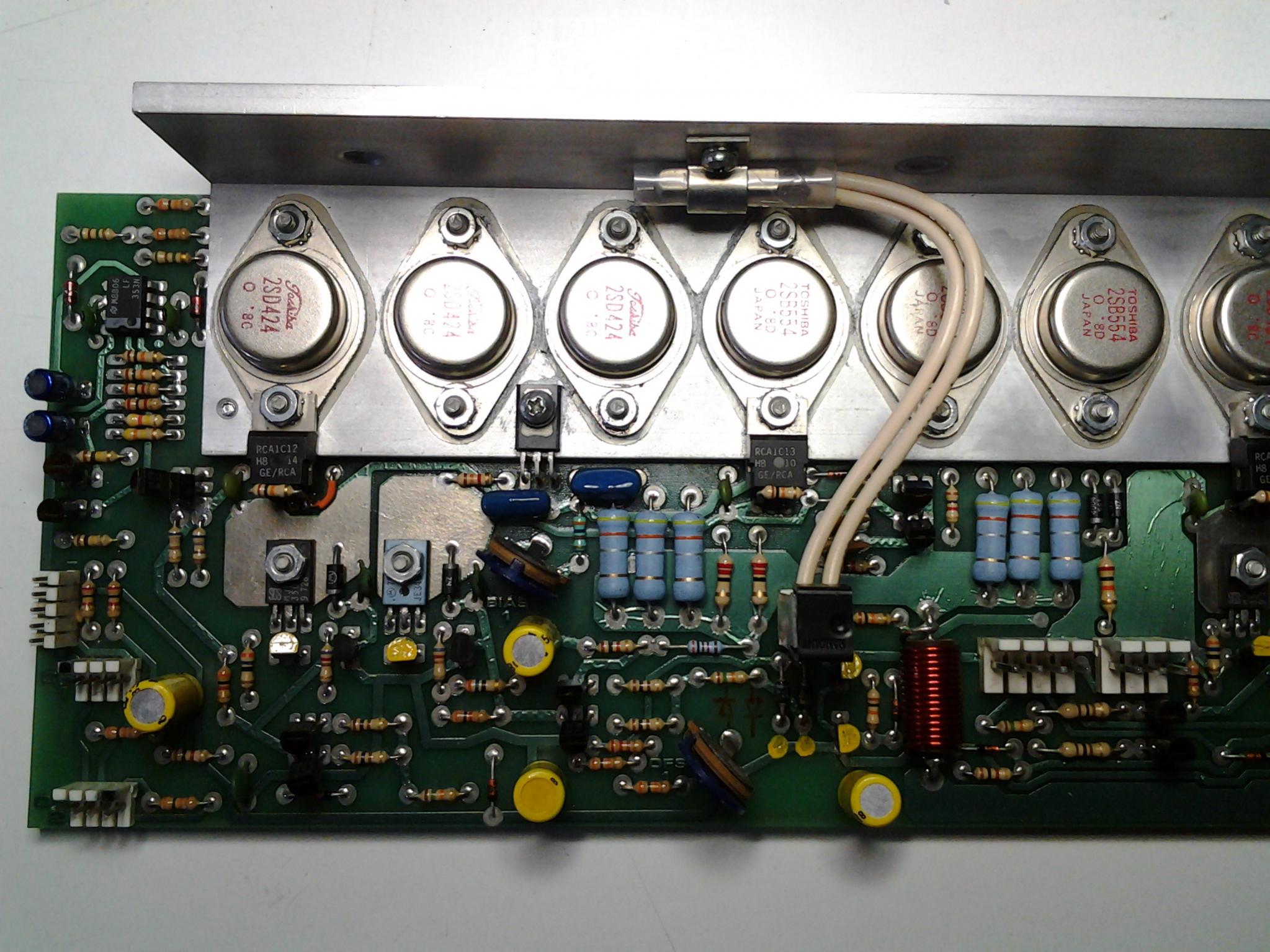

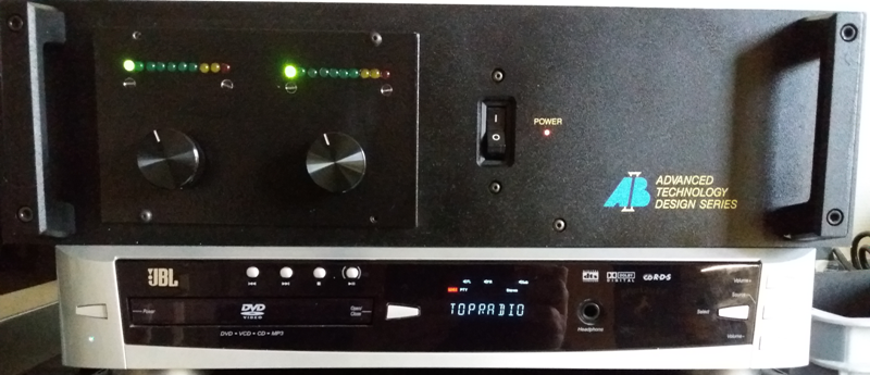

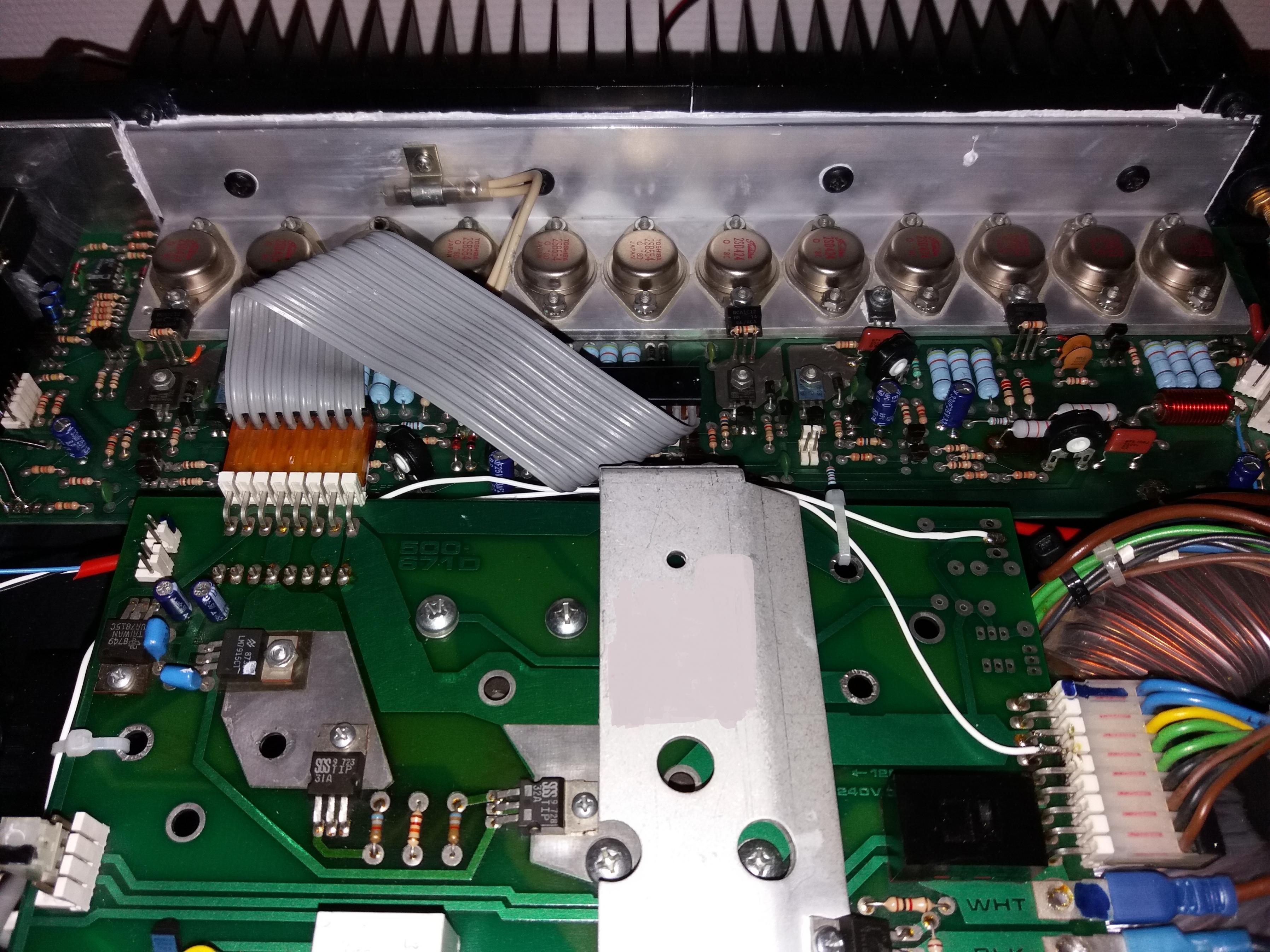

Hello,
I now modified the 713 to a conventional 2 channel almplifier,removing the active crossover part and just adding 2 input pots+vu led display.
The mono Pcb (for the low frequencies) was also removed.
Hello,

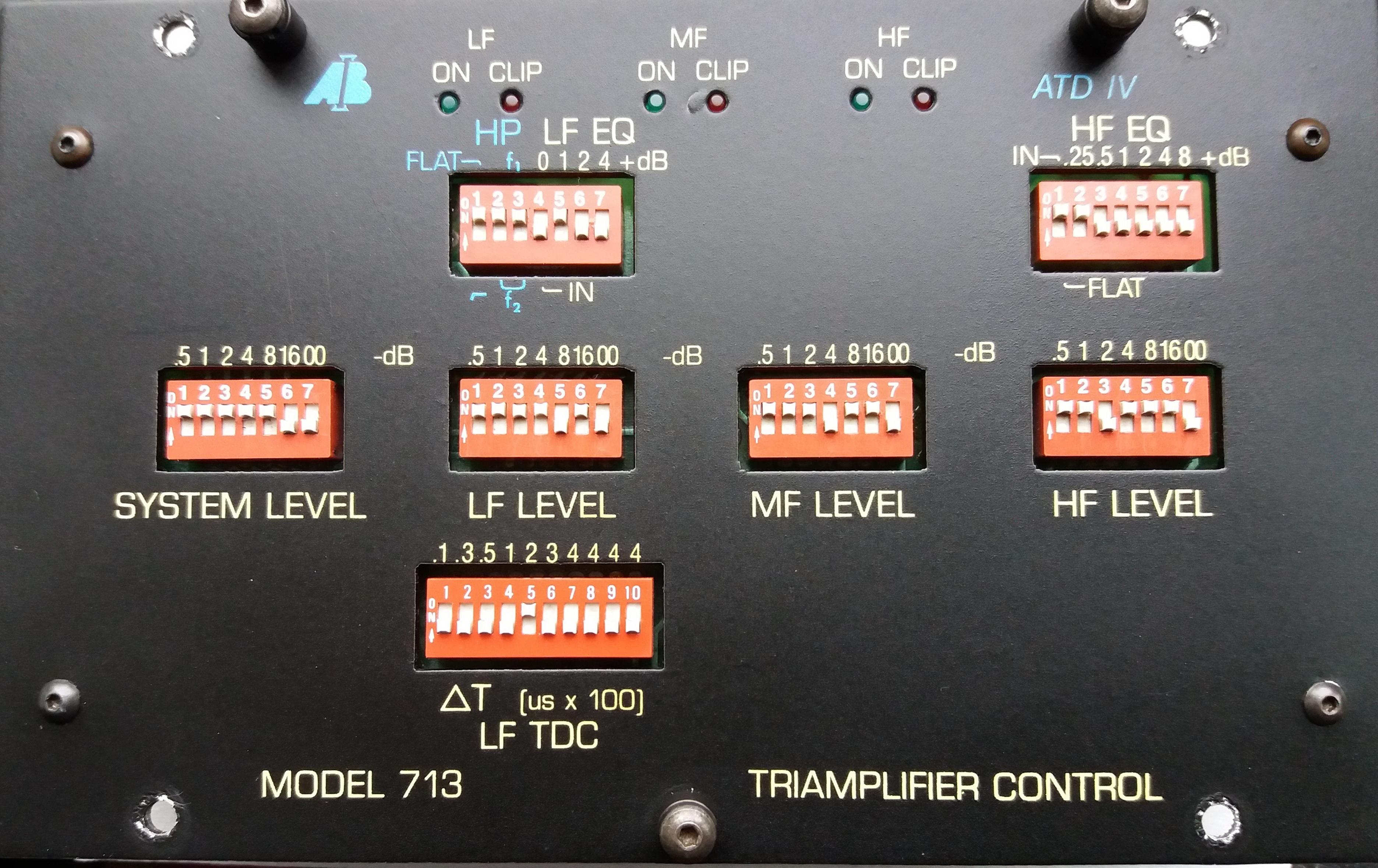

Nice Work! How many channels was the 713 originally? Hard to believe you could get a +7 or +8 tilt (boost) on the EQ switches...that's a lot. I wonder where the low, mid, and high frequencies were set to add or reduce the tilt there....?Hello,
100, 1000, 10,000 maybe?
