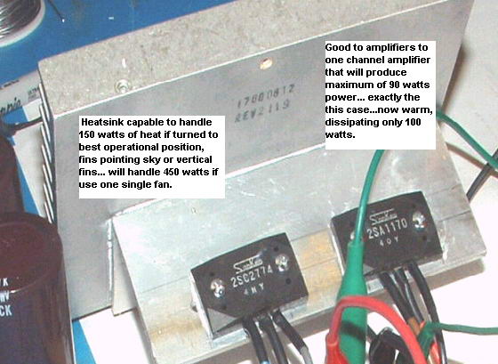

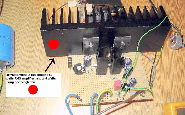

90 squared inches of aluminium, 10 fins measuring..
something alike 3 by 3 inches each one...or any other distribuition or shape, since you have around 9 squared inches of aluminium surface in contact with air (considering only one side) will be enougth to dissipate 100 watts of heat, and this corresponds to a single 50 watts amplifier channel working near the clipping.
In the reality, the area that will loose heat to air will be doubled in reality, as each fin has at least two big flat sides, and, both sides will work.
So you can re-arrange this basic calculation...you can say that 18 square inches of aluminium in contact with air will be enougth to dissipate 10 watts.
Those watts are not the audio power produced, as this can be half the entire power producing heat.... 65 percent normally produces audio, but for safety reasons...better to think in fifty to fifty....half power to speakers and half the power lost entirelly as heat, producing no work...so, 50 watts amplifier will produce 100 watts of heat...if stereo, 50+50 watts amplifier will produce 200 watts of heat.
For calculation, I do not use both sides.some psychological defense against enormous area numbers...i take into account only the area of one side....this way, 3 by 3 inches thin will dissipate around 10 watts of heat.... 9 square inches in contact with air to dissipate 10 watts (if you prefer, 18 square inches in contact with air to dissipate 10 watts).
This will be able to hold 100 watts of continuous power, and may be the maximum undistorted steady sinusoidal undistorted tone you will reproduce over 4 ohms loads.
Atention!...this is for a single channel, double to a stereo amplifier... in this case use around 20 fins, having something around 180 squared inches.
This is a 45 years pratical use, giving good results to 30 degrées centigrades environment.
Heatsink must be outside the enclosure, mounted in position to have free air circulation...better in the back panel, as you can keep it projecting outside the table.... heatsinks in excess of length related the table bottom extreme, to allow a good convection air movement, were air flow to the ceiling sucking new fresh air from the floor...hot air goes high, cold air goes down, just to remember.
If you install inside cabinet, use fan and reduce the size 3 times as hugh told, but for safety reasons use 2 fans.... if one stop, you will have some guarantee not to burn transistors.
Reduce fan speed using LM7808 DC regulators chips, TO-220 capsule as you know...maybe 1 square inch heatsink will be needed to this chip... remember that input voltage to those chips cannot be over 25 volts.
