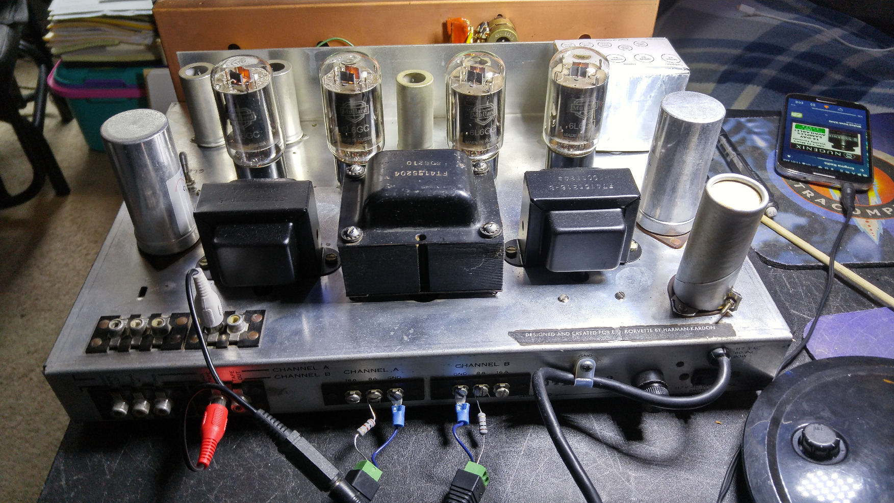

i just got a Hi Fidelity XAM from EJ Kozette (HK A300) that i modified to use 6L6 by adjusting the bias on the cathode with a 50 Ohm 5 watt resistor and a switch. Hooked up headphones to the 8ohm output using 150 ohm resistors in series with AKG K142 3.5mm output. Slaved the filament to a new 6 amp filament supply to keep the 6L6's .9amp filament hunger from starving and man what a great sounding amp. Replaced all the electrolytics and getting ready to replace those paper and wax couplers. Sounds fantastic. Listening to Paul Hardcastle and it really sounds good.

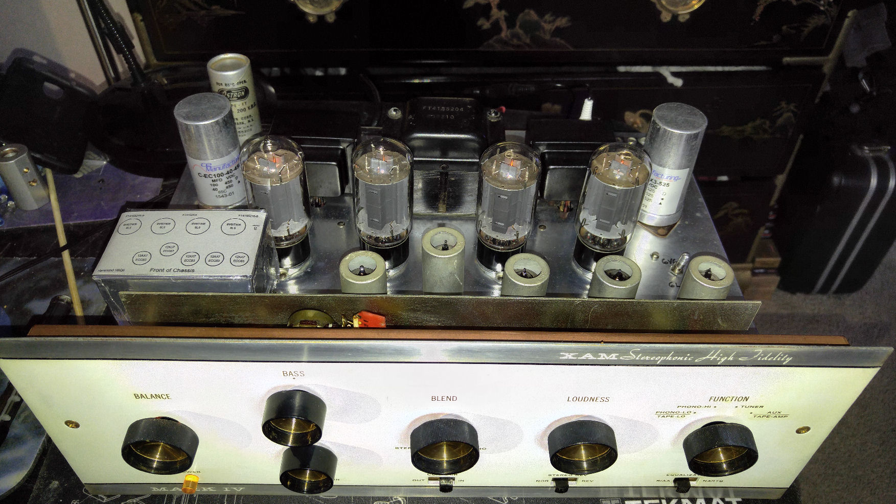

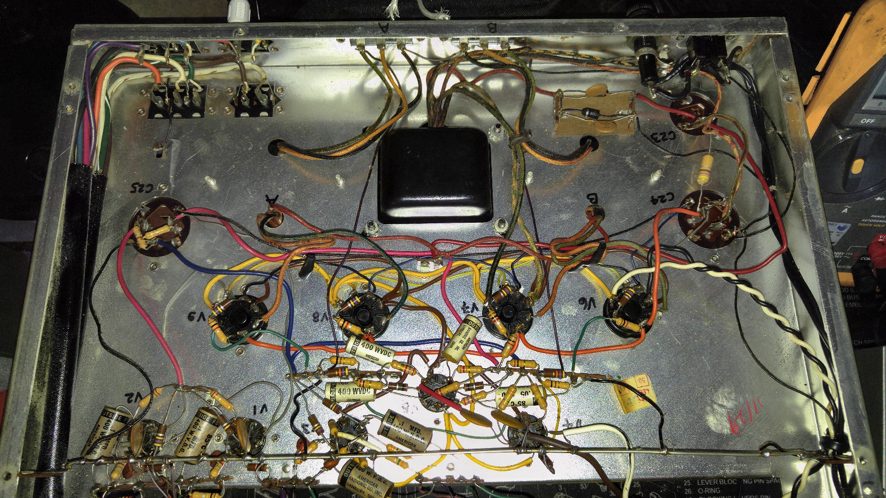

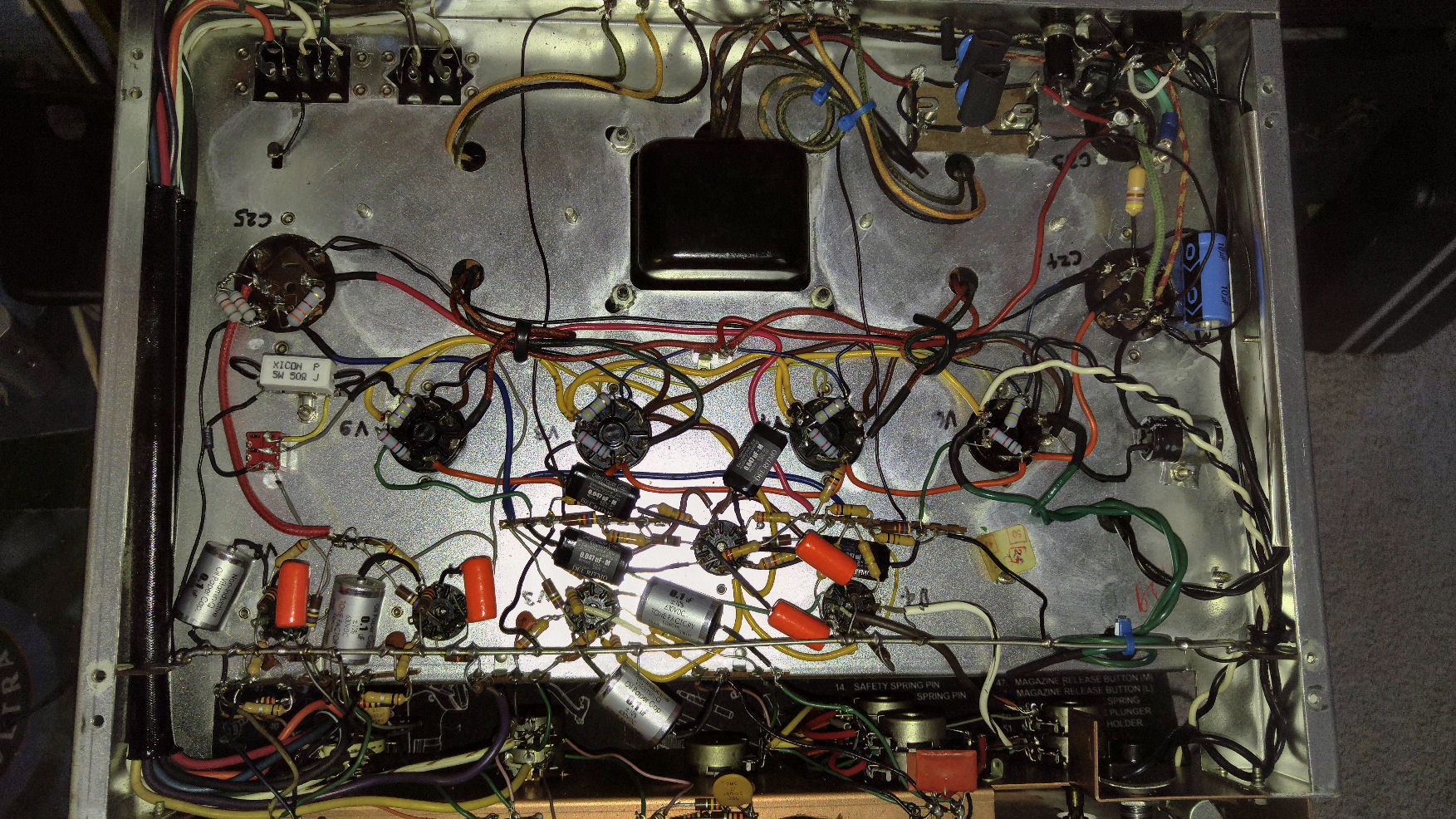

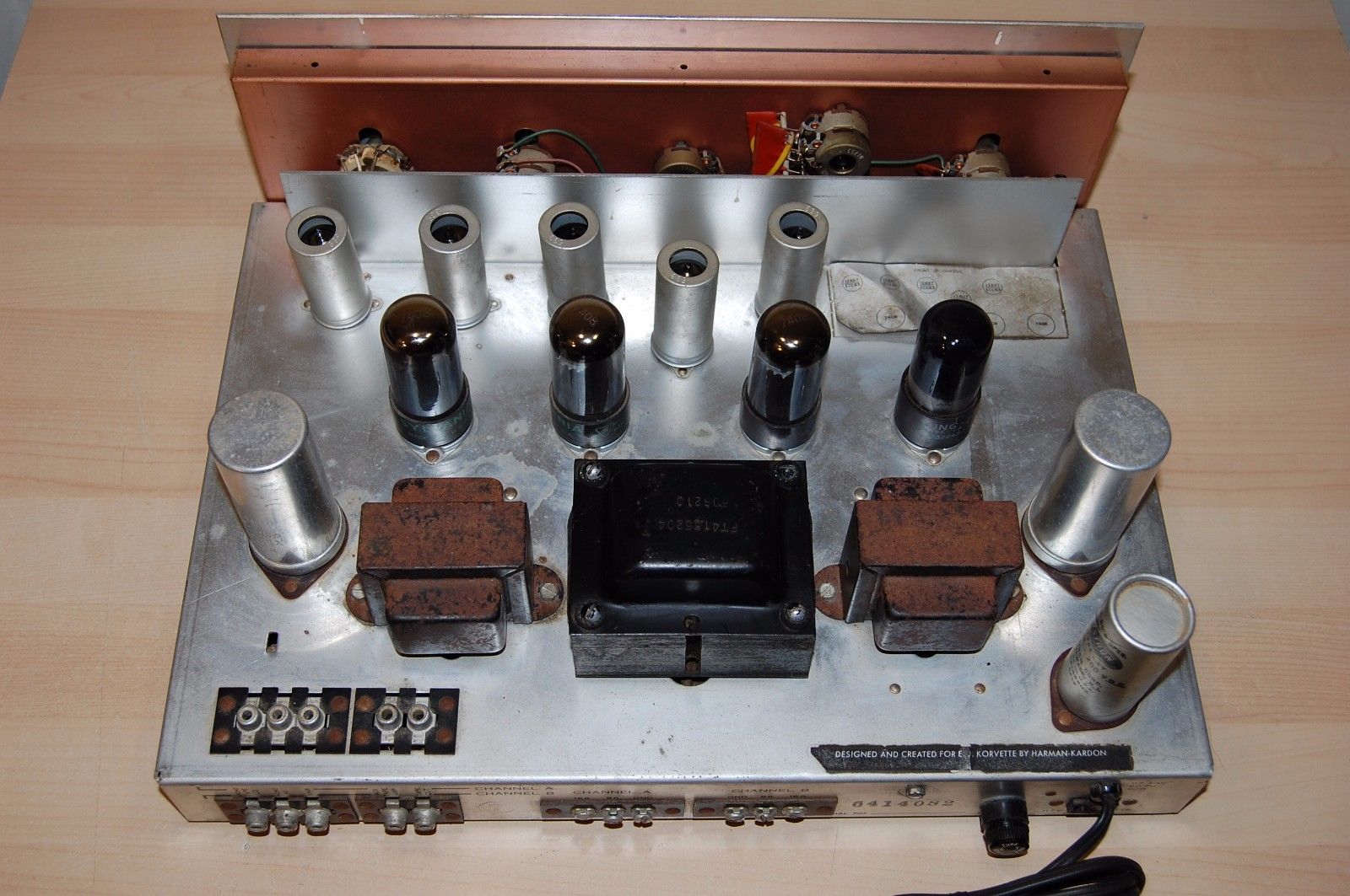

A300 (XAM) before and After
OK guys her she is, kinda like Sammy Hagars Plain Jane but she performs well. New Vitamin Q couplers, resistors where necessary, 6V6/7408 to 6L6 mod, 6 amp filament transformer, HEXFRED rectifier diodes and safety caps and new electrolytics. Here are a few before and after pics. Burning in some new issue Mullard 6L6 while i contemplate if i really need an my arm and leg for a NOS or old school RCA black plate quad output. Kevin
