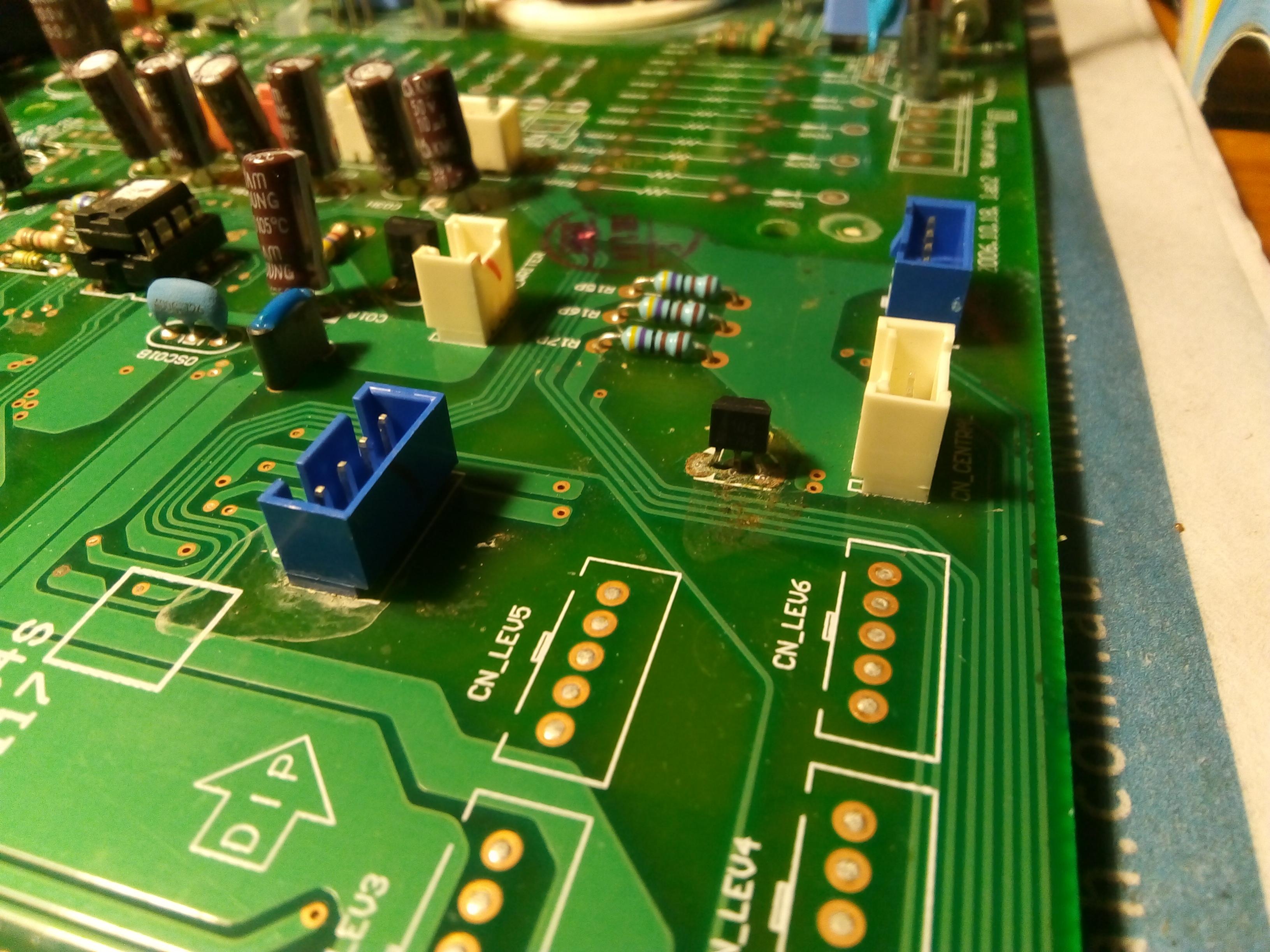

I have come across an old split system air-conditioner with a failed A105 Germanium transistor on the remote control input by the looks? It belongs to a neighbor who asked me if I can fix it, he had a quote of $1,200 for just the board? He said that he found a dead Gekko on the board and I noticed burn marks around the A105 transistor which I then gave a diode test and found it had gone to transistor heaven. We will now respectively observe 1 minute of silence.................sniff, sniff! lol, I see there are substitutes for the A105 that may be easier to get but are they suitable for this circuit? I'm out of my depth here, this is foreign territory, can someone help me with this, please. 😀

Thanks for all the info fellas. The transistor is marked with A105, underneath that it says M.704. I've tried photographing it with my phone but the lettering is too small? My good camera won't upload photos to my computer? The transistor is on the right-hand side of the photo next to the white connector. So I should be right if I order a 2SA105 transistor from someone like Digikey then?

The important issue is to trace enough of the circuit to identify the emitter, base and collector. Then most likely any common NPN silicon transistor can replace it. By the case size it is a very low power transistor. So anything rated above 50 volts should work.

Similar to what SImon said, just what does the transistor DO in this? Does it wire to the white connector, and if so what plugs in there? I mean if it drives an LED somewhere, then most anything will work.

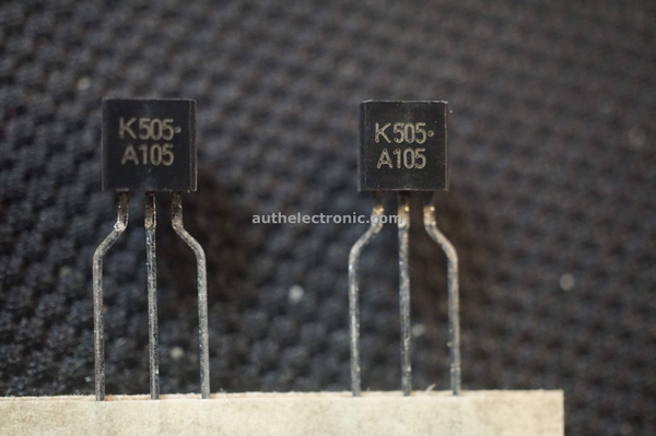

This is what you have, modern plastic body SILICON 2SA105, cheap Korean Made general purpose transistor.

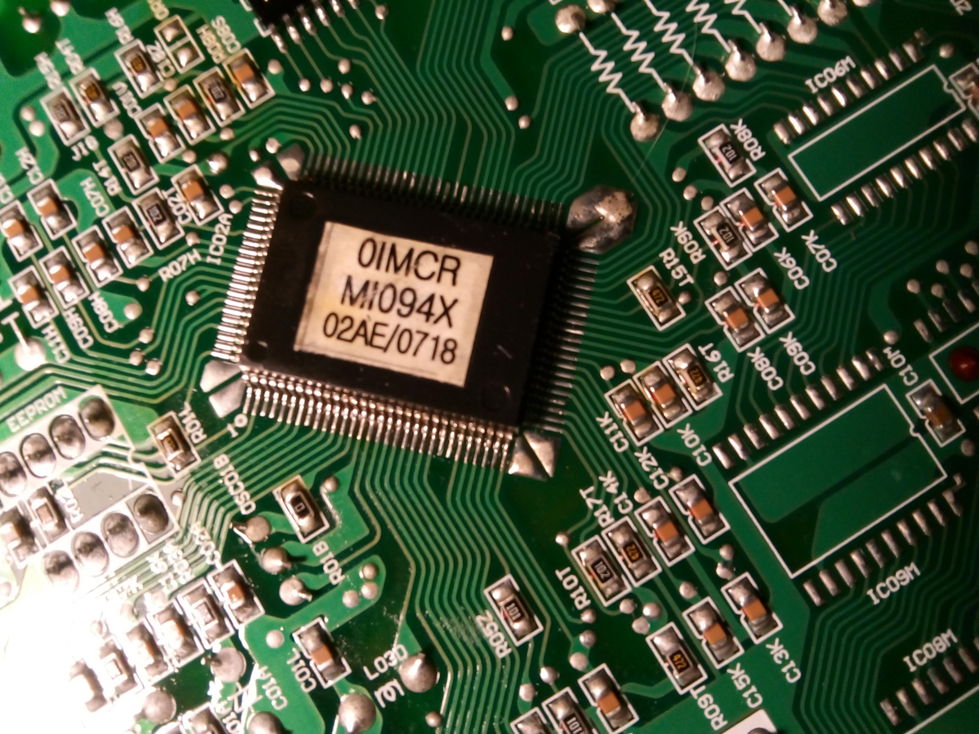

The Superimposed transistor in the photo is Germanium according to my VRT Asia Pacific Transistor book. The A106 is the same as the A105 except that the former is 30mhz and the latter is 75mhz. But then again it is for a 2SA105 and not an A105? That is where the confusion comes in! Anyway, the white connector is labeled Central, it goes to the A105 transistor then to an eeprom (the eeprom had a sticker on it but the ID underneath was sanded off) and then to a microprocessor looking thing underneath?
Oh, that's great!, now I'm heading in the right direction. Thanks for coming up with the info I needed, it is much appreciated. Hang on! how do I order one of these or can I just use a general PNP transistor?
I've been looking for this silicon transistor, I cant find where to buy it nor can I find a datasheet for it so I can find a sub for it? A105 and A1050 doesnt bring it up?
Sorry if I was not clear.
"A105" IS 2SA105
"2S" is a given so it´s not printed if there is little space available, but of course you need it for a search..
The one your transistor manual mentions is a 60´s Germanium transistor, meant for Radio Frequencies in early transistor radios.
Its case was:
clearly not yours.
I *guess* any General Purpose Silicon transistor will do, but be aware it´s "Japanese" (even if made in China or Korea) which have a different pinout from "American" and "European" ones so get the datasheet nd check pinout.

I've found a seller on fleabay but it would be good to have a datasheet of the silicon 2SA105 to find a substitute instead of waiting a month to get the transistor in the post? If this 2SA105 silicon is a general-purpose transistor, then a BCxxx series might work then?

That's not 'A105' but 'M05' or 'M06' where the M is the Motorola logo!Highlighted image:
The next line is a smudge and 'TBG' (To Be Good ???).
I would say a general silicon, solder it out and determine pnp/npn, the basis and the beta (in that order). The highest beta determines which of the other legs are the c and e.
