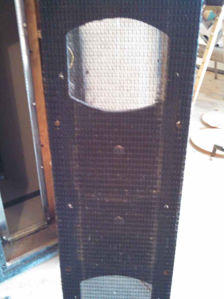

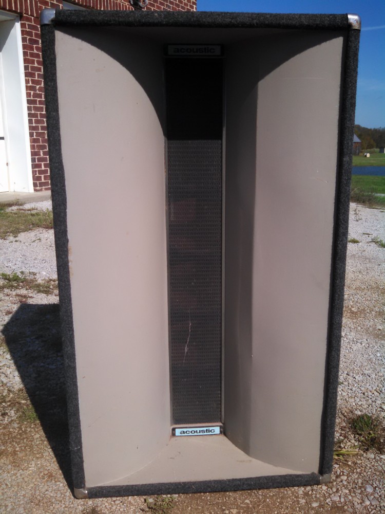

I was recently given a pair of horn loaded line array cabs that defiantly have signs of being vintage. I'm not sure how old they are, but the cabs themselves seem to be in fairly good condition. The drivers on the other hand are all but completely gone. Of the 6 per cab only 3 remain, and they aren't anything I'd consider attempting to match.
These guys need brand new drivers. But before I spend time and money on something that was old and free, I would love everyone's opinion. Would it be worth it? I've never previously seen a line array implemented like this. Is this horn arrangement a failed concept of the past, or could loading these cabs with drivers be worthwhile?

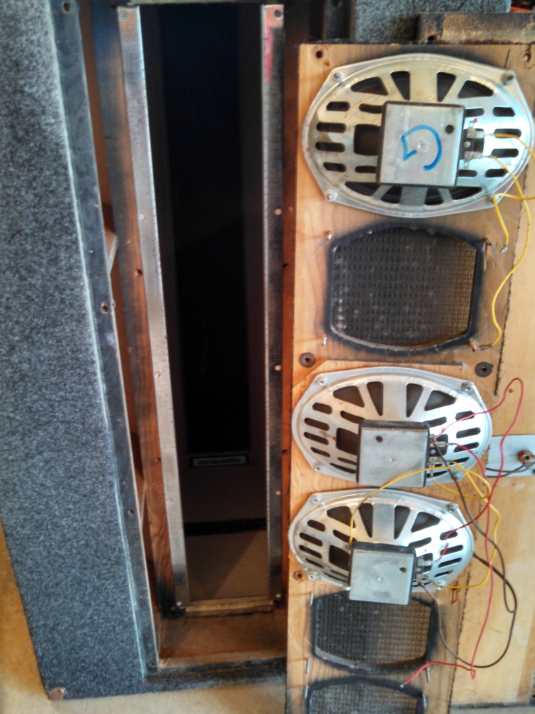

As you can see, the drivers are mounted on a removable panel. It would be simple to create a new panel for new drivers.
I was thinking cheap, like these: Celestion Neodymium 5" Full-Range Woofer 4 Ohm
The throat of the horn is 5.5" by 38.5"
The enclosure has an internal volume of roughly 3.2 cubic feet.

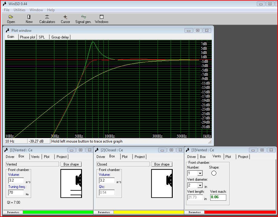

WinISD calculated an EBP of 137.7, so it looks like porting is desirable. The drivers only have an xmax of 1.13mm, so anything to reduce excursion sounds like a winner. But at the same time, a picture is worth 1000 words.
Green = 6 drivers ported in the 3.2 cubic foot box, port length no problem
Yellow = 6 drivers sealed in the 3.2 cubic foot box. Too high of an xo point.
Red = 6 drivers ported in calculated 0.072 cubic foot box, port length a problem.
I guess I could go with the green and apply a steep high pass at 100hz?

Acoustic is/was a manufacturer of not-so-wonderful guitar/PA stuff.
This is another example. Those are cheap automotive type drivers.
The horn loading is not going to be of much value, and there will not be much loading. It's mostly for looks.
Imo, if you want to use those Celestion drivers, just build urself something with them. A line array will work rather nicely, although you will need tweeters.
Skip the horn loading of this sort.

twin: That huge response hump in the Green alignment looks problematic. How do you intend to use the refurbished cabinets? Home or pro audio? With subwoofer(s)?

If you refurbish them, forget the 5"drivers, use the original 6x9" size.
You need old (think 80's Jensen) dual cone car speakers there, which will be more efficient.
Or the modern Chinese reincarnation.
Think $15 per speaker or so.
And forget hornresp 😉 not much applicable here.
Like bear said, those are very outdated speakers, think 40 y.o. (no kidding).
Probably 3.2 ohms per speaker, 3 in series gives you nominal 10 ohms, 2 such series in parallel give you 5 ohms per cabinet, feel free to call that 4 ohms nominal.
The PA head driving it probably was 200W into 2 ohms 😱 ... wonders of designing around 2N3055.
Today you would use 2 of 100/4 power amps, one per cabinet.
