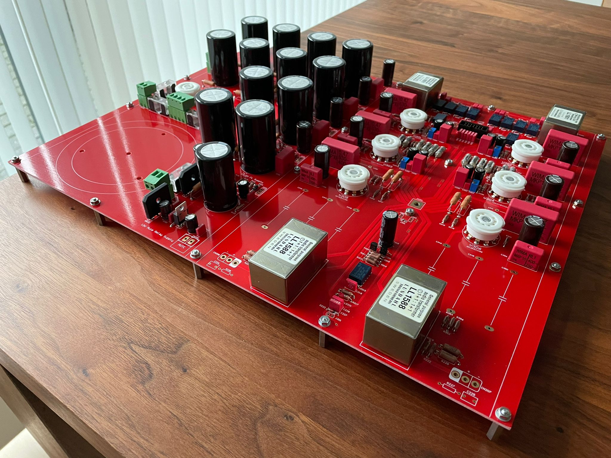

Hi Forum,
I decided to make a tube only RIAA phono stage and make a nice over the top PCB for it. The design is a bit based on the Luxman EQ 500 with less bell and whistles, but in basic form the same thing.
A friend of mine wanted to tag along.
We ordered 3 main boards, one to prototype on and we only put components for one channel on.
This would not ruin the end result for if we would have had to cut traces and blow up things.
Luckily the board had only one error (a PNP transistor with Collector and Emitter swapped in the foortprint) in the slow start function of the 12.6V filament supply.
So, the concept is a dual 12AX7 based SRPP stage running on 320V with a passive RIAA in between. No NFB. I made a separate left and right regulator with a bit beefy supply. A custom transformer ordered with 2x 350V CT, 14V for the heaters and relays and 6,3V for the Tube rectifiers.
Used an ECC88 for the output stage running on 250V but two halves in parallel. The ECC88 has a low output impedance and 2 parallel is below 50 Ohm. A Lundahl transformer for the MC input and one to make a balanced output. The output stage is also AC coupled with a floating bias resistor to bias the output tubes (way more predictable and a beefy 16mA class A current trough the combined parallel tubes. I also made a reverse RIAA circuit tweaked it to 0,1% and a channel balance of 0,1dB.
I used 30nF and 10,2nF in the RIAA stage and measured with an Audio Precision. The theoretical values would be 72k and 10,6k for the RIAA resistors.
The 72k is way to high as you need to add the output impedance of the SRPP and the impedance of the coupling capacitor and the result is shown in the attached picture. Distortion was -74dB A weighted dominated by the 50Hz mains and no case yet.

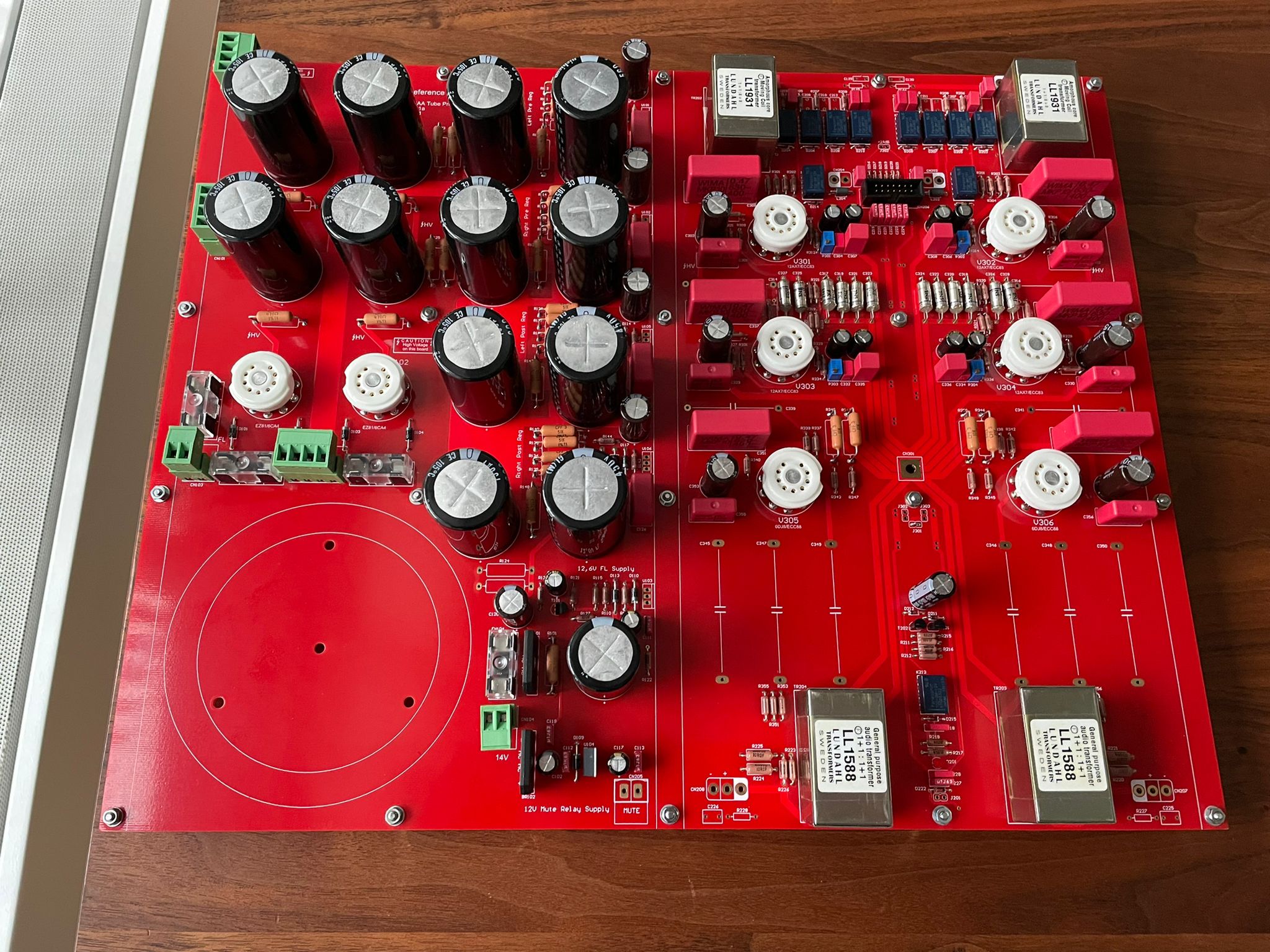

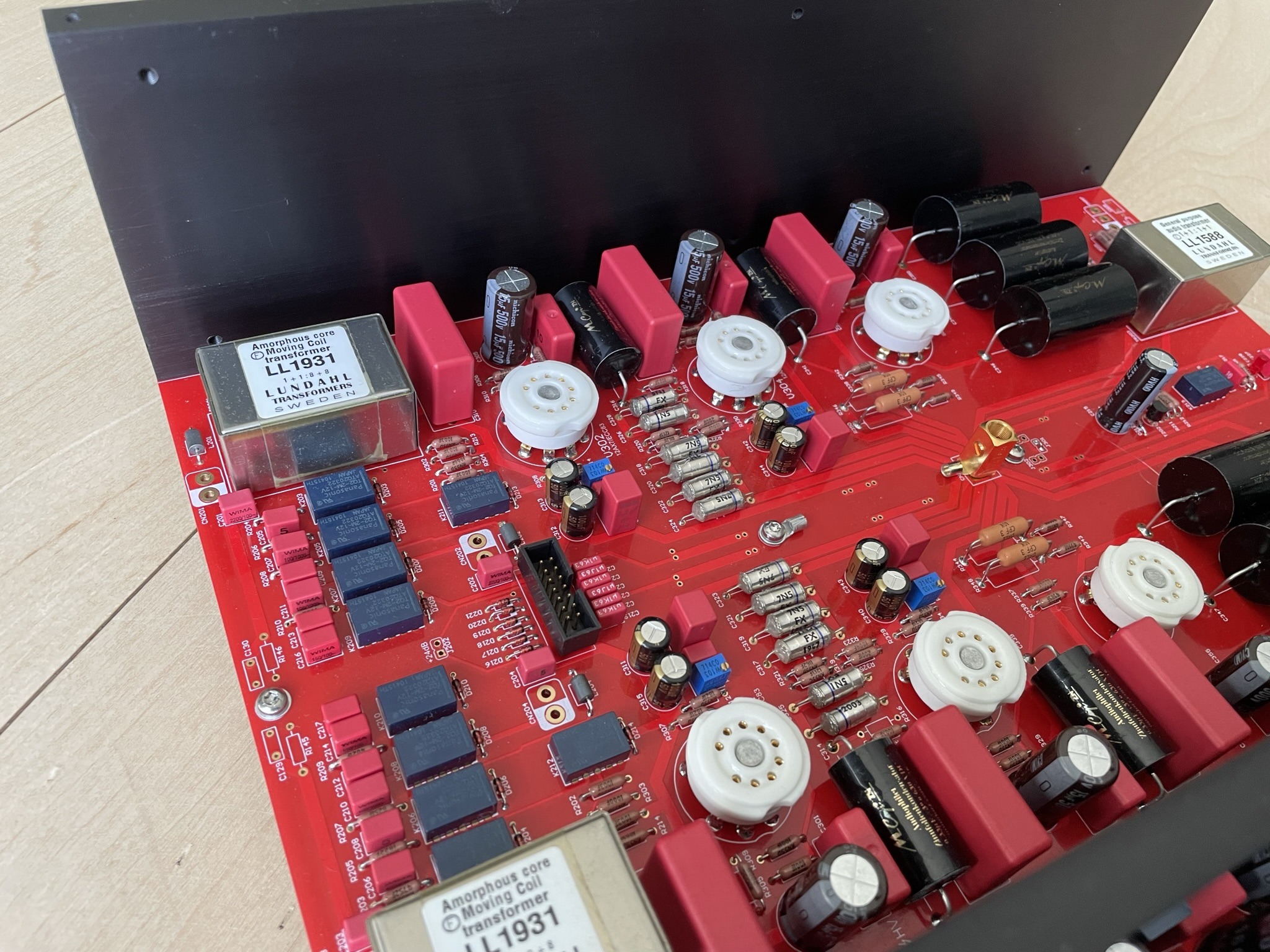

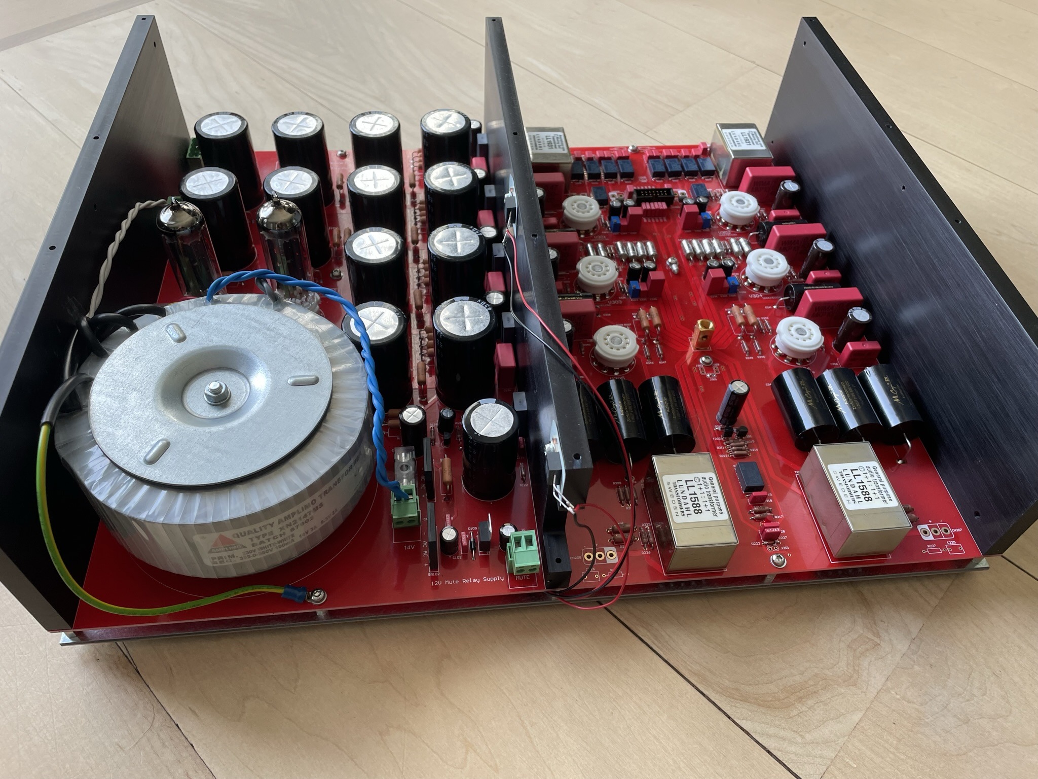

So last weekend my friend and I have been working on the main boards see attached pictures for the result.
Missing a few components, and the metal cooling plate in the middle that you see on the proto will be black anodized next week.
Then we can test again, and work on the housing.

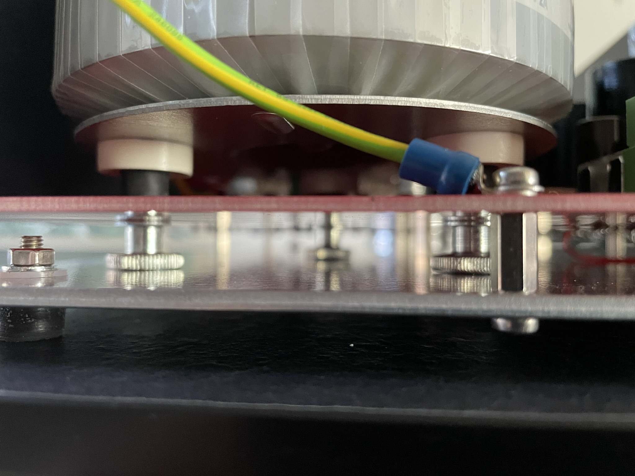

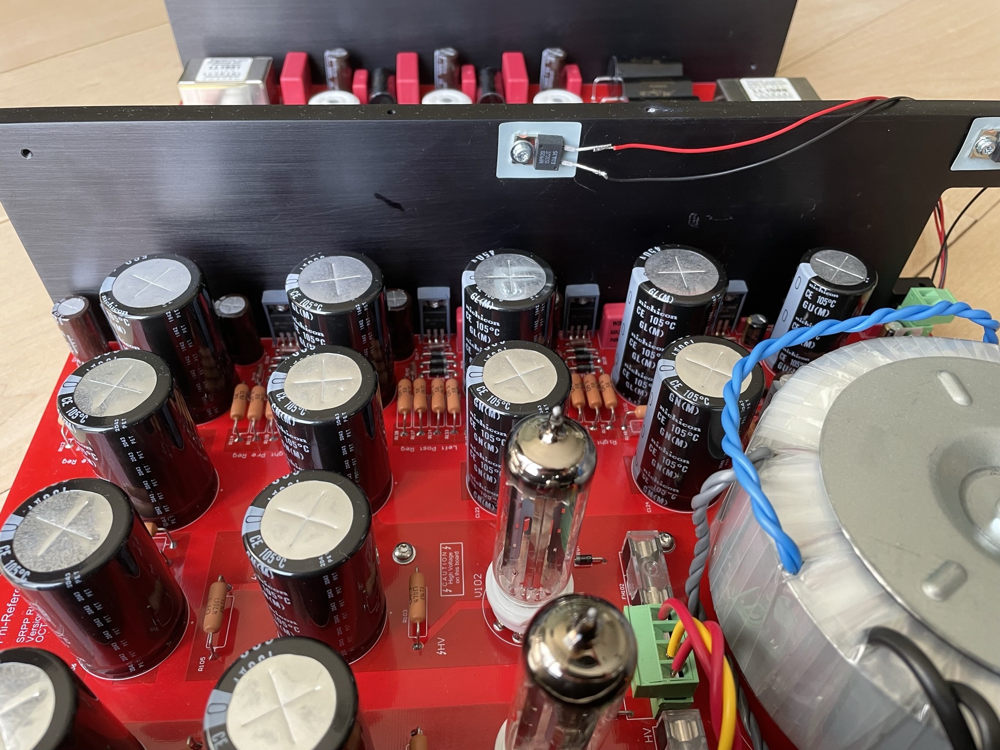

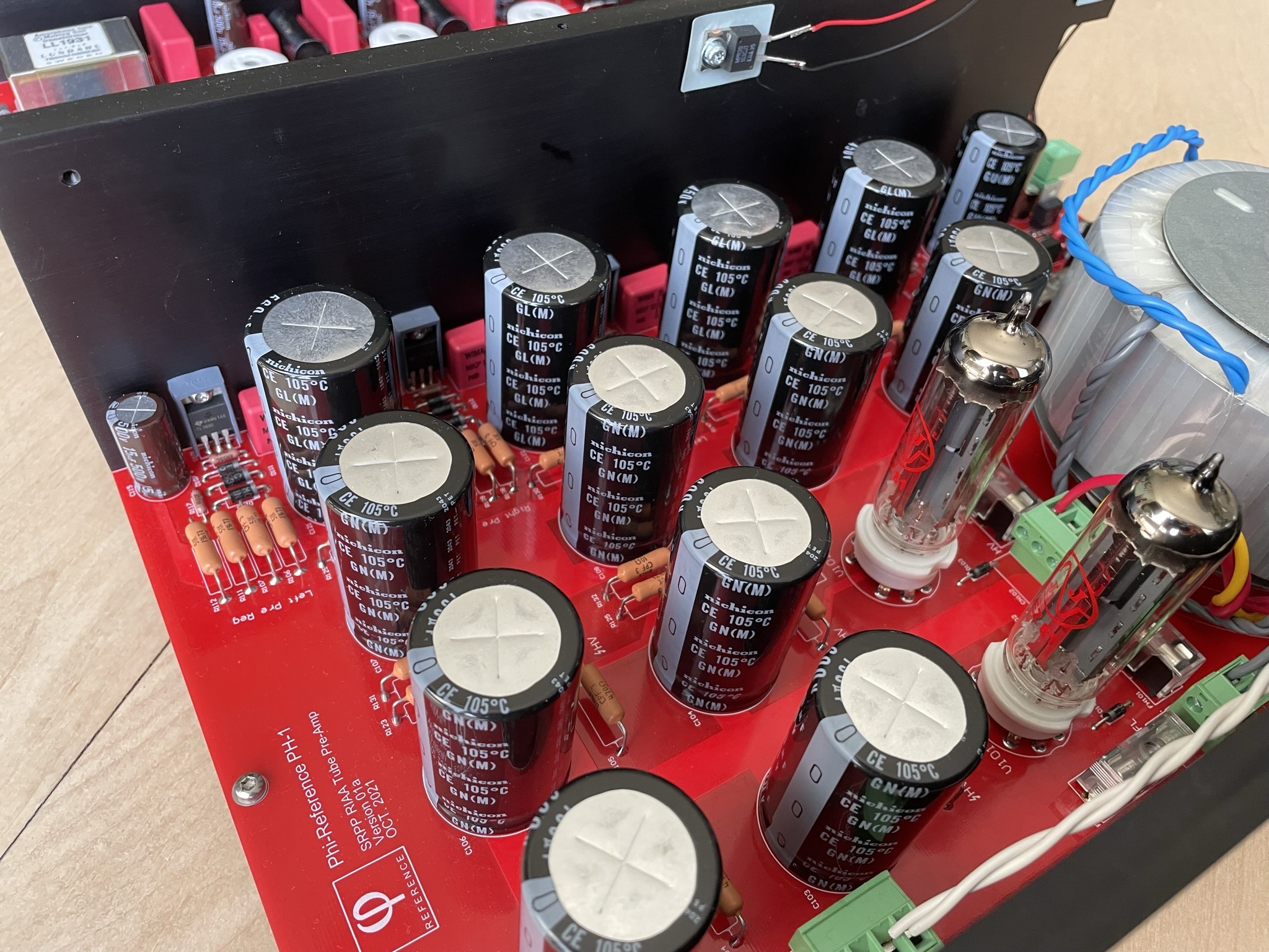

A small update:
Last weekend we tested the power supplies as the anodized 10 mm thick aluminum plates came in. The middle one is used as a heatsink where you can see the regulators (well isolated). All worked fine after finding a wrong value resistor in the 12,6V regulator.
The high Voltage Supply starts with 420V unregulated after the Tube Rectifier, then 335V voor the SRPP input and gain stage, and that voltage is again regulated for the paralel Cathode follower output buffer to 250V DC
There are also two temporary load resistors connected to mimic the load on the regulators (dissipating around 4 watt each), they will be removed when the amp is running.
The M3 holes in these black plates are there to experiment with additional steel shielding. Initial proto test of moving the shielded transformer away from the circuit did not seem to make any difference, but we will test this when all is mounted into a chassis again.

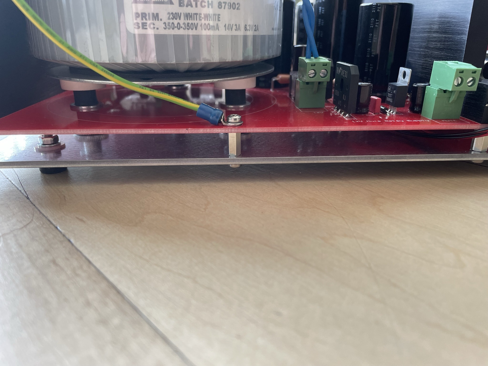

The transformer is elevated using rubber stand-offs to isolate mechanical hum from the PCB.
The whole PCB is mounted with 20 pieces M3 stand-offs to a 3mm thick galvanized steel plate (heavy). That plate (a sub-assembly) will be mounted on again rubber stand-off directly on to the feet of the chassis.
next: testing the amplifiers
Peter

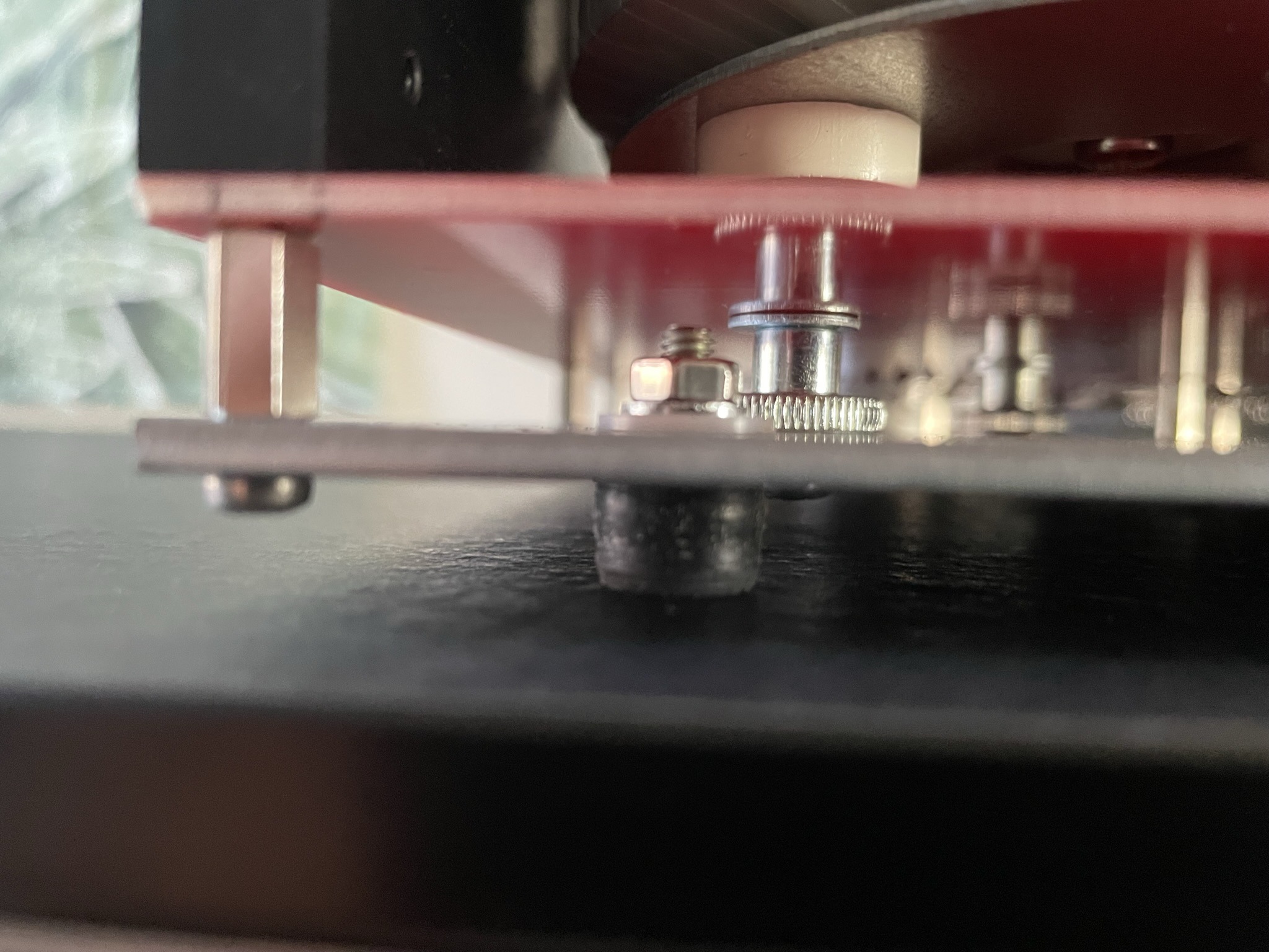

Peter

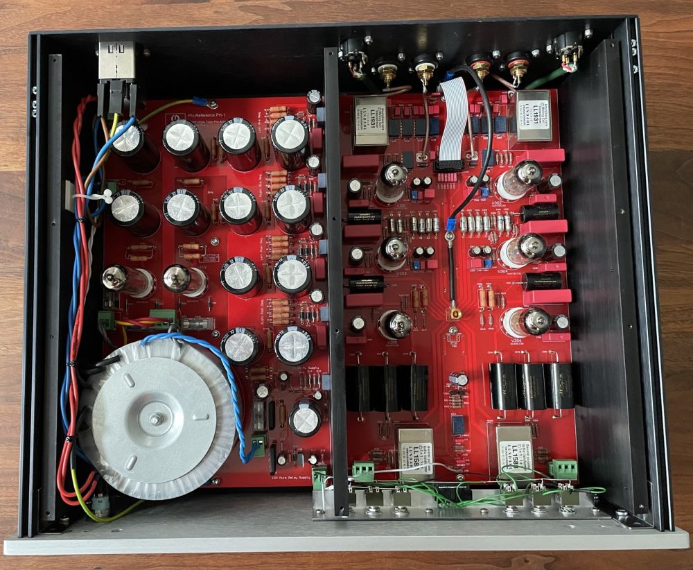

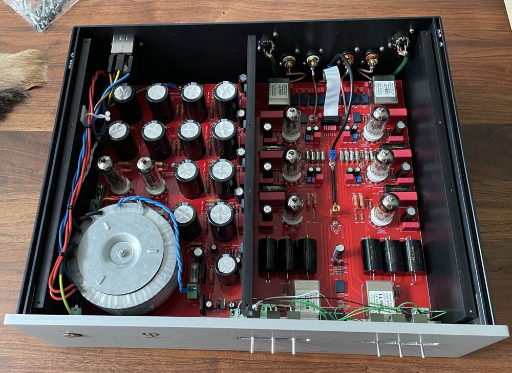

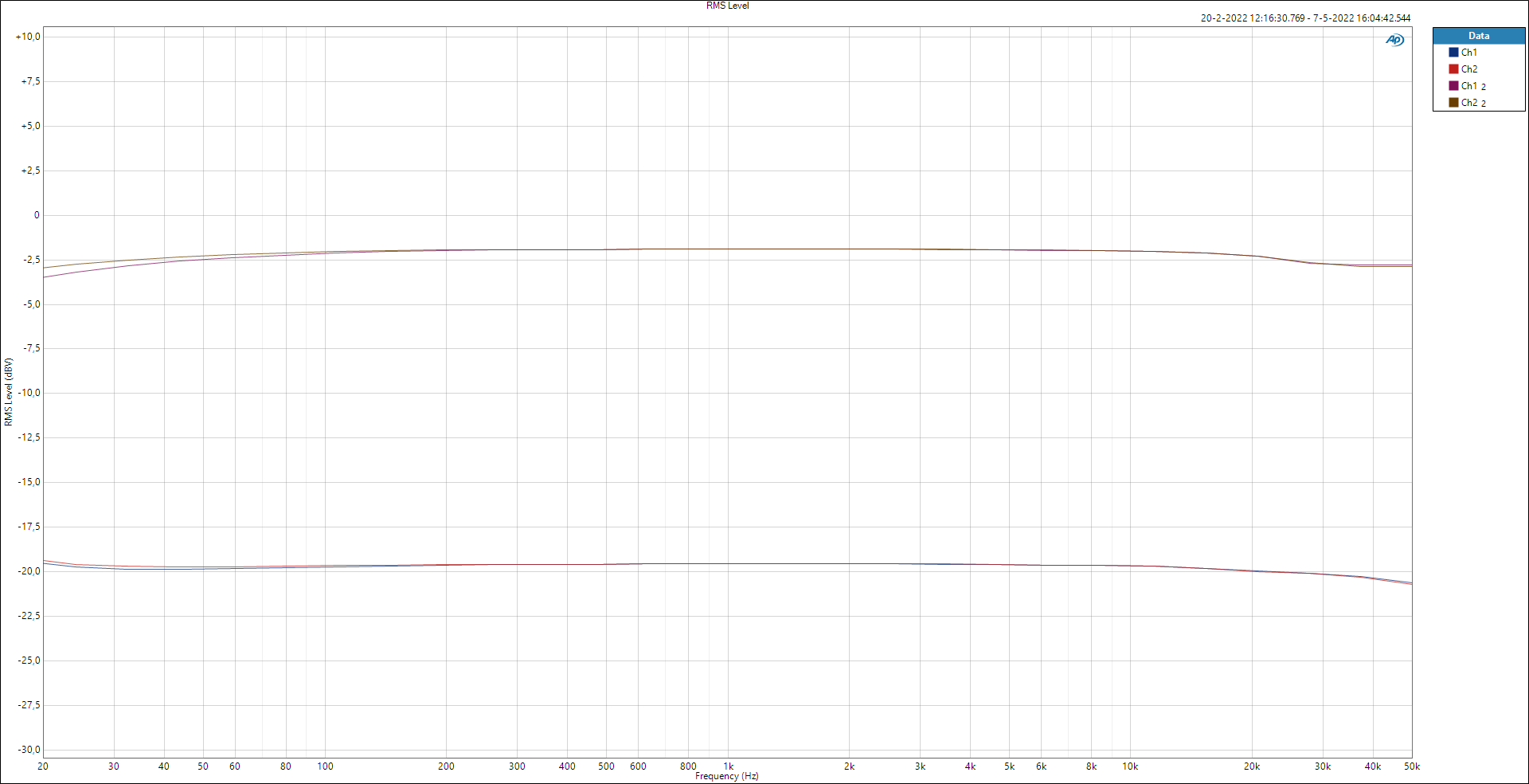

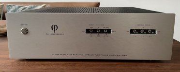

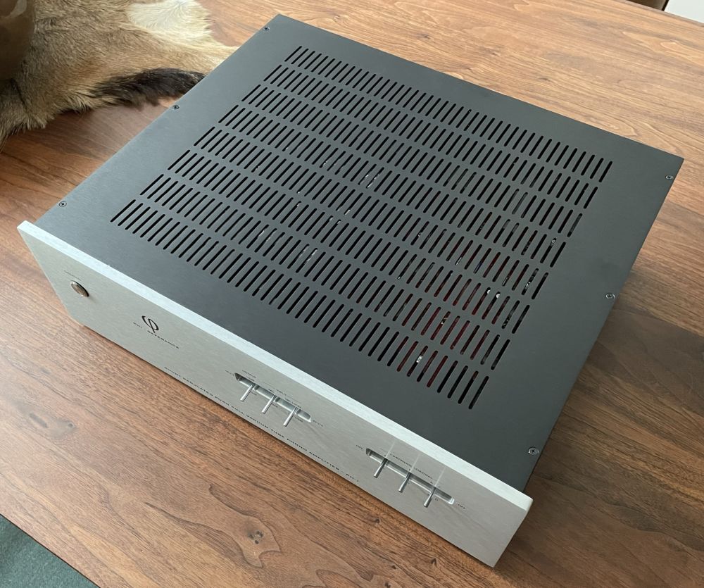

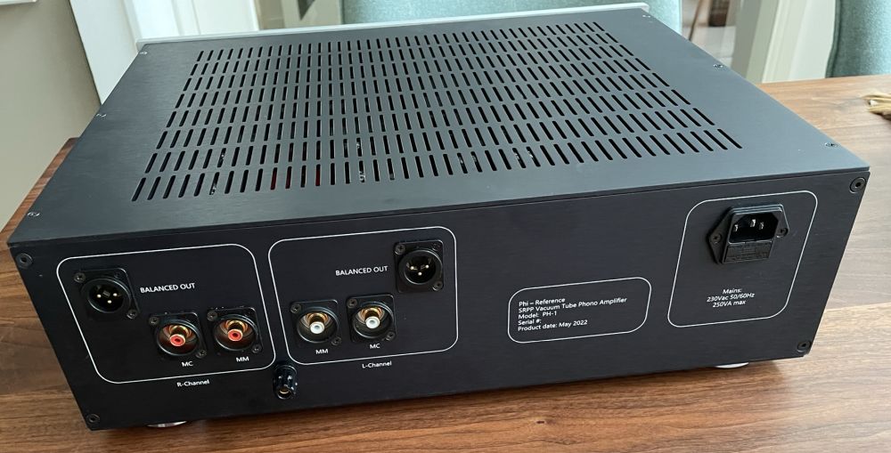

At last, the unit is done.
Way more delay than I hoped on mechanics, silkscreening and a full day of work assembling all parts and making the logic work.
The result is great though.
Upgraded my Micro DD-7/MA505 with an AT33PTG/II and used that for testing.
See below pictures of the unit and the measurements.

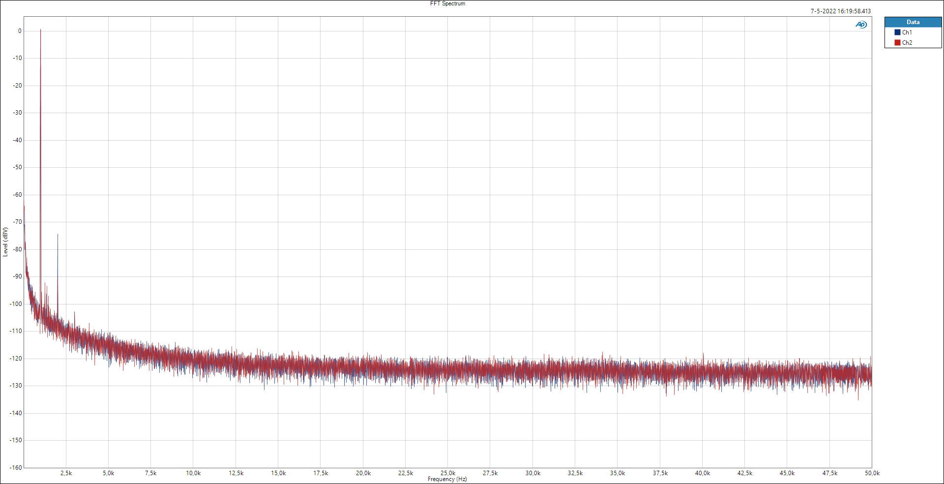

An FFT of the MM input (the stage with no SUT.
And a frequency response of MM (bottom traces) and MC (top traces) ...... quite flat and very equal.
The rest some shots of the end result.
The result .... it sound great. Had only an hour or so to listen, but it is clean, transparent, very wide bandwidth. It has body, nice extended controlled LF and very clean and extended high. But voices are the most impressive.
Peter
Peter
