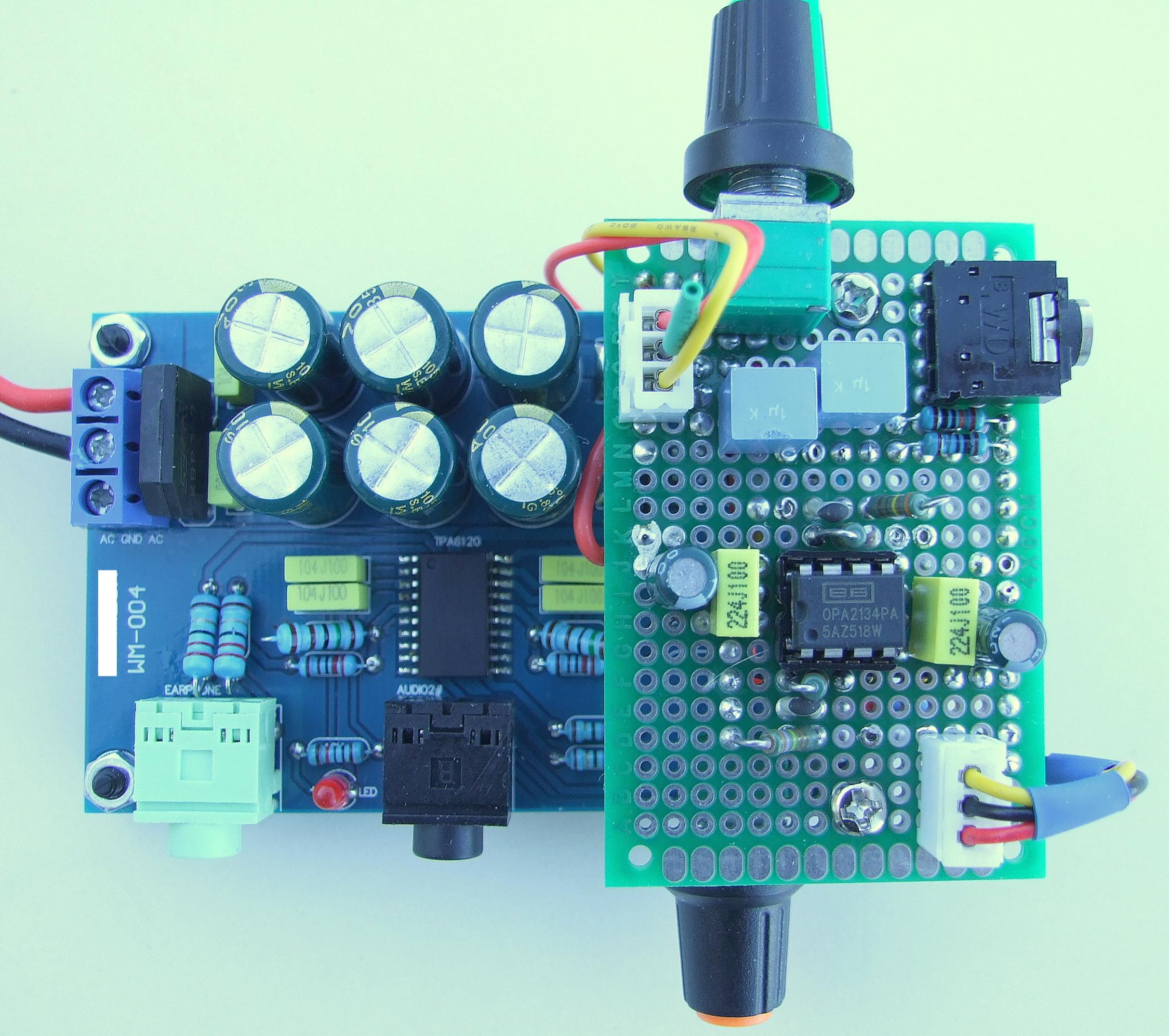

I noticed a low-cost headphone amplifier board based on the TPA6120 chip. The TPA6120 has a THD that reaches below 0.001% and can handle low impedances with a high output level. Evidently, the board can also be used with headphones.
The board was at a very modest price and included a full symmetrical power supply ready for a trafo or a symmetrical DC source. The amplifier part included only the TPA6120 chip, no other active components. I had to find out if such would do.
The power supply functions without concerns. The amplifier works but with one rather important drawback – DC offset at the output. The TPA6120 chip is configured as a non-inverting amplifier and, as recommended by TI, with low impedance resistors in the feedback path. TI recommends similar low impedance for the non-inverting input. But, this board is aiming at a high input impedance through use of a 50KOhm volume potentiometer at the non-inverting input. Such very different impedance levels seen from the two inputs easily end up in important DC offset at the output due to input bias currents. As the board was supplied as a kit, I never used the 50KOhm potentiometer but settled for a less demanding 5KOhm potentiometer. Even with 5KOhm, the DC offset at the output exceeds 50mV. With 50KOhm, the DC offset will be considerably worse.
No miracles in the amplifier part.

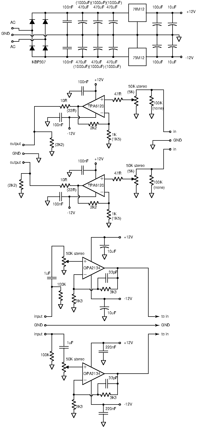

In the schematics below, the upper circuit is the power supply and the middle circuit the amplifier part as supplied. The values in parenthesis are the values I finally used. The lower circuit is a buffer circuit I added to overcome the DC offset problem.
A TPA6120 chip needs a low impedance input circuit, as shown by TI, such that an input buffer before the TA6120 is pretty mandatory. I made such an input buffer using an OPA2134 in non-inverting coupling and with a gain of two. With this buffer amplifier and the 5KOhm potentiometer turned to max., the DC offset at the TPA6120 output is around 2mV. A pity the board does not include such a buffer circuit before the TPA6120.
The board can be used as a pre-amp without the buffer stage if the power amplifier is not DC coupled. But for a headphone, the DC offset without a buffer stage is too much.
With the modifications I made, the board sounds great. Both as a pre-amp for a power amplifier and with a headphone. Probably as good as my Musical Fidelity and Argon headphone amplifiers. For some 15 USD, I now have a test pre-amp for (almost) any power amplifier I will make.

Personally, I don't think that hanging any value volume pot in front of a TPA6120(or any other current-feedback amplifier) without some type of coupling cap, or buffer op-amp, in between is a good idea.
But...if your intentions are just for testing power amps and the offset is acceptable, then it may be suitable for your needs.

After looking at the "CIRMECH" board the OP linked to above, I can now see why the price is so cheap.
A properly designed TPA6120 PCB will almost always use SMDs around a very fast op-amp like the TPA6120.
In addition...nobody in their right mind will connect some cheap(or not so cheap) volume pot connected directly to its noninverting inputs.
If you can live with the varying offset and "rustling leaves syndrome" that results from having too much DC on the the pot's wiper, then this may be the best buy around for a TPA6120 board.

With the TPA6120, as well as many other CFAs with high input bias current, there will certainly be DC on the volume pot's wiper whether you hear any "volume knob sound" or not.
