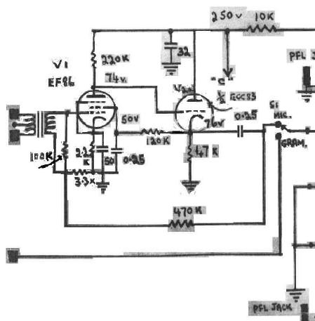

I'm not sure "totally different" really applies. The stage (as shown in your figure 2) is a shunt regulated pentode. This is essentially the topology provided by Cooper in his 1951 paper "Shunt Regulated Amplifiers". It's essentially the general form of Cooper's configuration 2(e). The major difference being that the regulation feedback is provided by slaving the pentode screen grid voltage to the regulator output instead of using an additional impedance to sink additional current in the regulator.
It's an interesting approach to the stage regulation and should be able to source significant drive into a varying impedance. In any event, the circuit should be applicable wherever driving varying impedance loads (as in modulators or class A2 amplifiers) is required. I'm not sure of the advantages in a pure voltage amplification mode however.

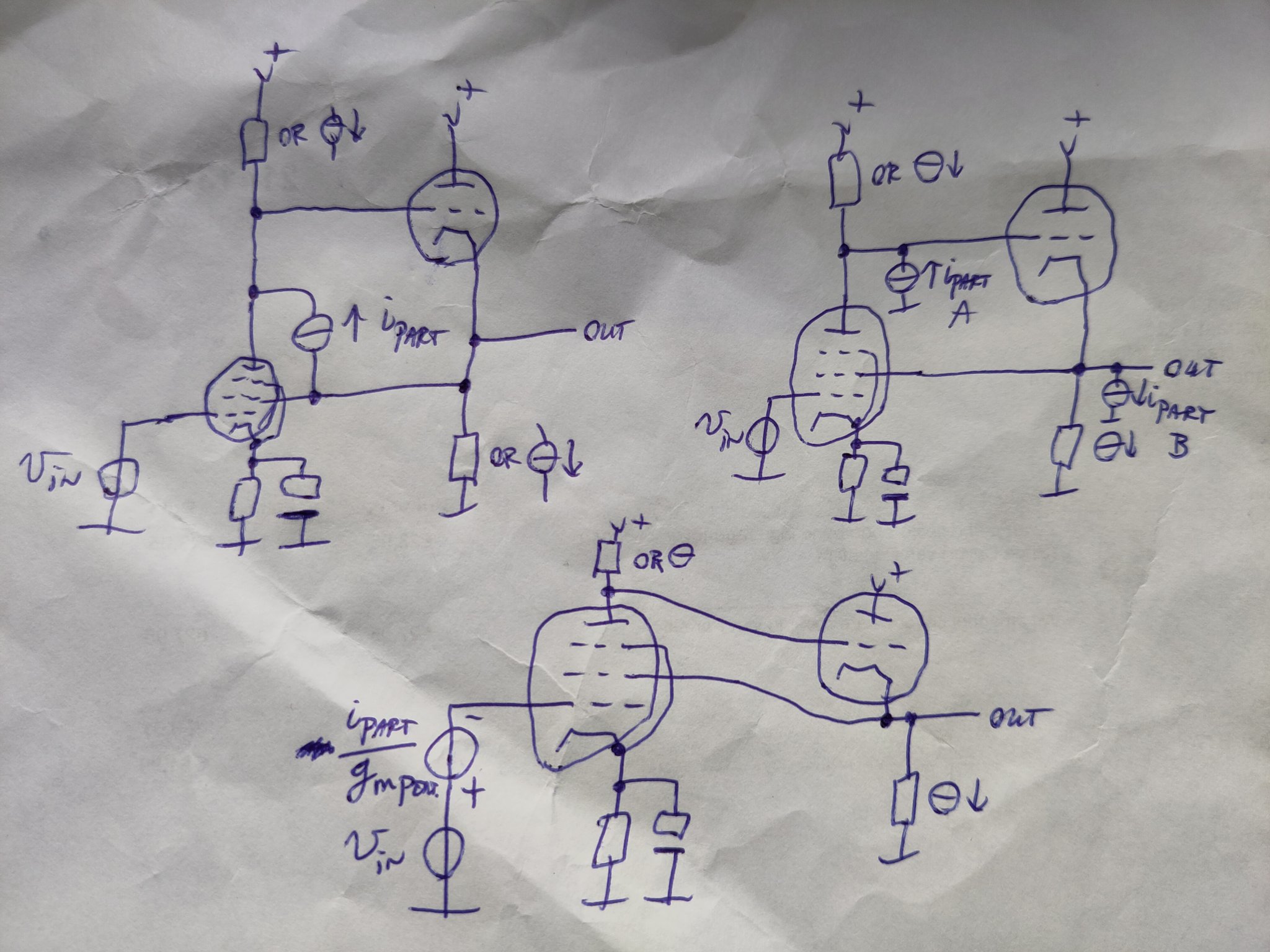

Not in my noise transformations. You simply get the full partition noise divided by the transconductance of the pentode as contribution to the equivalent input noise voltage.
The cause of partition noise is that electrons randomly fly to the screen grid or the anode. It can be modelled with a noise current source between screen grid and anode (upper left schematic).
You can split the current source into two fully correlated noise sources to ground, see the upper right schematic. Noise current source B is across a low impedance output, so it does practically nothing.
Noise current source A can be transformed to the input in the usual way, leading to a negligibly small equivalent input noise current source and an equivalent input noise voltage source, just like for an ordinary pentode circuit.

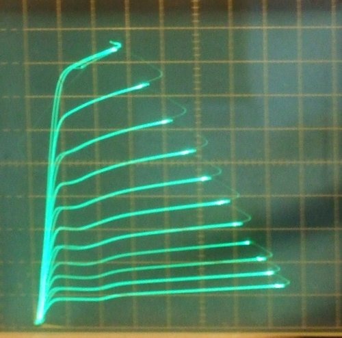

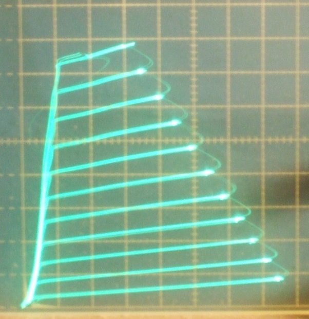

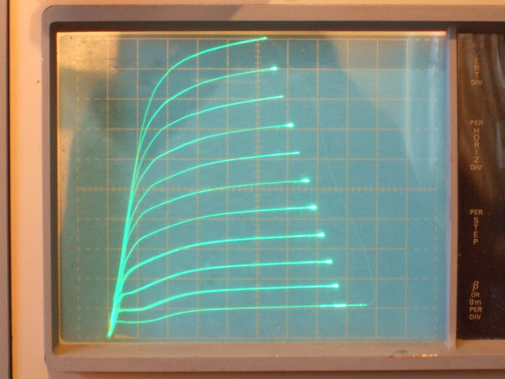

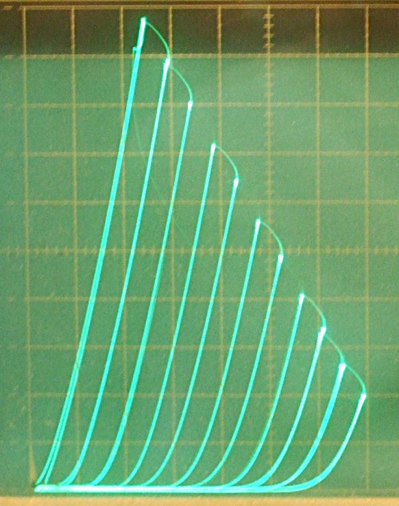

Here is an example of highly effective use of tailored screen current , JJ KT77:
2nd curve trace, I believe, is of a different pentode (21HB5) -with- the screen current combining. Notice the lack of any kinks.
And 3rd curve trace is of the 21HB5 -without- any fixes:

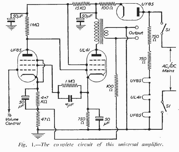

Yes, I think everyone comes up with this circuit at some point in their career. You don't see it in its naked form in old designs because it was more conventional to just run the pentode in ordinary triode-strapped mode, followed by a cathode follower -basically the same end result. You do see some circuits with screen feedback from a cathode, but usually it was decoupled so only the DC was regulated, or where a screen resistor dropped the screen voltage. Nothing new under the sun.I'm not sure "totally different" really applies. The stage (as shown in your figure 2) is a shunt regulated pentode.
