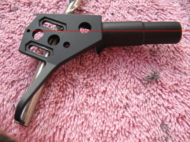

gabby, your headshell is wrong!...
your headshell is bent about 6° (angle A) too much. Dtermine the arm length, find oa arm of similar length, set an O/H distance, then look for an arm and use that O/S angle.

Hello Nannok
Now I'm confused.. Because all your lines are red now I'm not sure which would be the right angle
Can you mark the right angle with diferent color please. I ask these because I plan to make a new head shell from 2mm tick titanium so not to mess up that.

About the cartridge angle I can adjust that . Please look at the blue line I ad. The blue line parallel with your red. Those screws let me to adjust the angle. The 2 screw attached to the hand lift not to the head shell.
Or the stylus must be in the center of the arm that is a rule?
I think I can use it as a 9" arm.🙄 If you not advise I'll make another head shell in that way so I can adjust that angle more.
That angle on the red paper is important because I use two arm. I must know how big must be the plinth..

correct angles...
The angles are measured from a horizontal line to the angle indicated they also correspond to the O/S angles. The bottom diagram is what seems to be there now. The middle diagram would be accurate if the long outside edge is parallel to the centreline of the tube. The top diagram is if the short inside edge is aligned with the centreline of the tube.
This of course assumes that I traced out the headshell correctly. If you follow the method I used for my tonearm, all I did was mount the cartridge, guess where the tonearm pivot should go, based on a 15mm O/H. I then verified it using the Oracle protractor.
The top diagram is not to the correct scale, but the angles are still accurate.
Once you set the tonearm length , and assume a O/H distance, then it can be pretty easy to place the tonearm base/pivot.

Hello Nannok
You right, I did measured to the Dual 505 II and really out of angle.
How did Thorens used that with straight arm? These useless and I paid $70 for it. Thank God the Shure V15 type IV cartridge is good came with these arm.
That will return my money hopefully.
If I see that earlier I would not cut the arm..
Can you post a picture from your arm please from the cartridge side. If I see well you went all the way straight. If any trick there please explaned to me..
If I can use traight arm with the type of head shell U use that would be the best.

I just received the Linn head shell, I believe these accurate so I can go after these to make my ow head shell
I did a mark one picture, it has a red line. Be careful because the head shell a bit in angle (because the finger lift) does not let to lay it done in level
These weight 9Gr.
I did measured some of my graphite tubes
1 Thin end 8.5mm thick end 11.5mm 14" long weight 24Gr
2 Thin end 11mm thick end 14.5mm 16" long weight 28Gr
3 Thin end 12mm thick end 15mm 16" long weight 28Gr
Al three tube with out head shell the length.
Can I use any one of them or they still weight to much.
I can buy nice carbon tube 9mm thick 1mm wall thickness
Also he has 13mm thick 0.5mm wall thickness
I think these two carbon tube would worth to buy and then try them.
What do you think?
Thank you
