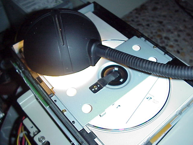

I twice ripped a track from the same CD with EAC. First with a closed CDRom drive, second with the drive opened. I put a strong lamp on top (not a colored LED) of the drive to illuminate the CD.
I compared the two waveforms with Audition. There is not a single bit of difference between both rips.
Let me know if I didn’t understand the purpose of this thread since I don’t want to spoil the fun. 🙂

Netlist said:I compared the two waveforms with Audition. There is not a single bit of difference between both rips.
You compared the waveforms afterwards? Why that? Of course they are identical, it's EAC, after all! 😉
Of importance here would only be the time EAC needed and the average quality (or number of retries) EAC reports after finishing...
Sebastian.
A lot of CDROM drives can report errors to the controller. You might be able to find software to tell you how many errors occurred during a rip.
Of course, error correction on CDs works well, so it seems unlikely that anything that happens during the reading fo the CD is going to improve on that. When a CD can't correct the error it interpolates. When enough samples are missing that it can't interpolate, nost CD players mute the output. That's a pretty rare occurance in my experience.
The only thing the light could possibly do is improve the already miniscule error rate, so why bother? I suspect it's is a marketing gimmick.
