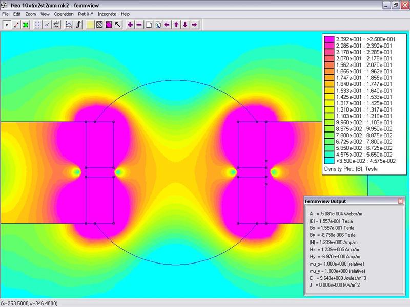

Hi Bear,
I've attached the FEMM flux density plot from the discussion thread on this ribbon. As you can see, the two magnets on each iron pole side have identical field orientation, just separated by a small gap. As illustrated in the flux density plot, the dual magnets provide a vertically wider, horizontally more uniform field in the center of the gap. This can provide both a more uniform force in this center area, and also a modest self-centering capability. If you look closely at the center flux density plot right at the magnet-magnet gap edge you will see a very large drop in flux which could result in non-linear drive force.
From my past work, one magnet of the same volume at each pole would produce about 20% higher flux density than the two-gapped magnets, and with no edge flux drop. A single magnet, however, would have a greater vertical flux gradient than the two-gapped magnets. I compensate for this on my midrange ribbons by using a wider magnet which also creates a more vertically uniform flux. Tweeter ribbon sonic performance usuallly suffers from a deep cavity.
From my experience, this type of 2-magnet topology is best suited for physically wide, high excursion midrange ribbons. The Apogee Full Range used this on their 2" x 84" midrange ribbon that covered 320-10,000 Hz. It is covered in the Apogee patents. The 2-magnet topology puts the ribbon deeper into the cavity, which is considered non-ideal for tweeter ribbons but an acceptable compromise for midrange ribbons to achieve a wide, strong field with self centering.
There are other techniques for ribbon self-centering.

LineSource, thanks for the insights... I would think a polepiece of
appropriate design might improve the relationship between the magnets and the gap?

I'm the one responsible for these ribbons and of course, the apogee ribbons has been a great influence when brainstorming this project. I'm using regular household aluminiumfoil (0,0105mm)and 0,002mm mylarfilm for the ribbons. The main reason for the two rows of magnets is too create an even magnetic force over a large distance. The articles will be available in english at my website when they are finished.
