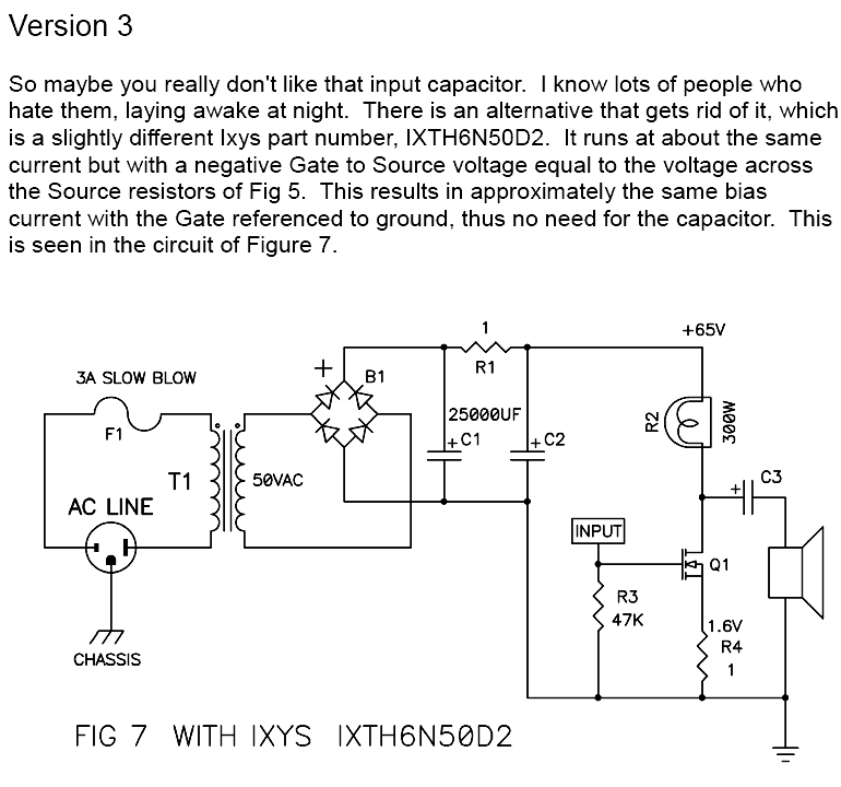

Can someone please steer me towards a suitable transistor substitution for Nelson’s simplest delite amp. I’m not real concerned with the audio quality (perhaps wrongly), just that we get that magic moment when music comes pouring out of the speakers. Kind of a “hay look what you can do” project.
From Nelson’s Delite article, “This transistor is an unusual part, the Ixys IXTH20N50 depletion mode Mosfet. I got them from Digikey for about 6 bucks (and I had to buy 60).”
When I priced them they at mouser.com they were $21 and I had to get 30 and they were out of stock.

...“This transistor is an unusual part, the Ixys IXTH20N50 depletion mode Mosfet....”
http://www.firstwatt.com/pdf/art_delite.pdf

{sigh} Did you even look for the Fig 7 device, IXTH6N50D2? Mouser has 120 to sell one by one, six bucks.
{what I was gonna say} The description may be more helpful than the actual part #. Putting "depletion mode Mosfet" in Google turns up hits. One at Mouser, where you were. They come very small and very large. Selecting Pd 20W-100W gets all sub-Amp devices. Selecting Id >1A gives some oddballs, but IXTH6N50D2 and IXTH10N100D2 are promising. IXTH10N100D2 will sit at 1.5A with -2V bias, which is the right ballpark, except return gate to zero instead of to source. SADLY this is the 12-buck part, but they do have 120 and will sell you just one.

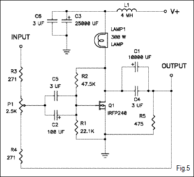

Looking at fig. 5, am I correct that C1, 2 and 3 are electrolytic caps and C4, 5 and 6 are film caps?
Sticking with the IRFP240 transistor, it’s only about $2 at mouser 😀

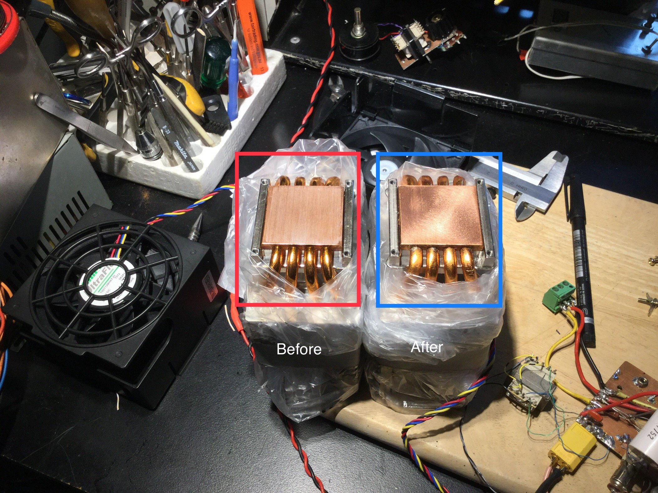

I do have a heat sink question.
I have a heat sink that was used for an old desk top computer (Intel® Celeron Dual-Core 3300/2.50GHz). It has a copper base and four heat pips that pass through 32 plates. The plates are 3.5in x 2.5in (9cm x 6.5cm).

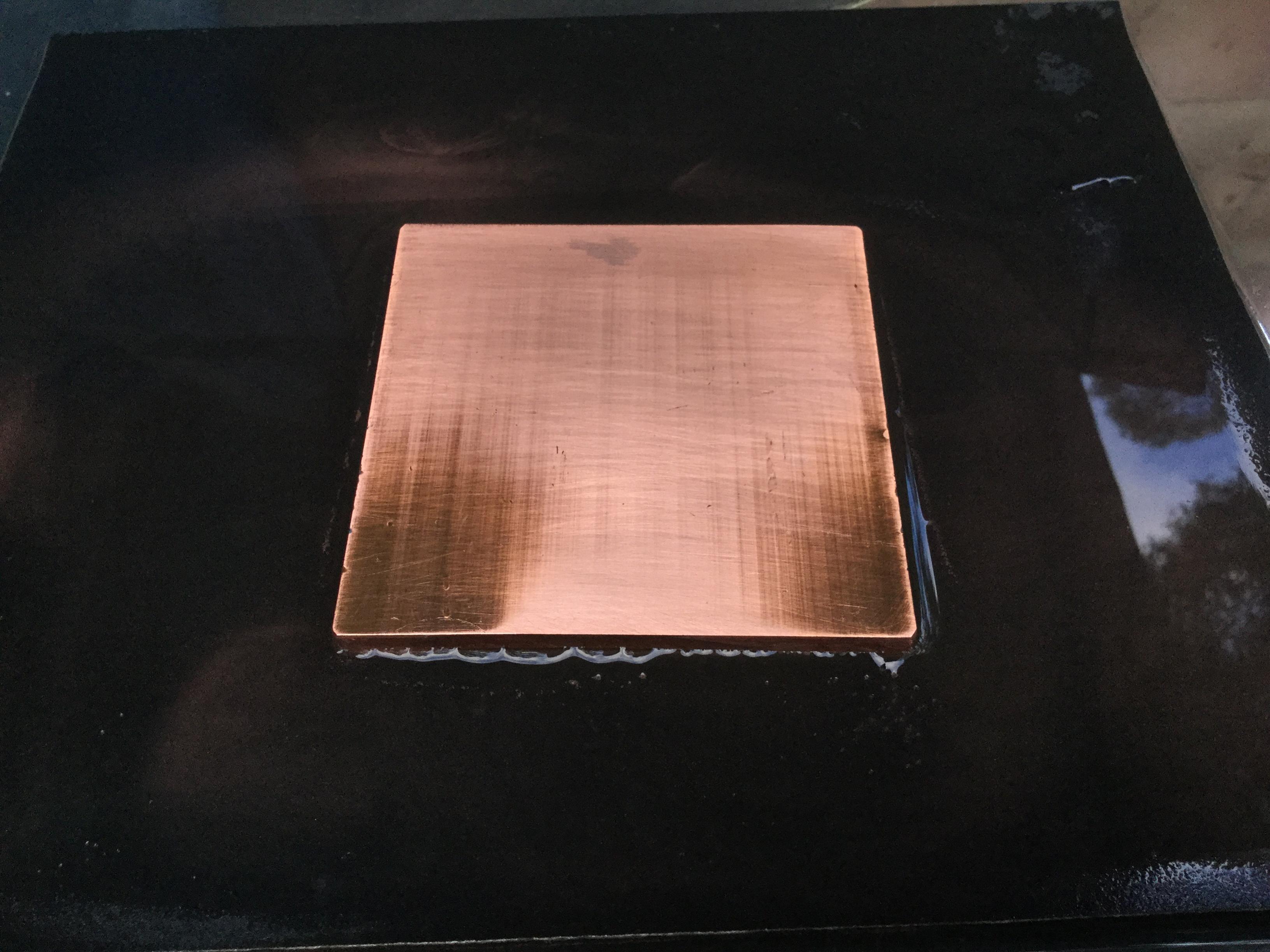

My CPU heatsink copper plates had a poor surface finition, means poor heat transfers.
I treated them with my elbow grease (wet sand paper).
Extra measure has to be taken for active cooling system, an NC thermostat (a dollar or so) in series with the PSU in case of malfunctioning or forgot to turn fan on.

So I was looking at transformers (100 VA 20V) to get +/-28 V, so I’ve got 56V to power the amp. So I run close to 1A through the light bulb that acts as a 40-50ohm resistor to bring the voltage about 12V to feed the collector. (Do I have it right so far?)
So my question is why not ditch the light bulb and use a 12V supply? (Yeah, I know the light looks cool �� but it’s a more expensive transformer)
In this amplifier the voltage across that transistor is only 12v if no signal is being amplified. But when you are amplifying a signal the voltage across the transistor is changing perhaps from 2v to 30v . That light bulb just acting as a big resistor allows
for this voltage swing across the transistor. Without this swing there would be no ac
output that is NO music .
