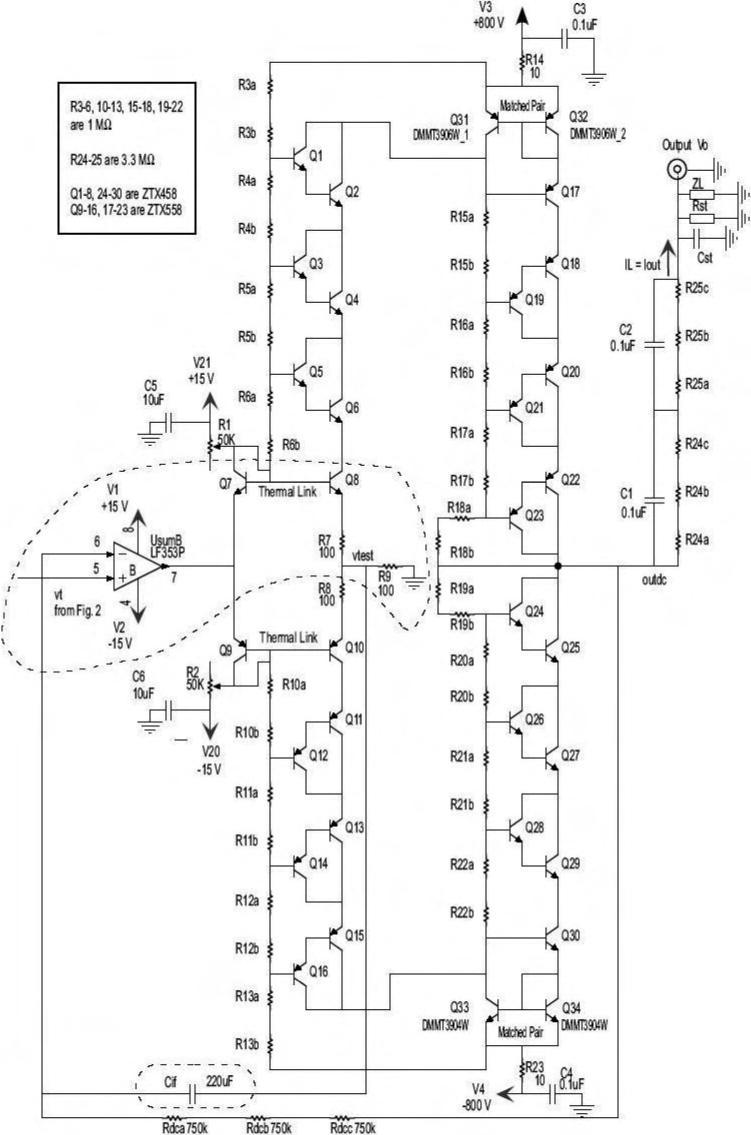

Alright Thanks.
The values of the capacitor and diodes were calculated as follows:
Max voltage of each capacitor is 110V * 1.414 * 2 = 311V
Used 400V capacitors and 1000V diodes.
The power supply is designed to have 1% ripple and 8% regulation @ full load.
Calculated capacitance is 29.xx µF (Used 33µF)
I AM actually aware that I need a resistor at the outputs to limit current because of the charge in the capacitors. That will be installed before I progress any further in this project.
But besides that I don't see anything wrong with the components, mind explaining a little?

The load is the amplifier which requires microamps to work.
I see your point, I'l put this on-hold until I learn more on the topic.
Thanks.
got schematic?

I have a rough sketch on paper, I'll draw it on the my computer for better legibility later today.

What are you planning to use for the amp BJT's or FET's?
Either will work, But I found it very easy to stack FET's and they are much cheaper than BJT's as well as you can get them in some very nice High Voltage ranges.
Although I am not sure how well they will work in the microamp range but they should in a few millamps (5ma to 20ma or so) range okay.
A combination of both may work very well.
There are several topology's to look at that may work well and stacking of devices is almost a must for that high of voltages, even though you can get FET's higher than 2.5kv now, but it is still a bit costly for those types.

Wow, Never thought someone else would take on this project!
Just saw your PSU in the other thread, Very cool!
how much current can it supply?
I'll be using BJTs in a 5-step cascode (See schematic)
The 2SC4686A's I'm using will work in the µA Range.
I haven't measured the output current yet but is quite high.

This is the beginning to the previous link,
http://www.diyaudio.com/forums/head...discrete-class-headphone-amp.html#post2589794
I never went any farther than about 200v as I had other things that I had to do first.
But I did prove the concept by stacking about 4 or 5 FET's.
And I drove a Piezo element with two circuits in push pull.
It was quite loud and clean and I thought the element was going to crack but it didn't !!!
I have such circuits already drawn up and simulated in Circuitmaker for the 3KV to 5Kv range, But I just haven't got the parts to try them yet.
LTspice would be a good place to start for designing such a circuit as the whole stack could short and blow up losing a whole bunch of parts if not all of them in one instant.
All it would take is for one to go bad for a domino effect to occur.
I started at a lower voltage until I got the voltages stages balanced and equal then I brought the supply up another step and rechecked and adjusted everything until I got to 175v (160v to 180v).
My supply consisted of the same 25.2v radio shack transformer that I used to power my variable bias supply with a diode multiplier of 4 to 6 stages.
I don't remember exactly how many as it was about 5 years ago when I did it.
This was before I learned how constant current sources worked that is necessary in order to eliminate the costly power resistors by using FET's instead.
The use of load resistors is fine providing the current is low.
I have another schematic that I got from another forum that is along the lines of what you are trying to do and it uses a bunch of ZTX458's and ZTX558's stacked up and driven from a opamp on a +/- 800v supply and could be expanded very easily for higher voltages as well.
If it works as I would like to try it myself.
I will search for the JPEG and post it for you.
jer 🙂

you can not run your corona through zero volts, because it will extinguish. assuming that you are not making the corona with an DC or AC voltage as a bias... in which case what you want looks like a modulator for RF.
