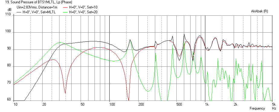

So I am taking one of my favorite deep bass extension MLTL designs that is flat as board and running it head to head with a Karlson. What I found surprised me.
Basically, if you are in smaller space like a room in a house, the MLTL is a great design as it lets you put the speaker right up against the wall. The first plot is the Betsy K in a 45 in tall MLTL (11 in wide x 16 in deep x 1.625 in tall x 11 wide x 4 in deep port at bottom, driver 9 in from top), speaker cabinet is flush against a wall and listening position is 1 m away. This is perhaps one the nicest frequency response curves I have of ANY design I have simulated and is consistent with Bjohanessen's WIBAQ.

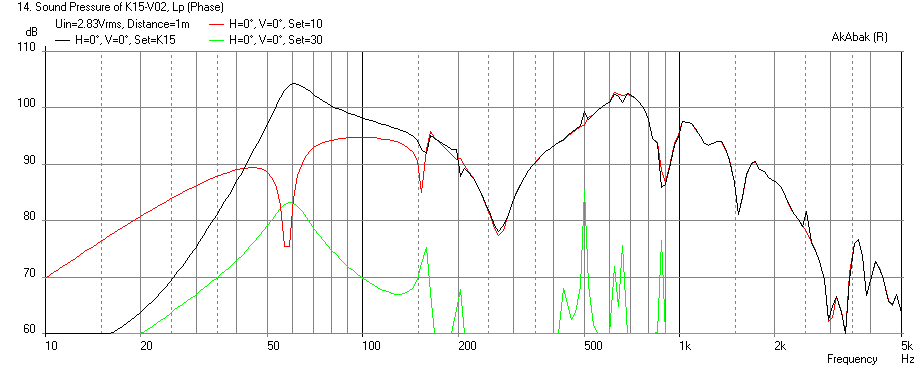

Next plot, place a K15 with Betsy K flush against a wall and listen 1 m away and it really sucks. Very uneven frequency response.

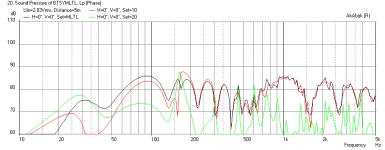

Third plot, let's put the speakers away from the wall at 60 in and stand 5 m away from the speaker - something similar to how speakers might be used in a PA setting like a wedding. The Betsy K MLTL doesn't look so good anymore, bass has dropped and response overall very uneven. Most importantly, the ever important 50 to 60 Hz bass region that provides a lot dynamic punch is almost all but gone (75 dB) and peak bass has shifted to 90 Hz and is only 85 dB.

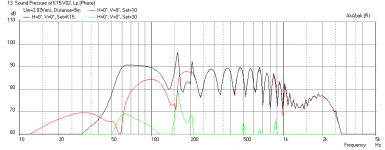

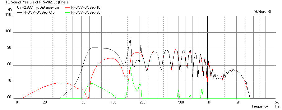

Fourth plot, put the K15 with Betsy K at 60 in from wall and listen 5 meters away. Notice the sound level is about 90 dB at 5 meters away. The response also has a pretty flat bass shelf to give a nice clean tight punch to the bass notes from 60 Hz to 100 Hz. Now that is something special! I don't know of another speaker with a $55 driver that can throw that kind of bass that far with 1 watt input!

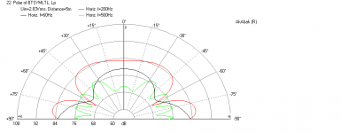

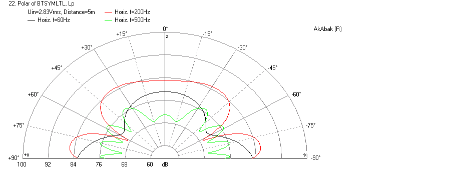

6th plot shows the polar SPL response at 5 m away for the MLTL at 60 in from wall, for 60 Hz, 200 Hz, and 500 Hz. The response is not very goo at all.

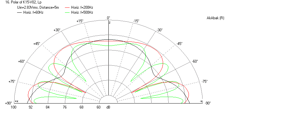

7th plot shows the polar SPL response at 5 m away for the original K15 at 5 m away for the same frequencies. Notice how close together the responses are over a pretty wide sweet spot.

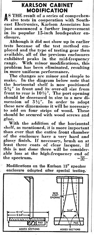

had to look at one of my blonde K15's - their stock vent is 8.875" tall x 4.5" wide. I had a K12/Karlsonette copy, blocked its regular horizontal vent and introduced a rough rectangular vent with only around 7 sq.in. or so area - that seemed to cause quite a suckout. Vent placement probably matters somewhat besides vent area. Acoustic Control made a little 15" K-coupler about the size of the Karlson X15 system with a 27 sq.in. vent which measures reasonably well. I don't know how 115bk might perform scaled.

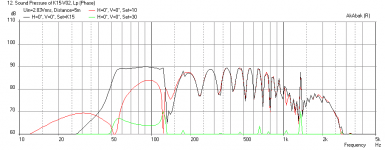

Is your K15 model flexible enough to adjust only the rear chamber volume without bothering other parameters? - it would be interesting to see trends for certain drivers as the rear chamber is varied. It also would be cool to see trends with only the front chamber varied.
Karlson's can have a lot of adjustments - lowpass/port position-type including de-Q-ing vents/aperture adjustments, etc.
When yo say only vary the rear chamber volume, do you mean keep the CSA of the back shelf gap and vent port constant? It can be done by adding a phantom volume to either the lower driver chamber and or the upper chamber or both. Or I can simply make the cabinet width change which alters volume and compensate by reducing the shelf gap CSA.

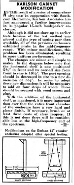

hi GM - in 1956, Karlson published an update of K15 narrowing the vent and both shelf gaps- - IIRC it had little effect on the bottom. A tight aperture gap can affect the tone. Carl experimented with a variety of apertures but did not publish response. K15 should be a lot cleaner than some horns.

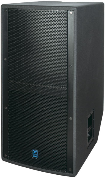

here's a 15 inch Yorkville USC1 horn I purchased new compared to a simple K the size of K15 - note the horn's H2 is over 20dB higher than the Karlson and H3 10dB higher than the Karlson. The 1-sheet K was a lot lighter too. That Yorkville cost me quite a bit - never used it again after the testing. The Karlson type was loaded with an Eminence 18 which I bought for $90 having qts ~0.26, fs ~32 mms 103g
Yorkville description http://www.fullcompass.com/product/358009.html?gclid=COzggpy-9LcCFWlo7Aod1gQABg
