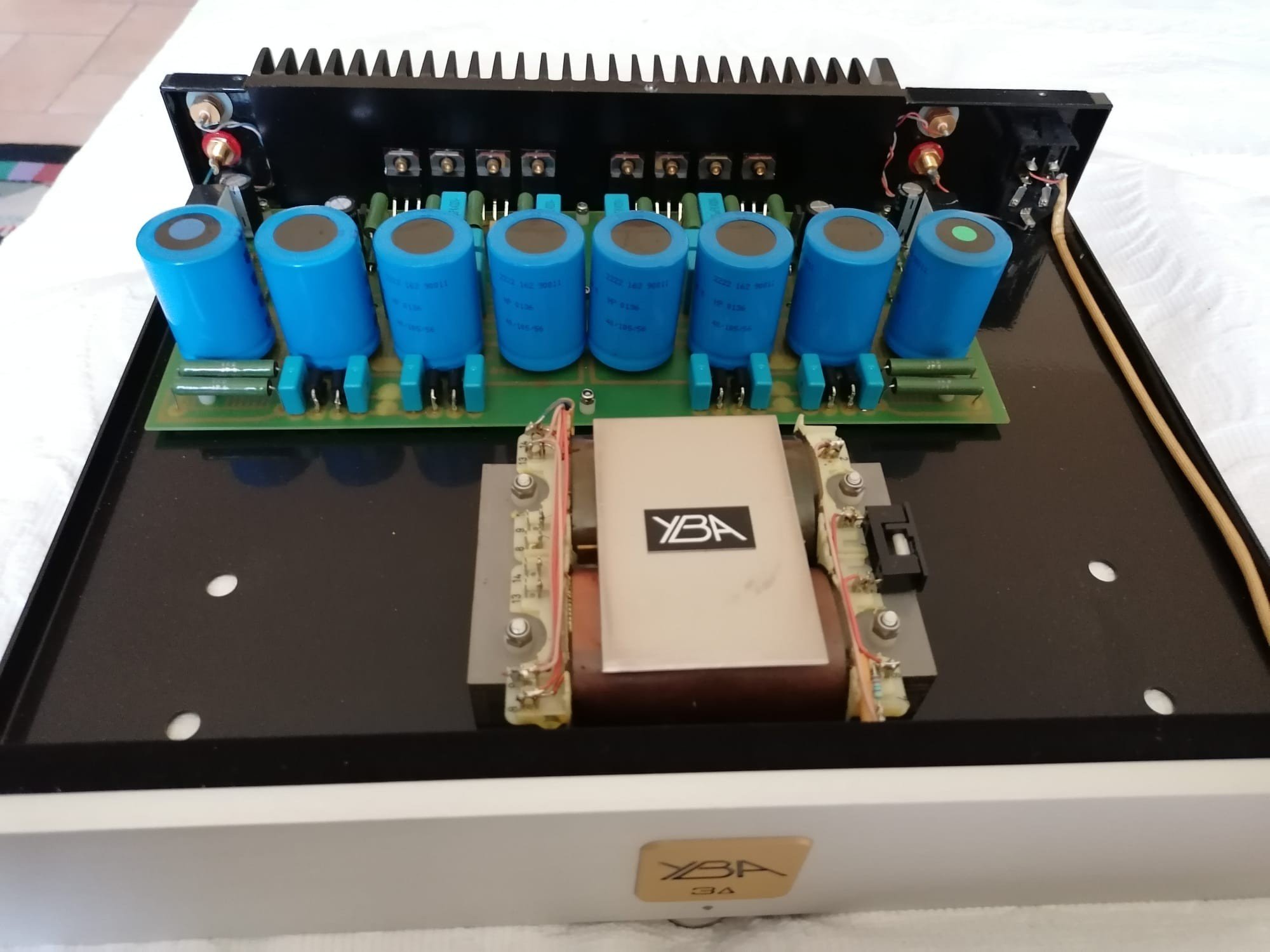

DC detection for speaker protection and output short circuit protection are two entirely different things.
DC detection can be a simple add,-on circuit, e.g. :
www.diyaudio.com/community/threads/very-simple-almost-universal-speaker-protection-circuit.415149/post-7736615
Short circuit protection would have to involve changes in the original circuit to prevent over- current.
You will need to have the original schematics first of all.

Thank you Patrick, I would never have figured it out, that's why I haven't yet found an add-on protection circuit against short circuits!
