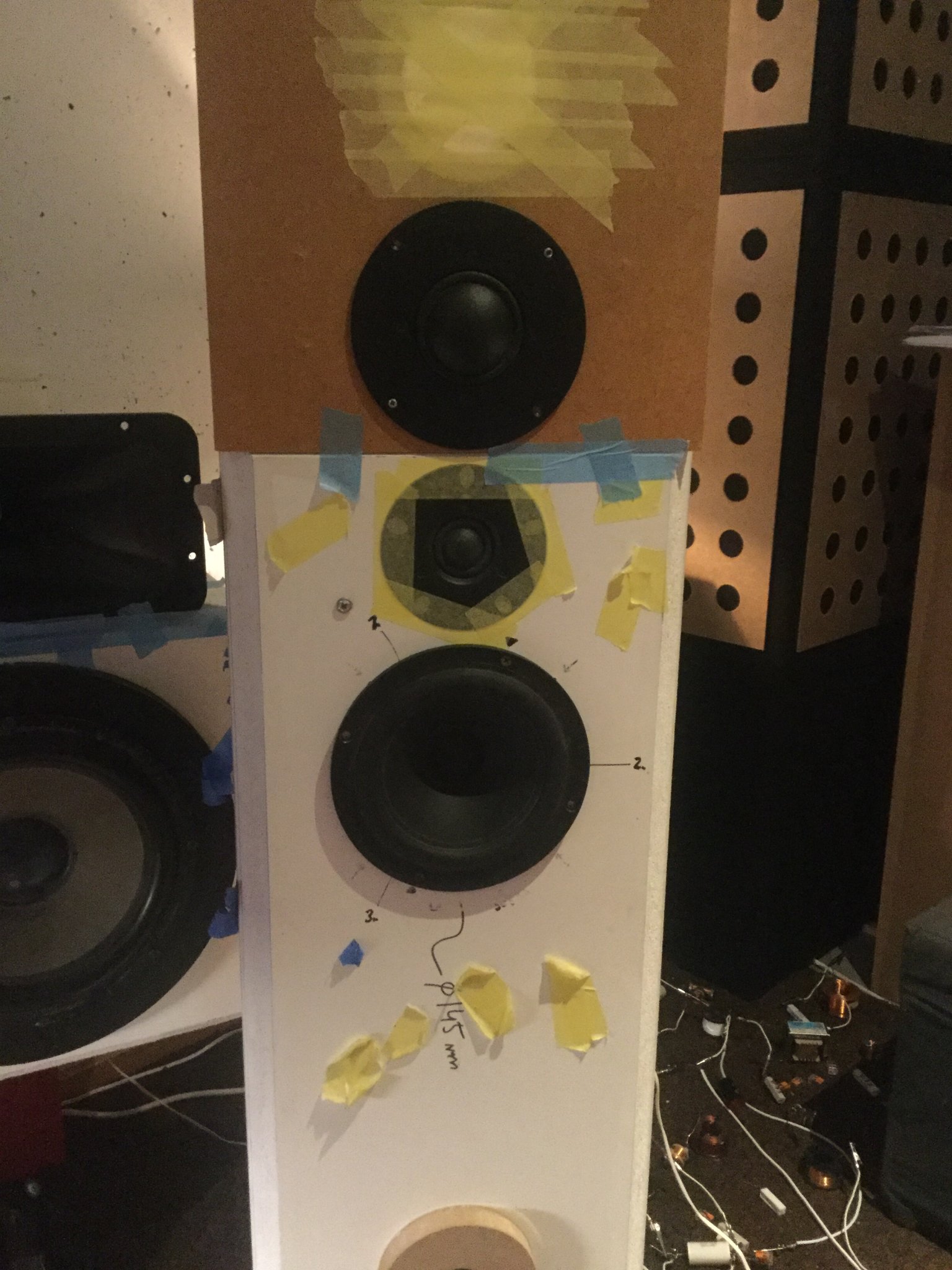

for fun i have tried to build a small 3-way, with 1” dome tweeter and 2” dome mid and 6” cone woofer, this far i am not sure it is any better then a straight 2-way using the same dome tweeter and 6” woofer, they sure sound different, by compersion the 2-way sounds edgy and bright and a bit nervous while the 3-way sounds polite and rounded and darker. The 2-way sounds more wild and fun and the 3-way sounds like an old person. Both speakers are built to measure similar both on and off axis.

There must be some measureable difference. You say they were intended to measure the same on/off, does that mean you crossed the two way rather low? Did you figure the verticals into the power you estimated/calculated?

Your claim that they measure similar but sound very different must be a mistake. Either you do not measure right, or you are measuring not relevant stuff.
For sure they do not measure identical, but i tried my very best to tune both crossovers to the same frequency responses targets both on and off axisThere must be some measureable difference. You say they were intended to measure the same on/off, does that mean you crossed the two way rather low? Did you figure the verticals into the power you estimated/calculated?

Yes the 3-way can handle higher spl without sounding stressed, the 3-way sounds more polite at all sound levels compared to the 2-way, but the 2-way sounds more energized to me, more alive, so i am wondering if this i just me or do others think the same, or does everyone think a small 3-way is always better then a 2-way?I’m curious if volume level makes a difference in your preference; for example, do you prefer the two-way at low volumes and the three-way at louder volumes? I bet the three-way has less distortion and better power handling

What (3) crossover frequencies did you use and did you measure both horizontal and vertical before and after crossing, or at least simulate the same? What baffle configurations did you use?

Other thing is resistance accross fr range. I doubt its the same. Considering significantly more complex crossover for 3way. Perhaps amp is sensitive to resistance dips.
Unless you post exact data, this is just theoretical.
