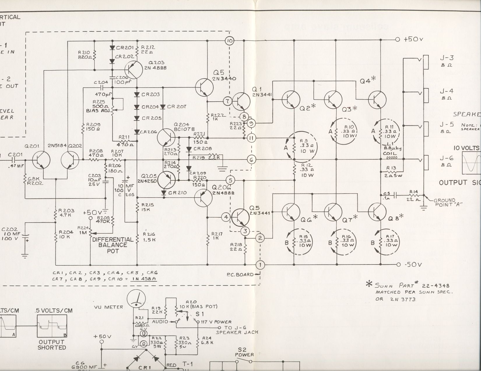

I have four old Toshiba 2N3773 transistors (along with two new Motorola’s; six total 2N3773) from a 1970-s era Sunn Coliseum Lead guitar amplifier. I also have a pair of their PNP counterparts, the 2N6609 made by ON Semiconductor (Motorola?). In addition, I have any number of old 70’s-era Marantz and Pioneer receivers from which to scavenge parts from, and two 460VA transformers from a couple of early-1990s Technics integrated amps. I am thinking, instead of tossing ways a bunch of still good parts from old equipment, I would put them to use in a new, simple, clean sounding stereo amp. Obviously I would welcome any suggestions anyone might have, or some schematics of amplifiers that use the 2N3773 and 2N6609. It needn’t be pretty, but it does have to sound good.

Was it the amplifier (include schema) from the attached jpg files?I have four old Toshiba 2N3773 transistors (along with two new Motorola’s; six total 2N3773) from a 1970-s era Sunn Coliseum Lead guitar amplifier. I also have a pair of their PNP counterparts, the 2N6609 made by ON Semiconductor (Motorola?). In addition, I have any number of old 70’s-era Marantz and Pioneer receivers from which to scavenge parts from, and two 460VA transformers from a couple of early-1990s Technics integrated amps. I am thinking, instead of tossing ways a bunch of still good parts from old equipment, I would put them to use in a new, simple, clean sounding stereo amp. Obviously I would welcome any suggestions anyone might have, or some schematics of amplifiers that use the 2N3773 and 2N6609. It needn’t be pretty, but it does have to sound good.
about
http://www.diyaudio.com/forums/soli...-models-quasi-complementary-power-output.html
you will find more schematics from vintage commercial products, also suited for the 2N3773.
